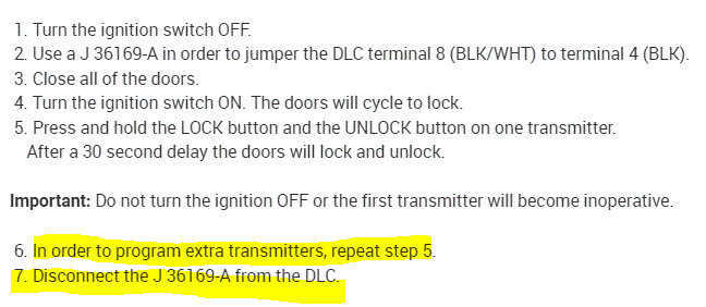

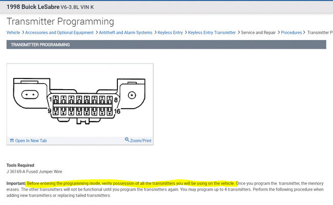

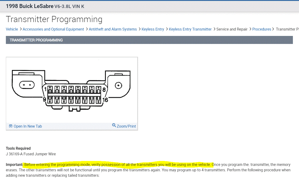

It's Joe again. LOL Listen let's try to reprogram the fob first. I attached the directions below. If you have more than one fob to program, make sure to follow the directions at the end of the list.

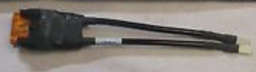

To do this, you will need a short jumper wire that is to be fused. It's GM part number J 36169-A. See pic 1 below to get an idea of what it looks like.
The last two pics are the directions.

Thanks, Joe! I'll order the J36169-A, as you suggest, and give it a try.
What puzzles me is the fob-detect circuit seemed to work for a while, after we put a resistor on the ignition switch line to the PCM. Then, it began to wander in performance, so I suspected the fob button battery until my VOM showed the battery was over 3.x volts.
How did the detect circuit and/or fob fall away from specifications?

Forgot to ask, what is the fuse electrical value, if it has a value? Fuses are set to sustain current to a certain Ma range, as I recall.
Dec 7, 2021 at 12:01 PM
  • 110,248 POSTS
That is a standard bypass for GM. Did you try it?
As far as the fuse, the pic shows an orange one which should be 40amp. However, I feel that is too much. I would suggest something like 5 amp for this.

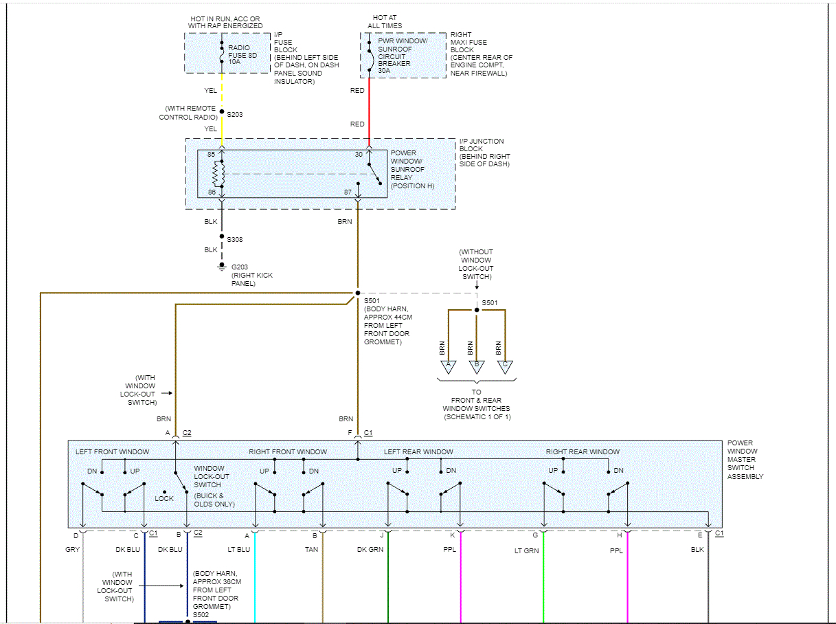

Fortunately, I noticed the motor switch for the windows produced no response, not even a buzz. This persuades me that the engine startup failure happened when a large amperage relay fused and shut the starter circuit down. Why GM put the window motor on the starter circuit, I have no idea. But everything else on the car seems normal

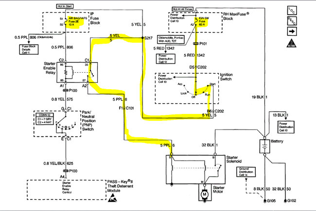

Since I don't have the wiring schematics, could you tell me what fuse I should examine first?
Jun 7, 2022 at 9:34 PM
  • 110,248 POSTS
I'm not sure which circuit you need. I attached the schematic below and highlighted two fuses related to the starter circuit.
Let me know if that is what you need. However, if the starter is engaging, it won't be a fuse.
Take care and I'll watch for your reply.
See pic below.

The schematic shows fuse 2E in the fuse block runs to the starter enable relay on schematic left side and to the ignition switch at schematic center (I mention schematic position only to show I follow).
There are two fuses along the way--
1. Fuse block fuse 2E is 10A, but since the starter engages, that fuse and the starter relay are okay.
2. Fuse block main yellow wire branches at S217 and the right branch enters the ignition switch, and a red wire emerges, running to the MaxiFuse block, to fuse A2 60A.
Okay, so far? If so, that means I have no issue on the starter side, but the ignition switch and its MaxiFuse could be suspect.

You are correct. I also don't think it's the switch. I could be wrong, but that would have set a code. Also, looking at the wiring schematic for the power windows, it doesn't tie in. I attached the schematic below for your review.
Have you confirmed spark to the plugs? Will it start if you use starting fluid and then stall?

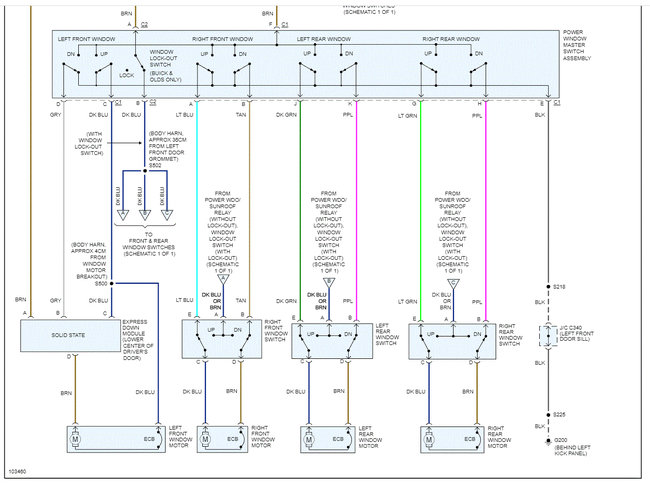

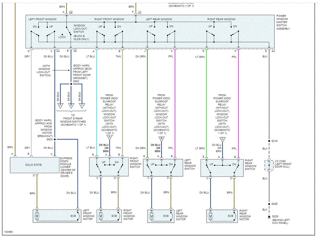

Joe, could you re-attach the power window schematic? It never arrived. When you said it was attached, but since I had gotten no other, I thought you meant the schematic you already had sent to me.
At this point, it puzzles me the power windows switch ceased operation when the motor would not start, yet the schematic shows them unrelated.

To use starting fluid on this vehicle, it is sprayed into the throttle body. And yes, to the spark plugs. Here is a link that explains how to do it:
https://www.2carpros.com/articles/how-to-check-for-ignition-spark
I reattached the power window schematic below. Note that I had to cut the page in half to make it readable for you. I overlapped the two pics so you can follow from one to the next.
Let me know if this helps.

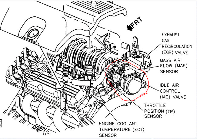

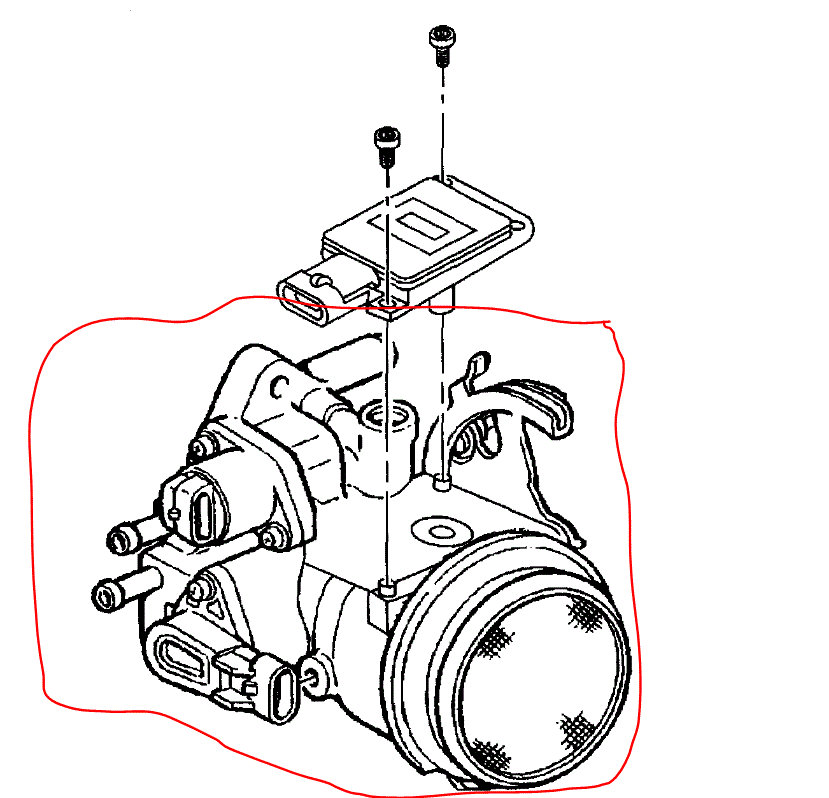

Yes, I agree. I don't see them causing a no-start. By chance, did you try the starting fluid trick to see if it starts? You mentioned not knowing where the throttle body is located.
From the air filter box, follow the air induction tube to the engine. (Large tube). It mounts to the front of the throttle body. Remove it and have someone press the throttle to the floor, spray starting fluid in it (a small amount), release the throttle, and see if it starts.
I attached two pics of the throttle body below. Try this. I read back through the last few posts from you and noted running it low on fuel several times. The pump may be bad, and this will help us determine it.

2. Starting fluid test-- Even before receiving your message (thank you!), I had located the air filter and its large hose clamp, which I was able to loosen enough to permit a full jet of starter fluid. As you advised, I should have somebody floor the accelerator pedal during start to open the throttle to the starter fluid. For better understanding, exactly what will a successful start and brief run with starting fluid indicate? The fuel pump remains suspect-- doesn't the starting fluid operation simply bypass the fuel pump? If so, how to test the fuel pump itself?
