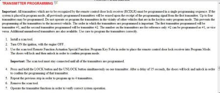

the keyless remotes were lost and I purchased replacements. I cannot find the instructions to program them to the car. Thank you

Hi Tim, Here is the procceedure but, unless you have a Scan Tool that can access and activate the program mode I'm afraid it won't help. And you would need to take to a shop to have it done.
https://images.2carpros.com/forum/automotive_pictures/188069_03lesabrkeyfob_1.jpg
