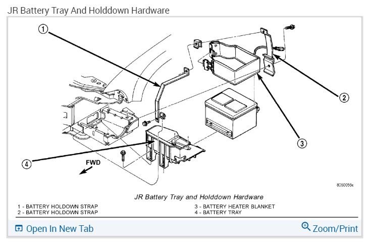

Already change the transmission control module, clean all the grounds. my battery light still on. And the car shut off going around the block. the only thing I haven't changed is the PCM or ECM. any suggestions on something else that might be helpful?

hello, is this car equipped with a battery temperature sensor. located under the battery? Heres the resistance test: Disconnect the heater blanket from the vehicles electrical system. Using an Ohmmeter, connect the leads across the two wire terminals coming from the heater blanket. A resistance value of 220 to 280 ohms should be present. If not replace the blanket. And is there any diagnostic trouble codes stored? The light is turned on by a PCI BUS circuit, with the voltage regulator built into the ECM.
