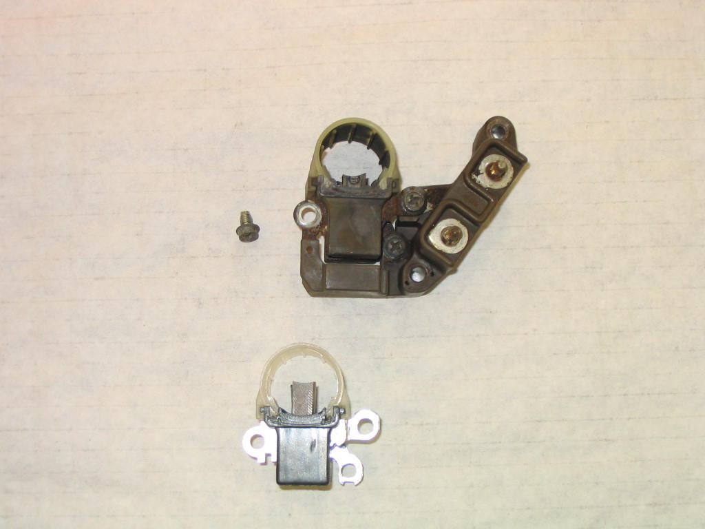

After car runs for 5-10 mins, battery light comes on and stays on. Stop car and restart, light stays off for 5-10 mins and comes on again. Battery replaced last month. Had All-Parts Automotive do the system test. When the light was off, they said alternator was fine and battery fine but low charge. I drove 10 mins, light came on, I had them test with light on. Test said battery was bad. Stopped car, had them restest and it says battery is ok. Battery connections seem tight and look ok. Car is a 1997 Sebring convertible. Any idea what the problem is?

CARADIODOC
  • 33,916 POSTS
Yup. REAL common problem. The brushes are worn and making intermittent contact. The testing has to be done while the problem is occurring. During their test, they caught it while it was working.
If you can find the parts, you might be able to replace the brush assembly without removing the alternator from the engine, at least that could be done on the older stuff that I drive. I've done this many times on cars I put "bugs" in for my students to troubleshoot.
Here's a photo of what the assembly looks like. You don't have to remove the terminal block as I did in the photo, just the three screws.

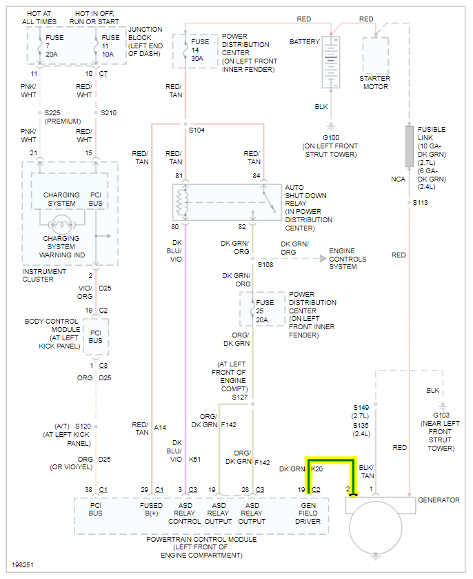

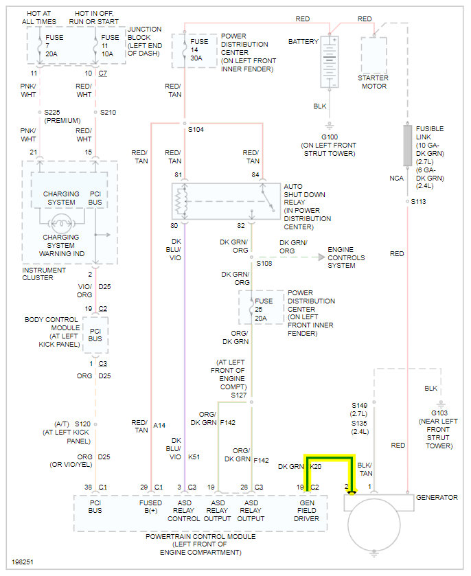

Brand new battery, new alternator, and brand new re-manufacture ECM. ECM was corrupt I cleaned all the grounds to the chassis and cleared faulty codes. Only codes available was for heater control circuit and EGR. Any help with ambient air temperature location? I'm scratching my head on this one. Any experience with this issue would be greatly appreciated and helpful. I did clean all the grounds. And 3 weeks into this one, thanks in advance for your help.
Sunday, October 25th, 2020 AT 11:30 AM (Merged)
More then likely you have an issue on the generator field control wire. Either a connector issue or the wire itself has a short or high resistance. I highlighted here in the wiring diagram.
We need to check for a short and measure resistance from end to end. Basically this is the wire that the PCM uses to control the generator.
We can confirm the generator is causing the light to come on if you check the voltage across the battery when the engine is running. There should be around 14 volts. If not then the light is coming on properly telling you the voltage is low.
Let me know what you find. Thanks
