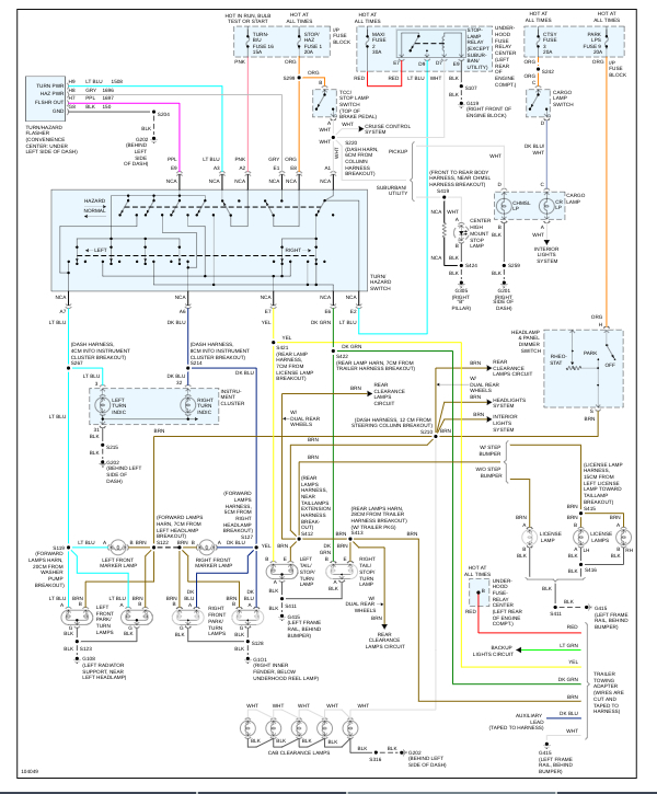

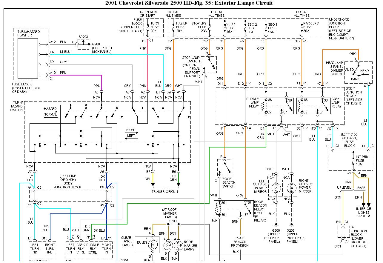

Here is a schematic of the exterior lights.
Check the Orange wire at brake switch, on top of brake pedal for battery voltage. If voltage is available, use a jumper wire to bridge the Orange and White wire. If brake lights come on, the switch is bad or out of adjustment.

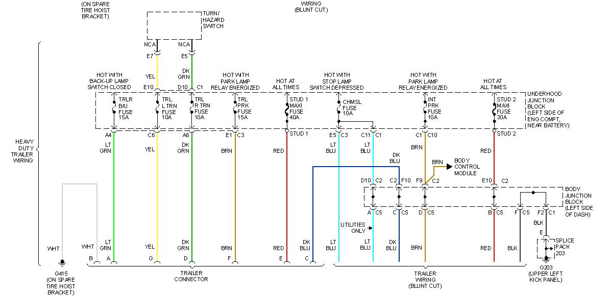

The truck has functioning lights, when I plug in 7pin harness to my trailer I have running lights, turning signals, backup lights, power to my electric brakes but no stop lights on trailer> Please help Jeff
Friday, February 26th, 2021 AT 10:11 AM (Merged)
KHLOW2008
  • 41,814 POSTS
Do you mean only the trailer stop lights are not working?
Are the brake lights on vehicle body working correctly?
The CHMSL fuse (10A) is for the brake lights. If battery voltage is not available athe trailer connector, check the CHMSL fuse. Use a test lamp to test both ends of the fuse. If voltage is available and none found at trailer connector (Light Blue wire), you have an open circuit between the fuse and trailer connector.
JBIGELOW007
  • 5 POSTS
Thank you KHLow2008 will try to test that circuit (fuse is good)will advise thanks again. Jeff

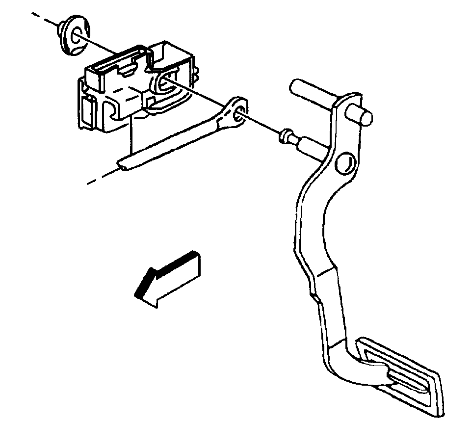

My brake lights work after 8:00 am and stay on at night, the four wheel drive does not work if the brake lights will not turn off. I am thinking it may be the sensor for the automatic lights on/off function. Any ideas?
  • 109,885 POSTS
Hi and thanks for using 2CarPros. Com.
It sounds like you have a bad brake light switch. Have you checked it? It is located at the top of the brake pedal. Here are the directions for removal and replacement if you find it is bad. The attached picture shows the switch and correlates with these directions.
CAUTION: Refer to Battery Disconnect Caution in Service Precautions.
1. Disconnect the negative battery cable.
2. Disable the SIR.
3. Remove the pushrod retainer from the brake pedal pin. Use snap ring pliers.
4. Unsnap the stoplamp switch from the pushrod.
5. Disconnect the electrical connector from the stoplamp switch.
INSTALLATION PROCEDURE
1. Connect the electrical connector to the stoplamp switch.
2. Snap the stoplamp switch onto the pushrod.
3. Install a new pushrod retainer on the brake pedal pin. Use an 11 mm (7/16 inch) socket in order to push a new clip onto the pin.
4. Connect the negative battery cable.
5. Enable the SIR.
Let me know if this helps.

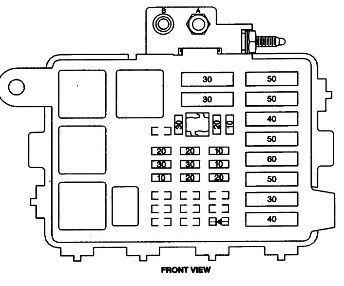

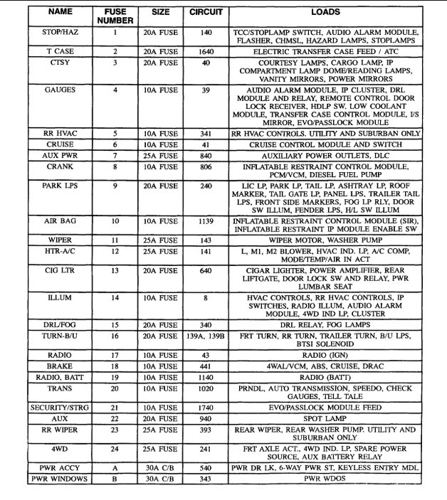

On my pickup, I have no Brake lights or taillights, they seem to work sometimes but are very dim. I was told to try a new circut boards at the tail light assembly, ive tried new bulbs, checked connection under truck and checked ground but cannot figure it out?
Friday, February 26th, 2021 AT 10:12 AM (Merged)

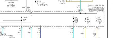

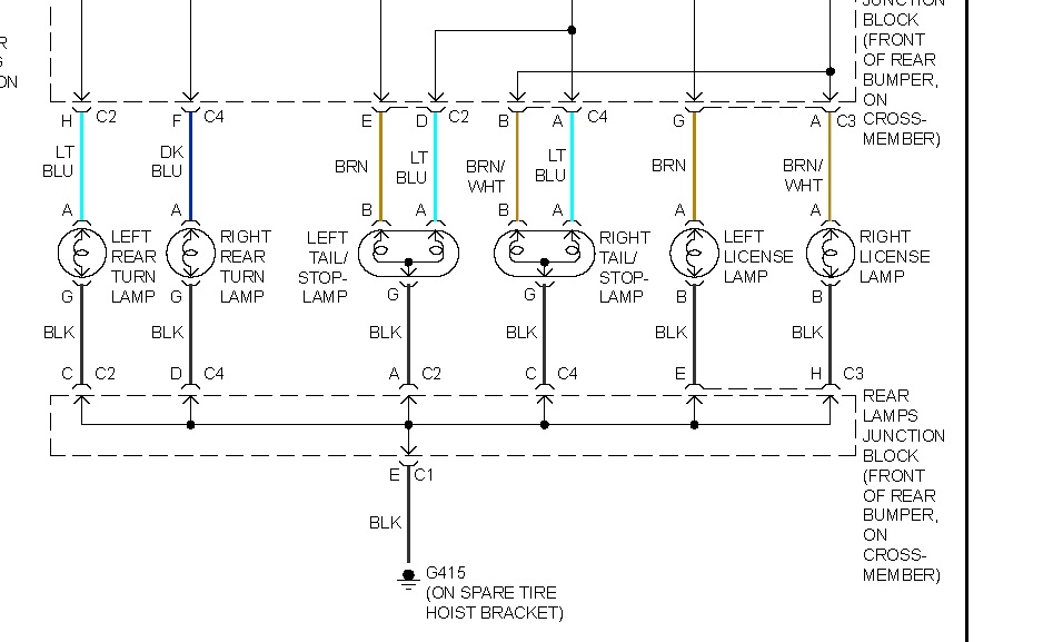

JDL
  • 16,098 POSTS
Check the fuses in the diagram, check the actual voltage readings. This is for brake lites. The stop lamp fuse and center high-mount fuse, underhood fuse block. With the brake switch activated, the voltage should be close to battery voltage. Yes, it does sound like it could be a grounD problem?
this guide will help
https://www.2carpros.com/articles/brake-lights-not-working
https://www.2carpros.com/forum/automotive_pictures/170934_silverado_ground_1.jpg
https://www.2carpros.com/forum/automotive_pictures/170934_silverado_brake_lites_1.jpg

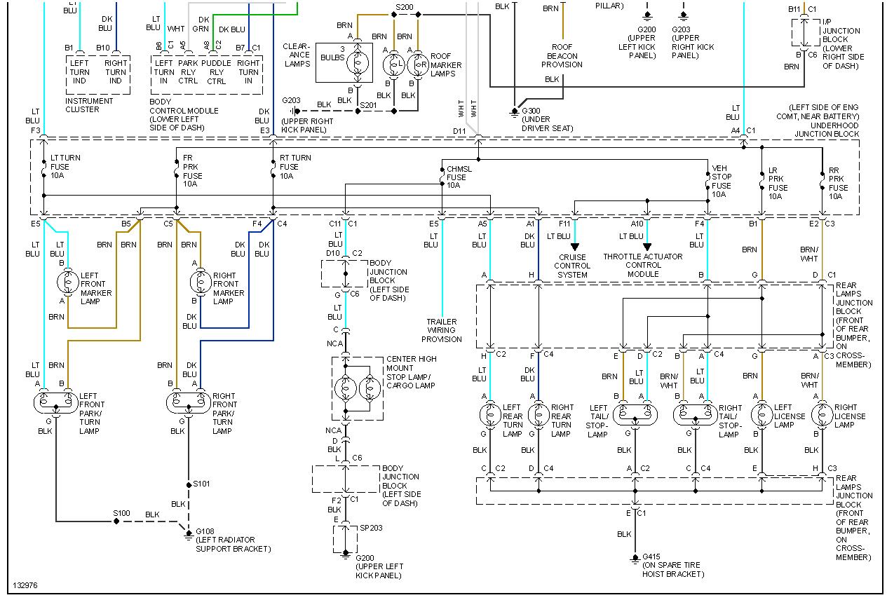

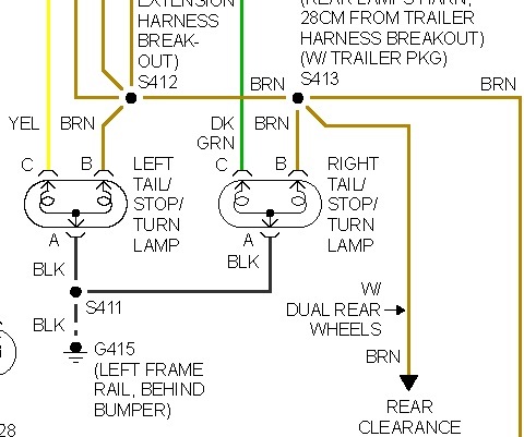

No brake lights on 1997 Chevy Silverado. I have changed the brake switch, brake light relay, the bulbs, and the tail light assembly. Also checked the fuses. The turn signals, tail lights, hazards all work but still NO brake lights.
Friday, February 26th, 2021 AT 10:16 AM (Merged)
JDL
  • 16,098 POSTS
Does the highmount brake lite work? Did you check for voltage going to the brake switch, orange. The lower brake lites are wired through the multifunction switch. At the lower rear, the brake lites and turn signals use the same bulb filament, just not at the same time. Check voltage and ground at the rear.
In the diagram, the brown wire is voltage for tail lamps, the other color wires are for stop/turn. The black wire is ground.
