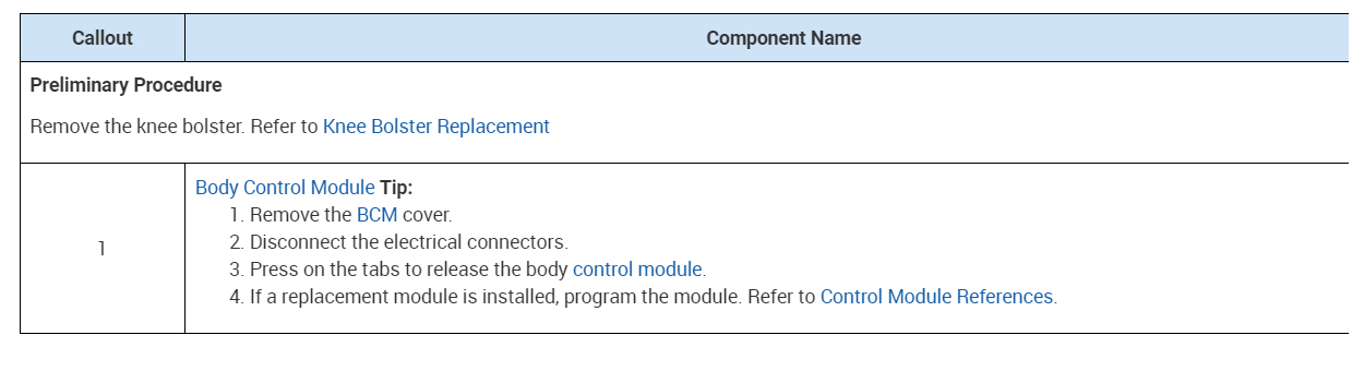

My Brake Light has stopped working on my 2014 Silverado. I have a truck topper installed and the center brake light is out on it as well. I checked the CHMSL fuse and it is fine. Any ideas?
Oct 24, 2015 at 4:48 PM
RIVERMIKERAT
  • 6,110 POSTS

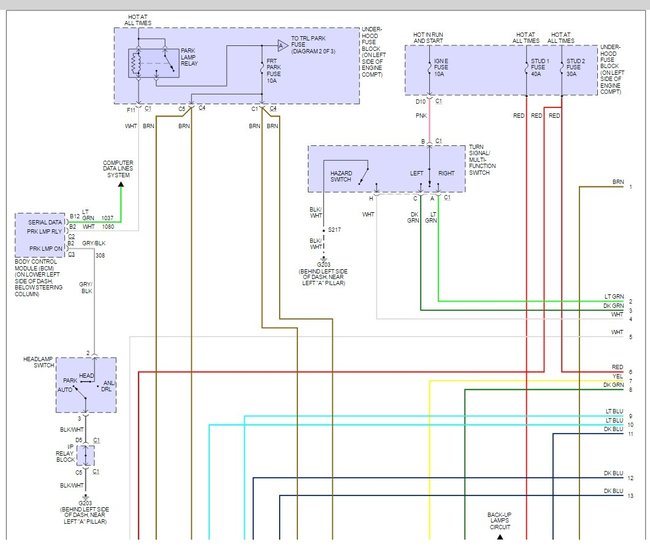

There are many fuses that run the system which need to be checked because the lighting systems are run by the BCM, here is a guide to help and I have included the fuse location as well. If all fuses are good I would check the ground (g400) for the bulb socket. Here is the blinker and brake light wiring diagrams so you can see which fuses to check plus a guide to help check the ground.
and
If the fuses and grounds are good the BCM could be out but to be sure lets do a CAN scan, you can get a CAN scanner (Controller Area Network) which will work on most cars from Amazon here is a video to show you how.
https://youtu.be/u-4syLc-ifQ
If it comes up with e code for the bcm you can get a preprogrammed unit by searching Google or Ebay. Here is how to change out the BCM as well. Check out the images (Below). Please let us know what happens.

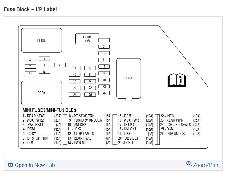

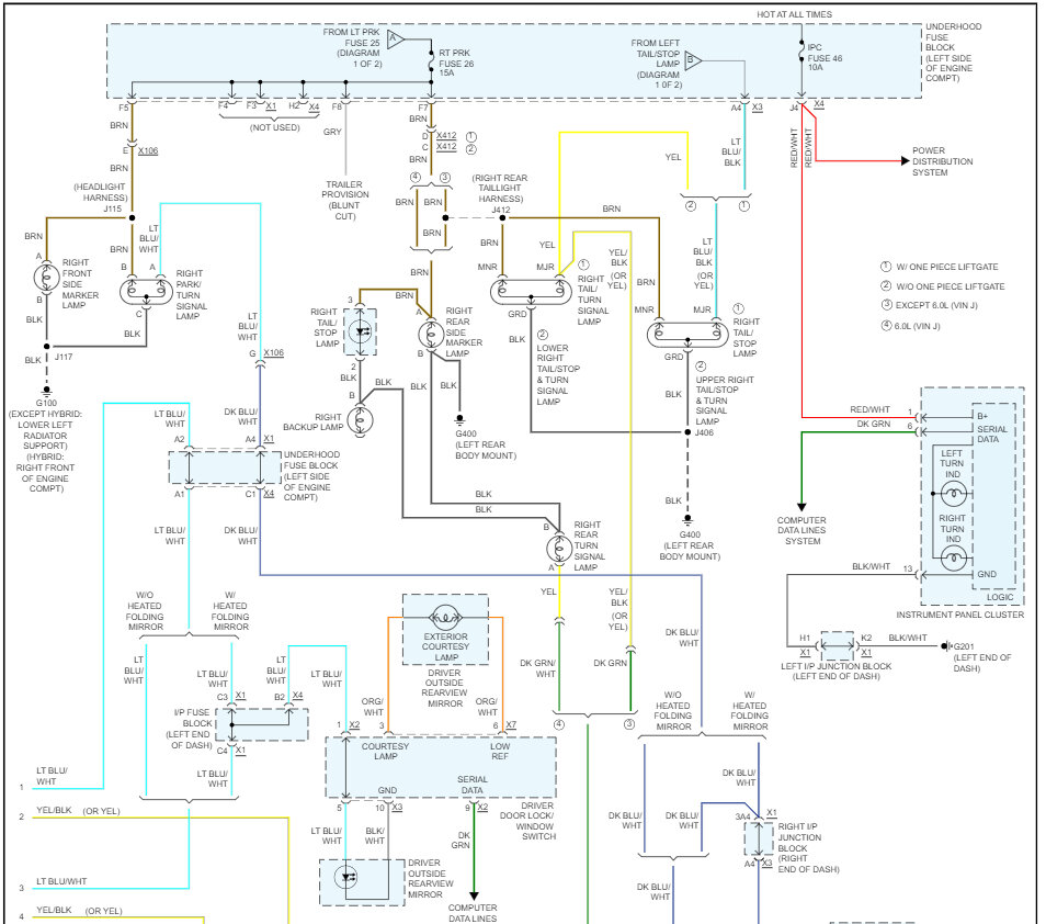

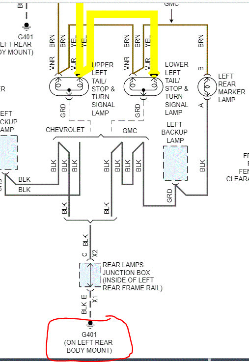

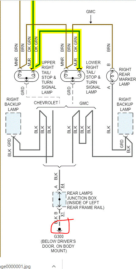

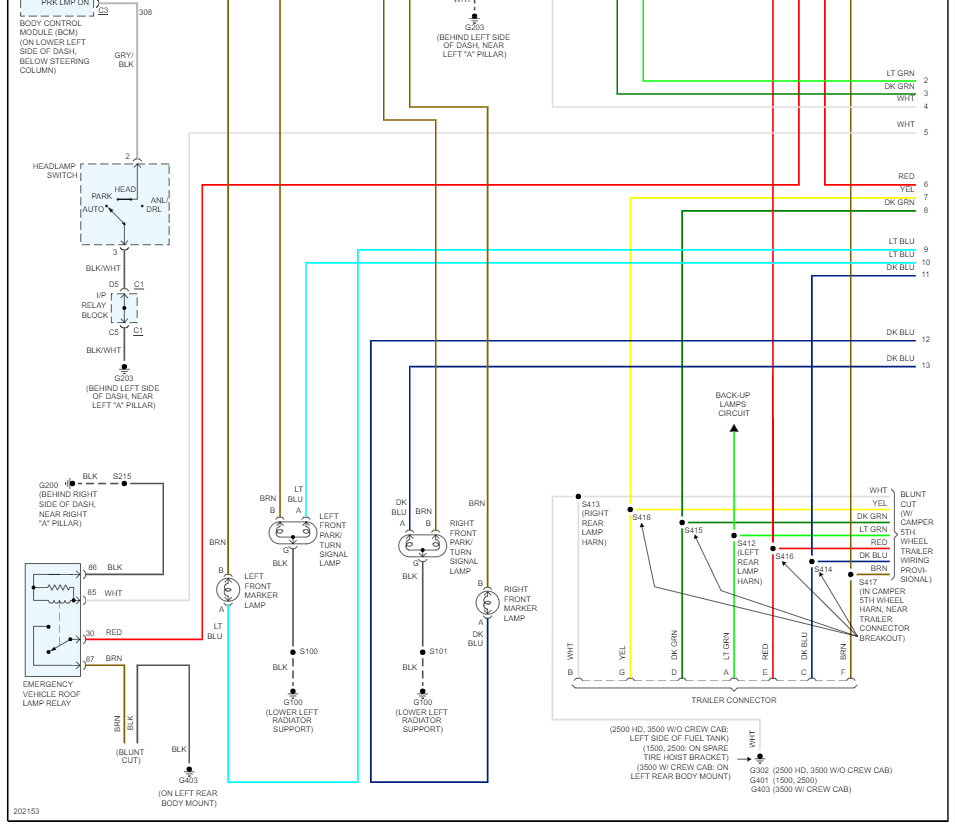

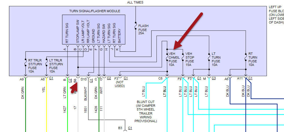

Do the back up lights work? Also, if you disconnect the trailer from the truck, does it make a difference?

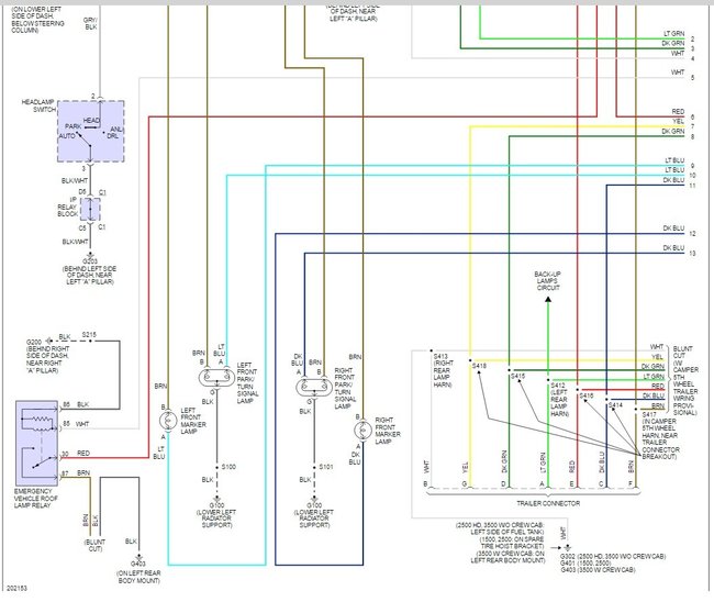

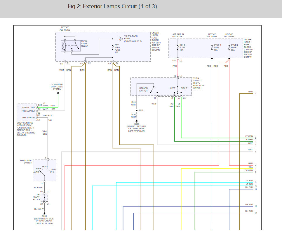

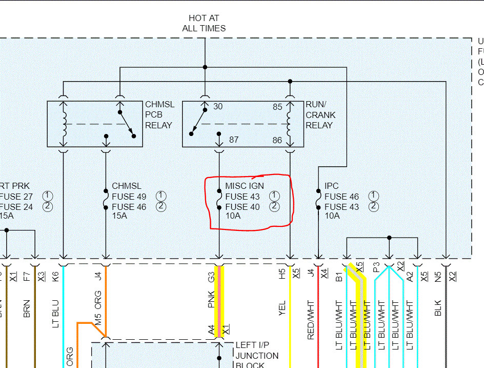

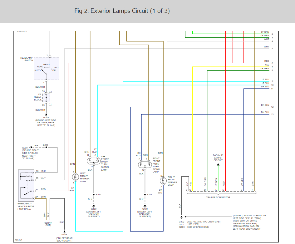

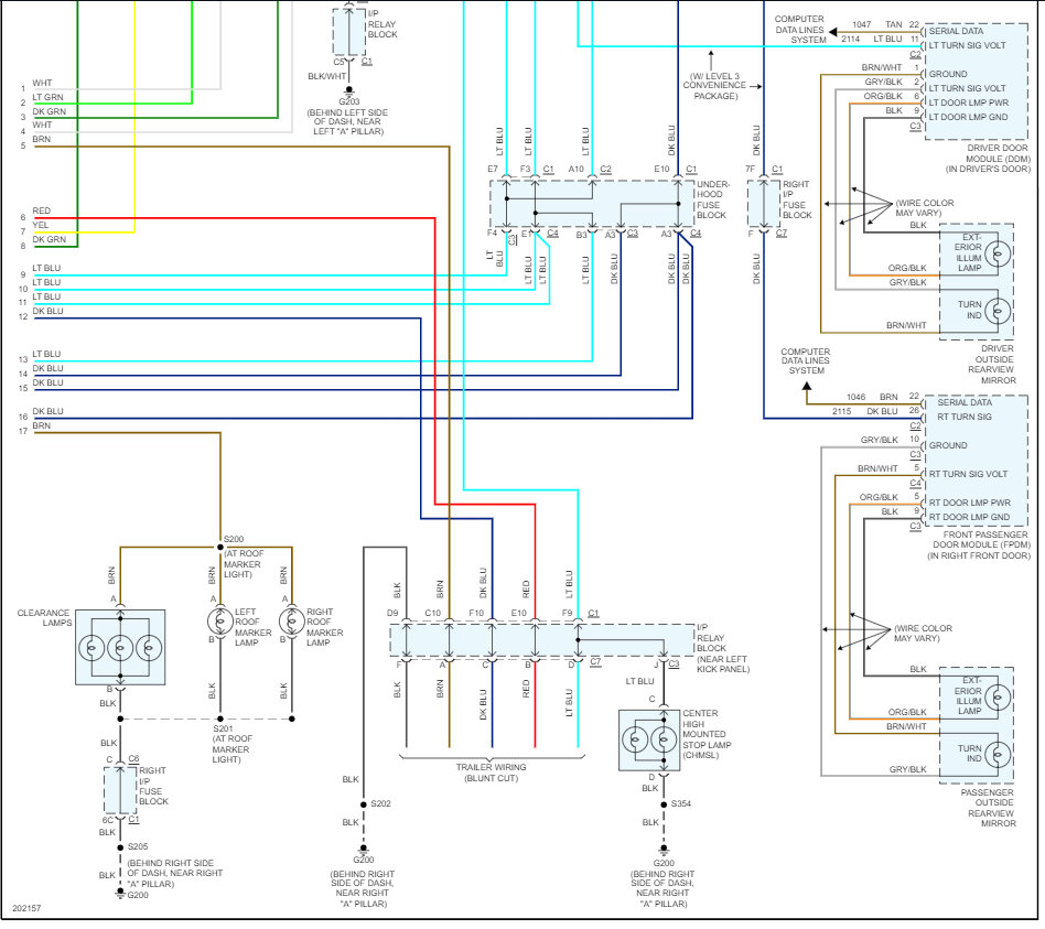

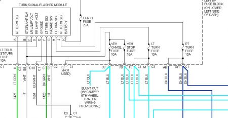

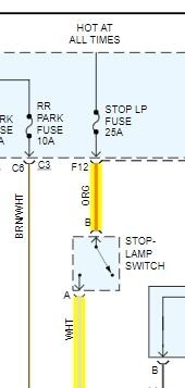

Since the third brake light is working, we know it isn't the switch. Do me a favor. Check the fuse I circled in pic 1.

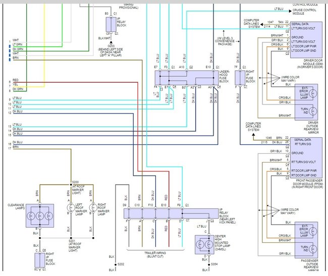

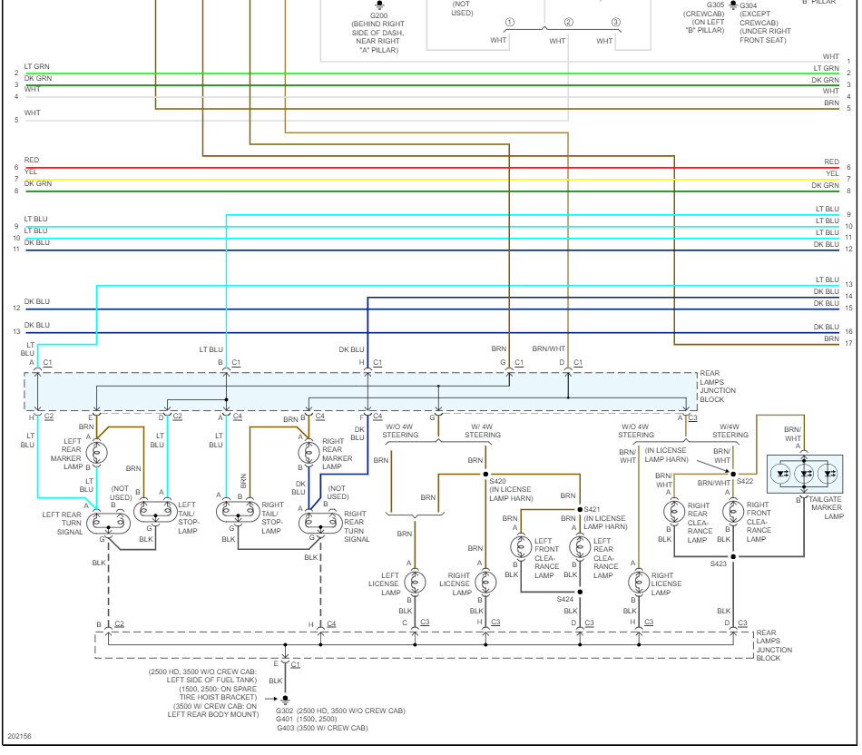

If the fuse is good, check for power to the dark green wire in pic 2 and confirm continuity to ground as well. In pic 3, check for power to the yellow wire and for continuity to ground.
Let me know what you find. Also, let me know if any of the other tail lights are working.

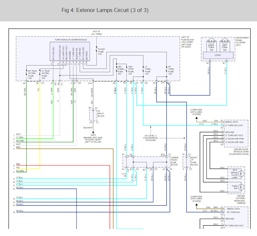

The brakes lights on my truck will not work when i press my brakes. The tail lights work on the top but the bottom tail lights does not work. The third brake light works, located at the top above the rear glass. I tried checking the fuse under the hood and on side of the door. all seem to be good, I even changed the brake terminal under the brake pedal. The brake light bulbs r good, Cant figure it out.
Feb 25, 2021 at 5:49 PM (Merged)
  • 75,992 POSTS

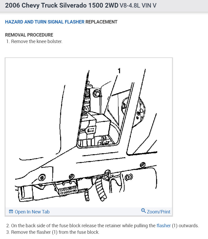

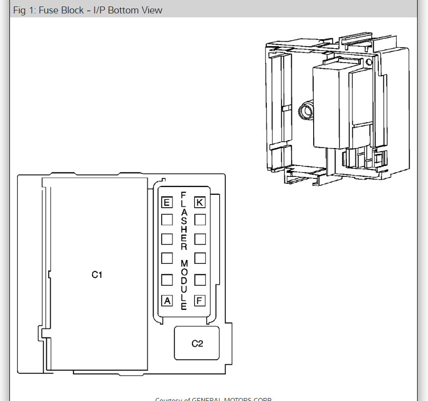

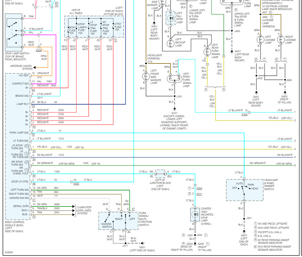

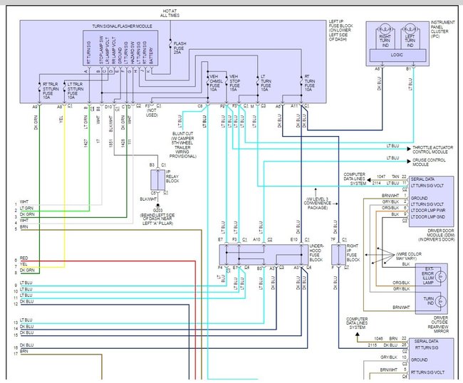

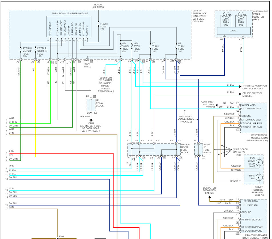

Test or replace the turn signal and flasher module all the brake and tail circuits going to the back goes thru here

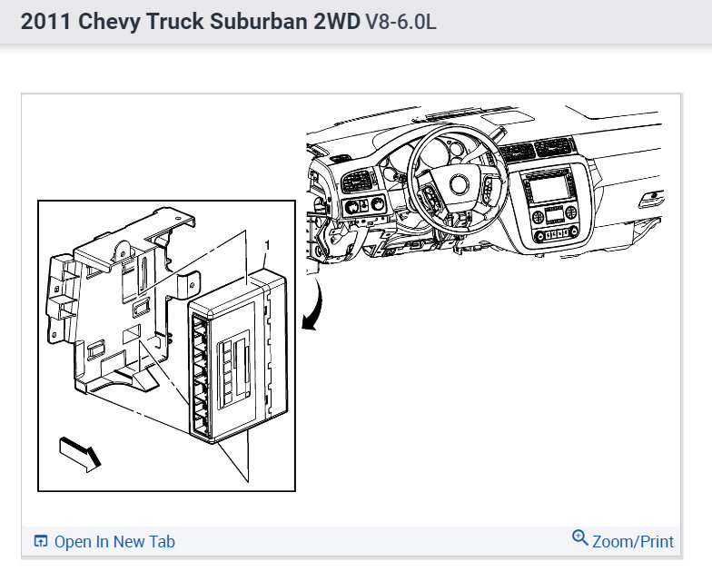

CLAUDEL0007
where are the turn signal and flasher module located.
  • 75,992 POSTS
Its in left of instrument panel fuse block on lower left side of dash. Check out the diagrams (Below). Please let us know what you find.
CLAUDEL0007
ok, that fixed it thanks for your help. I like this site

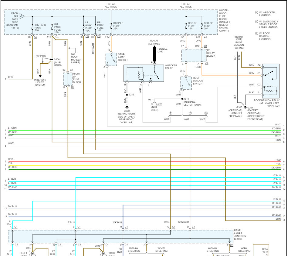

There is a fuse that runs just the lower brake lights, here is a guide and some wiring diagrams to help you trace the problem down. Check to see if there is power at the brake lights to see if the problem is a ground issue. Check the brake light wiring diagrams below so you can see how the system works.
and
https://www.2carpros.com/articles/brake-lights-not-working
Check out the diagrams (Below). Please let us know what you find. We are interested to see what it is.

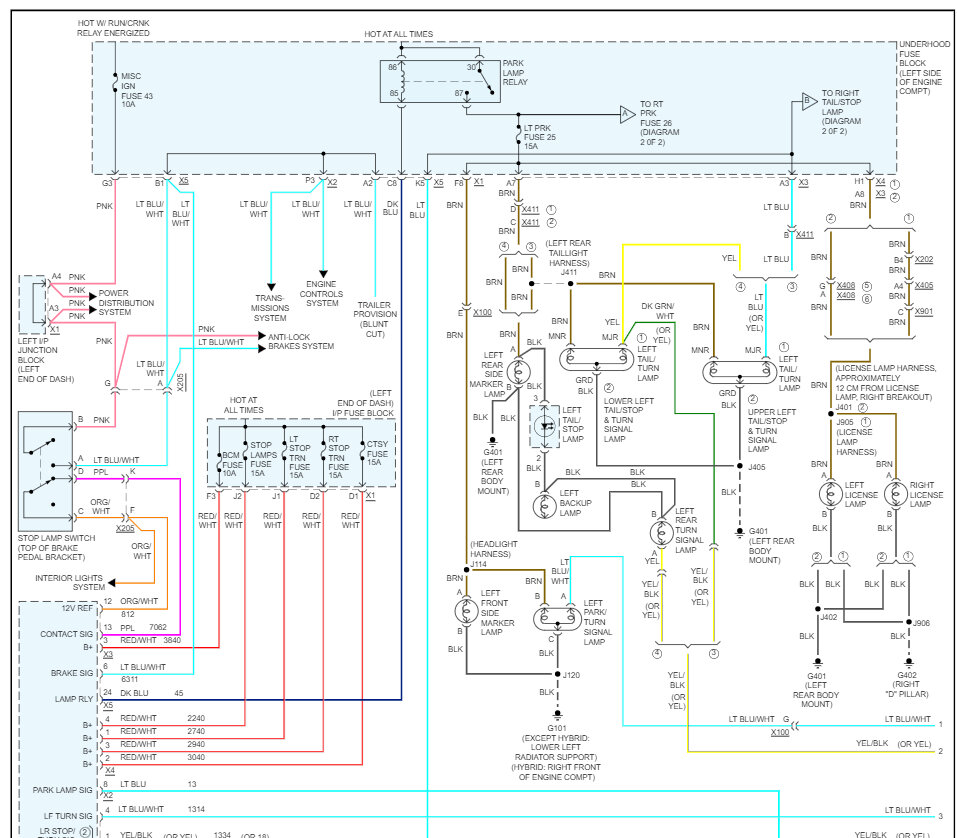

Hi everyone..
Here is a new twist.. I have a 2004 silverado with no brake lights or 3rd light.. I have power at the underhood fuse and at the orange and when pedal depressed power in white wire.. However i have no power in 15 amp dash fuse.. What do you suggest?
Jim walker
  • 54,832 POSTS

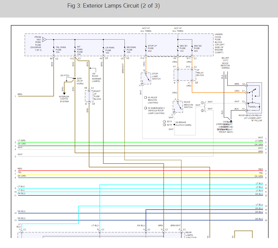

What number is the fuse? here are wiring diagrams so you can see how it works with the flasher module location which sounds like it is out. Check out the diagrams (Below). Please let us know what you find. We are interested to see what it is.

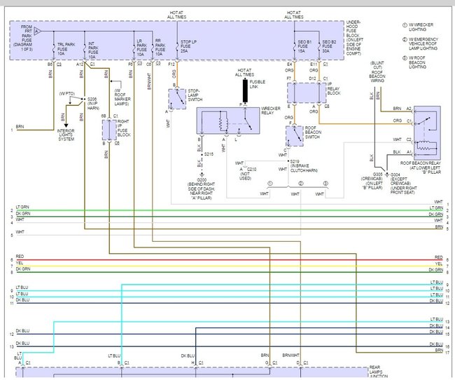

The Brake lights on the bed dont work, also the trailer connection isnt working. My third brake light works though) I replaced the bulbs in the tail light assembly. and checked the old bulbs but they work fine. I checked the fuses under the hood and in the dash. Dash-good. Underhood-bad. So I replaced the one under the hood. The one in the dash says "VEH STOP" and the one under the hood says "TRL PARK" (the new one hasnt blown) ok,Thinking I had the problem fixed ! but nope! I came on this site and found a trouble shooting guide step by step. Ok thought I had it now. I followed each step and found I had power to both fuses, the brake light switch(on the orange, and the white) I have power all the way through the check list till the last step. When I check I have no voltage coming through the light Blue wire at the tail light. I crawled under the truck and followed the harness back all the way to underneath the cab. I peeled back the plastic protective sleeve, and fanned out the wires. I stripped off a tiny piece of the jacket on that light blue wire, and checked the voltage. ( with the brake off, and with it depressed- nothing. any help would be greatly appreciated ! I fear it is a bad wiring harness, But like I mentioned, I have parking lights, back up lights, turn signals, just no brake lights.
Feb 25, 2021 at 5:50 PM (Merged)
INTERNETMECHANIC
  • 700 POSTS

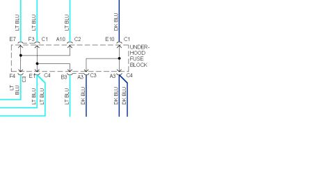

I couldn't do any better than your doing, I'd have to backtrack the circuit. There appears to be a junction for the fuse circuit at the underhood fuse box. Lite blue wire, E7 in the diagram. That circuit comes from the stop fuse.

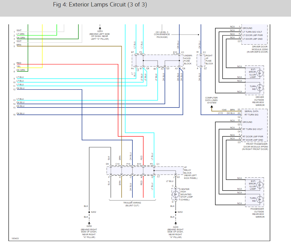

I had a similar problem with a 96 Silverado with a fiberglass topper. Problem I found was a bad ground that someone had done when they wired up the third brake light and interior dome light on the topper. I found the bad ground on the rear frame rail where the topper installer decided to terminate it.
I'd look underneath the box for some non-factory wiring, and check and clean the termination points.

The brake lights on the bed are not working. However the brake light on the cab is working. I replaced the bulbs and I checked the fuses, but that was not it. Please help me figure out what to do?
Feb 25, 2021 at 5:51 PM (Merged)
JAMES W.
  • 2,394 POSTS
First question I always ask is; do you have a trailer connector spliced in behind the bumper? 75% of the time, that's where the problem is. Please advise.
JSCHEVY
I believe I have one but it is factory installed. Does that make a difference? And, what in particular would be the problem there, a short or is there a fuse there?
JAMES W.
  • 2,394 POSTS
You will want to test your trailer connector to see if you have brake lights there. You're looking for an "open" in the circuit somewhere. The brake light switch has to be functioning or the cab light wouldn't be working. Please look at the wiring diagrams below. Check out the images (Below). Please let us know what happens.
JSCHEVY
I tested the harnesses that adjoin on the connection block. I get main power coming in. However, when I test the brake connections, no power. I have power to my tail lights, blinkers and all, which look to be coming from that block as well. A parts guy said that usually those blocks go out on one full side, which sounds to me like if it was the block then I would have either the right or the lefts side lights out. You said that it could be an open, but I don't know where to test it to find out, because I am not getting power to my brake lights from that block. What suggestions do you have?
JAMES W.
  • 2,394 POSTS

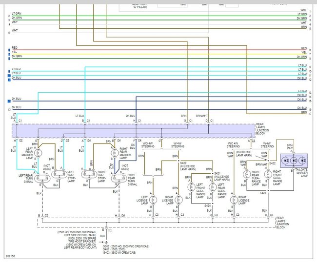

You're right, the chances of both sides going bad are poor to none. Let's start from square 1. We'll be testing at the socket for the "turn signal flasher module", under the left side of the dash. The brake lights go through this module. The brake lights are fused seperately from a 25amp fuse(# unknown) in the underhood fuse block. This fuse should be hot all the time. Fuse good, yes, test the orange wire at brake light switch. Orange hot, yes, push the brake pedal and test the white wire on the BL switch. White hot, yes? Test the white wire at the flasher module, terminal B, with brake pedal pressed. Hot, yes?, check fuse #9 in fuse block by flasher module. Fuse good?, yes, check the junctions and connections on the light blue wires going back to the brake light lamps. Fuse #9 should be hot when the brake pedal is pressed.Let me know what you find.
https://images.2carpros.com/forum/automotive_pictures/248092_05_silverado_flasher_1.jpg

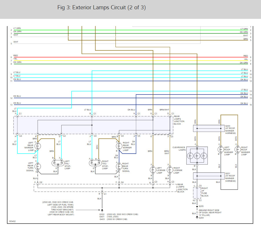

ROBERT GLENN FRANCIS
Well It's now the end of April 2016 and my chevy silverado 3500 has a similar issue. everything works except the bed lamps for the brakes. I hooked up the boat trailer and all checks out perfect. It's the twighlight zone issue. I can not find fuse #9 because the label on the lid does not show numbers for the fuses. I wish I could understand the schematics better but my studied discipline is in another field I can only get close at best. Any help would be most appreciated.

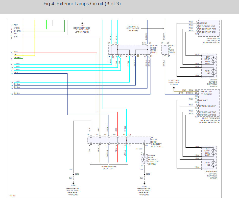

You have already done a lot. I have to ask, is there power to the switch at all times? If you take a look at the section of the wiring schematic I attached, you will see power comes from a 25 amp fuse in the under hood fuse box. It then travels to the switch via an orange wire. I need to know if there is power at the switch. Also, I need to know if the turn signals are working properly.
I've noted you indicate little knowledge. Here are a few links that will help you with checking for power, checking the fuse and power to the fuse and so on:
and
If you find there is power to the switch from the orange wire, actuate the switch and check of power makes it through the switch and into the white wire.
