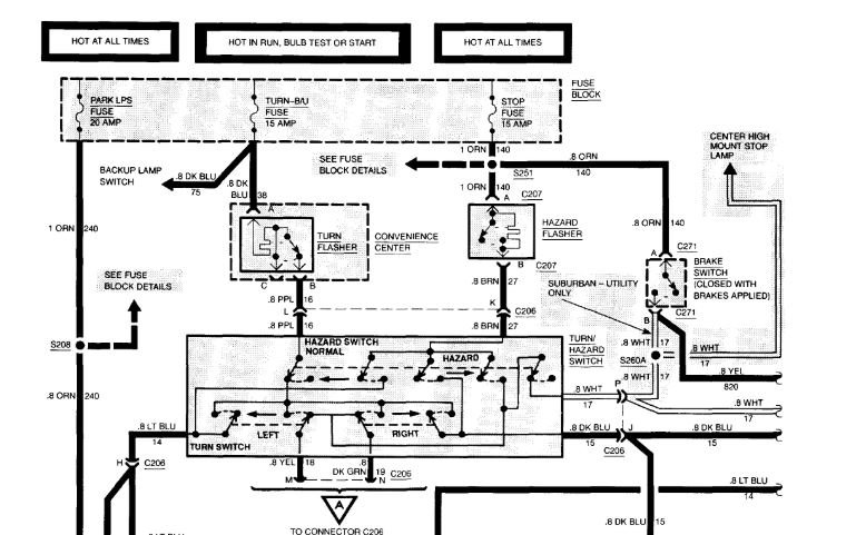

We have tested fuses and they are good!! But we still don't have any brake lights! Have tail lights and back up lights. Is there a brake light switch somewhere? Husband thinks it could be this plug in with 6 wires that goes on the brake rod to the master cylinder. (hope that's what he told me) Is there anyway to test that part?
May 18, 2009 at 9:49 AM
  • 110,240 POSTS
The brake light switch is on the top of the brake pedal. Use a test light to see if you have power on both sides once the pedal is depressed (orange wire)
Here are guides to help you get the job done.
https://www.2carpros.com/articles/brake-lights-not-working
and
There is a tail lamp relay as well

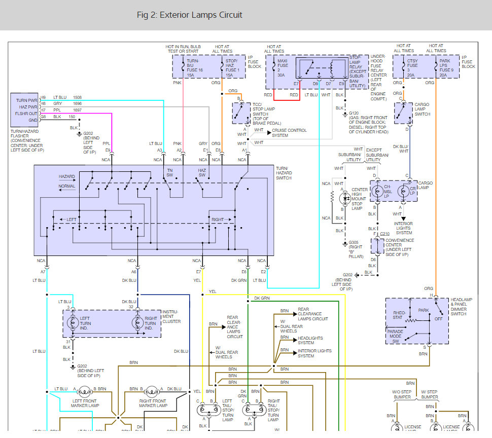

Here is a wiring diagram to help (below) Please let us know what you find.

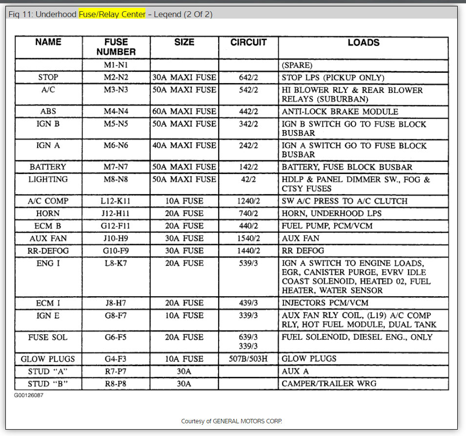

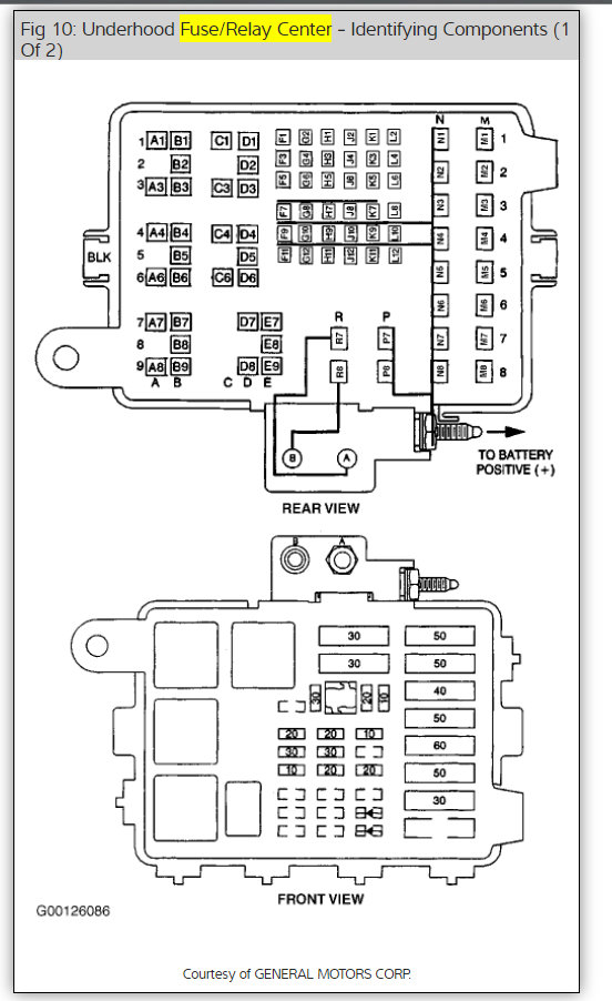

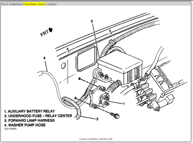

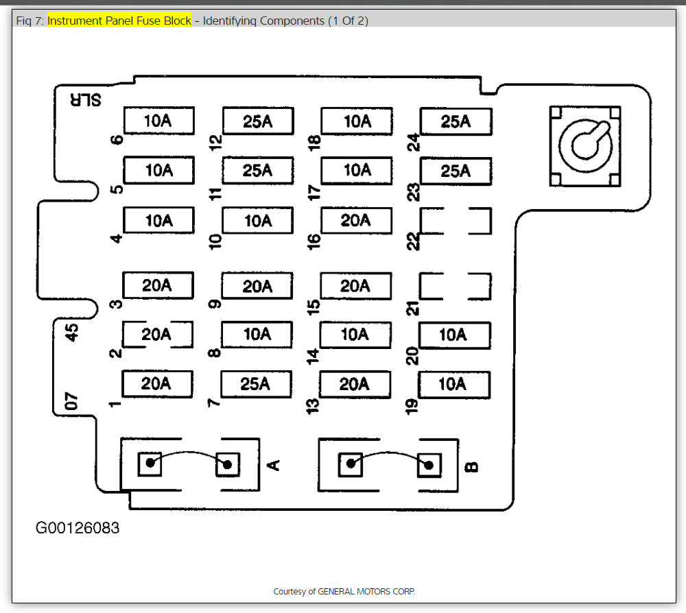

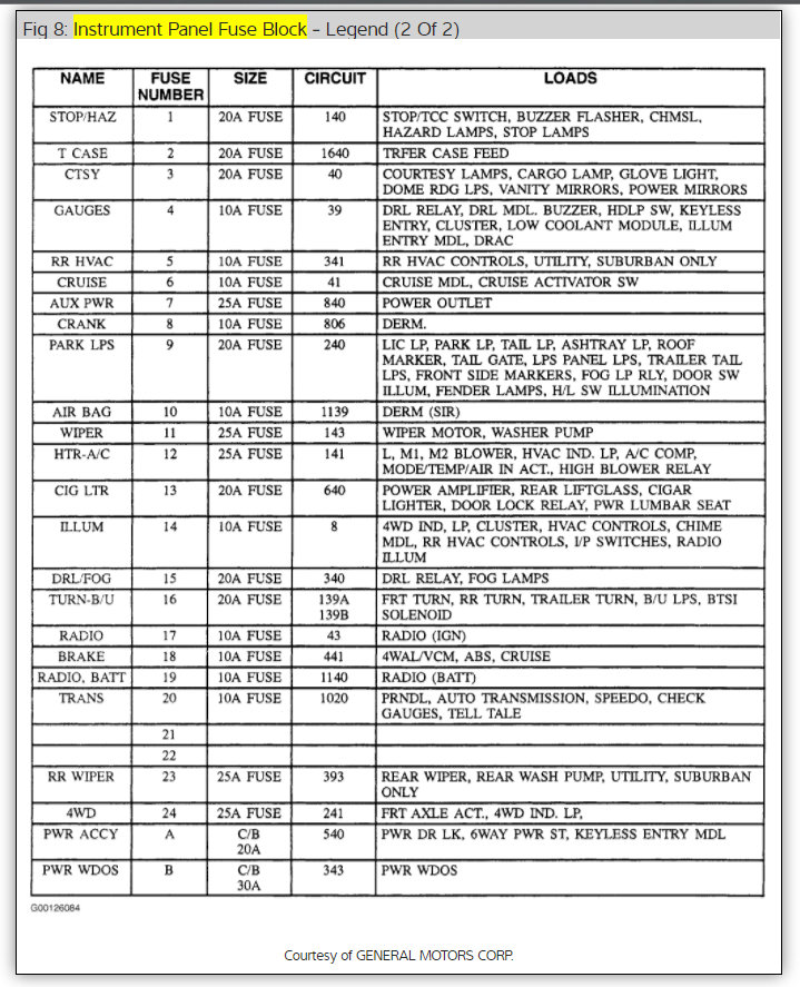

Hey guys, finally gave up on trying to solve this mystery. Took it to the pros and found there is a fuse under the hood. Changed the fuse and now it works.
Hope this helps others!!
Husband says he didn't know they could be under the hood...sigh....

Brake lights on 1996 C1500 stopped working, to include the above cab light as well. Checked and I have no power to the lights (removed left brake light housing and checked continuity). I've checked all the fuses. The #1 location 20amp fuse for aux/haz keeps blowing. If I put in a new fuze and turn on the hazard lights it blows. First guess is a ground wire but its just my guess. It doesn't seem to sound like the brake switch or the turn signal switch...but I don't know so that's why I'm asking you experts. Any suggestions greatly appreciated.

It's not a ground wire problem. Those wires already go to ground so if one is bare and touching the body, that's what it's already going to. If it's broken, there is no short so the fuse wouldn't blow.
A simple trick to finding a short is to replace the blown fuse with a pair of spade terminals, then use small jumper wires to connect them to a 12 volt light bulb. A brake light bulb works well. When the circuit is live and the short is present, the bulb will be full brightness and hot so be sure it's not laying on the carpet or against a plastic door panel. Now you can unplug electrical connectors and move things around to see what makes the short go away. When it does, the bulb will get dim or go out.
You can place a stick between the seat and the brake pedal to keep the brake light switch turned on for the tests. Also, try activating the turn signals each way. If turning on the left signals, for example, makes the test bulb light up bright, but it's just dim for the right signal, you'll know to look on the left side for the short. The place to start looking for a grounded wire is at a trailer wiring harness.

so from the problems I identified, you do not believe it would be the brake light switch or the turn signal switch? Friend of mine thinks it might be one of those two.
I just rechecked and: the taillights work, the turn signals work, the brake lights do not work, the high position brake light does not work.
If I install a fuse, the emergency blinkers and engine compartment light will work for just a moment before the fuse is blown.

I don't have all trucks memorized so you'll have to tell me, . . . does yours use separate bulbs in back, one for the signal and another one for the brake light? Most manufacturers have gone to that. It greatly simplifies the turn signal switch but it makes it miserable for connecting the two independent circuits to one circuit on a trailer.
My guess is you have two separate bulbs because you said the turn signals work. If that is correct, the signal switch is not part of the system so we can forget that. Switches won't cause a blowing fuse anyway because there isn't anything in them going to ground, therefore, no matter what would become shorted, it would just make the wrong lights turn on or at the wrong time.
Do my light bulb trick so you don't have to keep wasting fuses. Once the brake pedal is held down and the test bulb is bright, move harnesses around, particularly in back, and remove the rear lamp assemblies to see if disturbing any of those things makes the bulb go dim. When it does, you'll also see the brake lights turn on dimly.

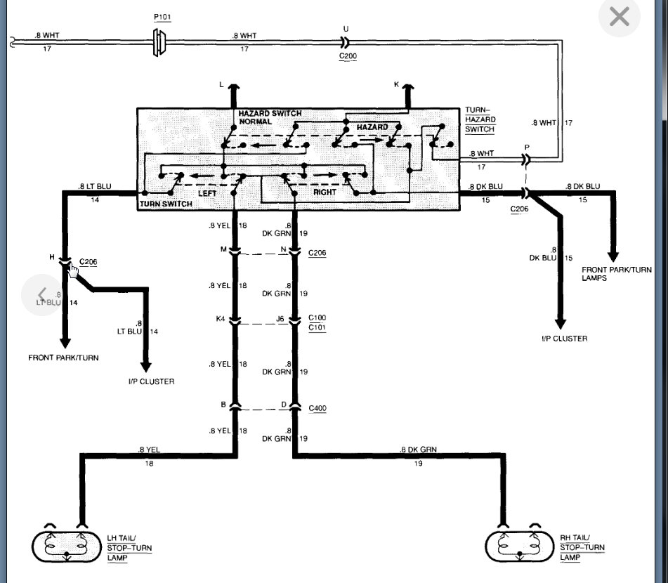

JNET62
The brake light on the cab works but the brake lights on the bed do not.
Feb 26, 2021 at 2:34 AM (Merged)

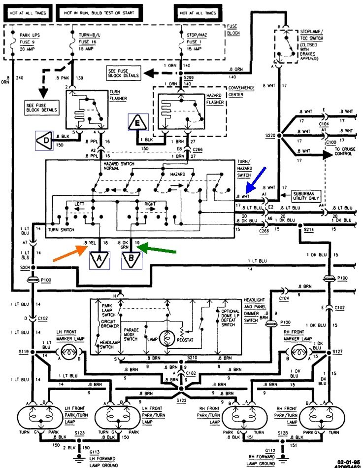

CARADIODOC
  • 34,367 POSTS
The best suspect is the turn signal switch. The working center high-mount brake light proves the brake light switch and its circuit are working. That brake light doesn't go through the signal switch, but the two rear brake lights do.
Before you replace the turn signal switch assembly, be sure the hazard switch is fully turned off and is not stuck midway between on and off.
To verify this, check for 12 volts on the white wire, (blue arrow), at the signal switch connector when the brake pedal is pressed. Next, check on the yellow or dark green wires and you'll find it's not there.

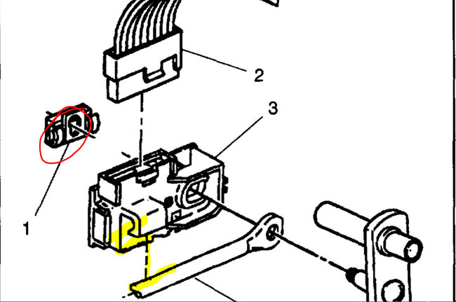

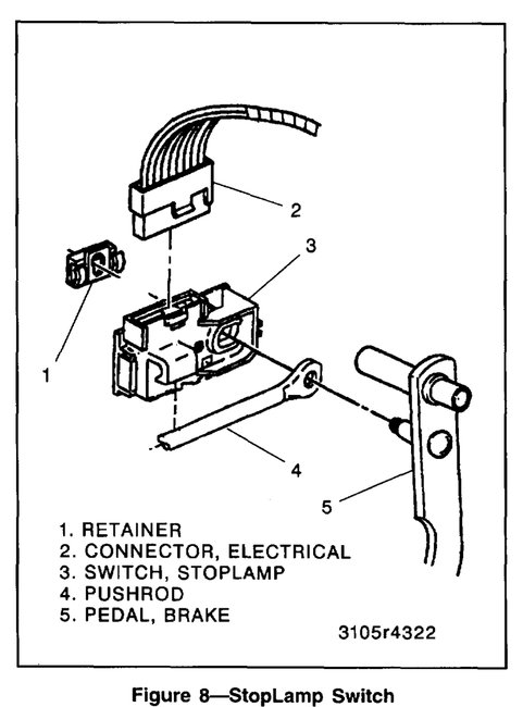

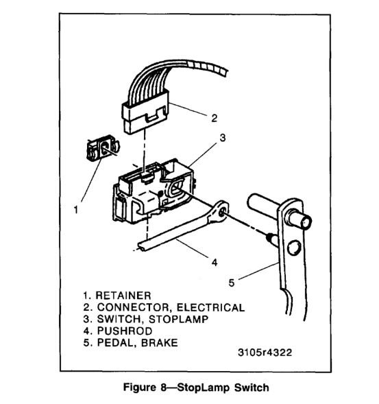

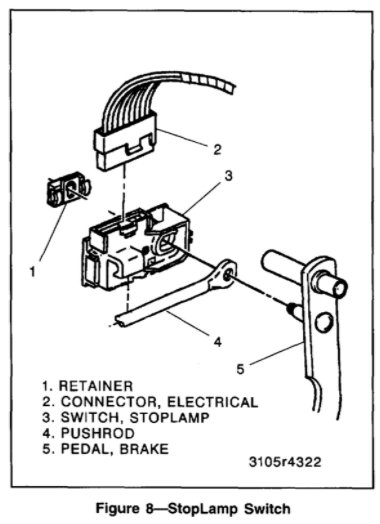

Good evening,
Does the brake pedal feel normal? here is what the brake light switch should look like. Check out the diagrams (Below). Please let us know what happens.
Feb 26, 2021 at 2:36 AM (Merged)
  • 110,240 POSTS

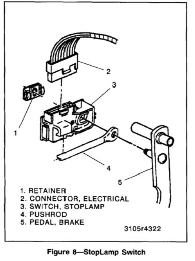

The entire switch shouldn't move. Are you sure it hasn't come disconnected? Here are directions for removal and replacement. Take a look through these directions and confirm it is still properly attached. The two attached pictures correlate with the directions.
________________________

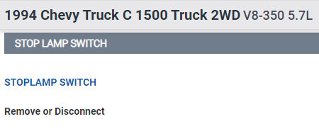

1995 Chevy Truck C 1500 Truck 2WD V8-350 5.7L VIN K TBI
Stop Lamp Switch
Vehicle Sensors and Switches Sensors and Switches - Lighting and Horns Brake Light Switch Service and Repair Procedures Stop Lamp Switch
STOP LAMP SWITCH
STOPLAMP SWITCH
Remove or Disconnect
pic 1
1. Negative battery cable.
2. Retainer from brake pedal pin.
3. Switch by unsnapping from pushrod.
4. Electrical connector from switch.
Install or Connect
pic 2
1. Electrical connector into switch.
2. Switch by snapping it onto pushrod.
3. Retainer onto brake pedal pin.
4. Negative battery cable.

I have a 1194 Chevy Silverado 1500. I am having trouble getting the brake lights to function. All of the running lights work, blinkers and back up lights also. I have replaced the fuse, the lights themselves, and the switch behind the brake pedal. What do I need to work at next?

Does yours have the high mount stop light? Does that work?
FRUSTRATION
Yes. It does have a high mount brake light and cargo light. All the bulbs have been replaced in that light as well, and it does not work either.
MERLIN2021
  • 17,250 POSTS

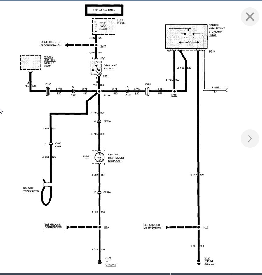

OK The common wire to both runs thru the multifunction switch, a test of that is needed. Also check the relay for the high mount, it's under the hood, on right side cowl(under the windshield). Check the ground for the lights. Check diagram for the location.

Got it. While looking for the problem, I found a ground issue from an old set of backup lights that had been installed and then taken out. Found and fixed! Thanks tremendously for the help!

First check if the center brake light is working. If it is, the brake light switch is okay. Next, check if the cruise control works, then if it cuts out when you tap the brake pedal.
The next suspect is the "Center high-mount brake light relay", (which, oddly enough, does not run the center brake light). Swap that relay with one like it, and check the socket for loose terminals. The next suspect is the turn signal switch or burned terminals in the connector.

I press the brake pedal and it blows out fuse. I replaced switch, relay and ground wire.
Feb 26, 2021 at 2:40 AM (Merged)

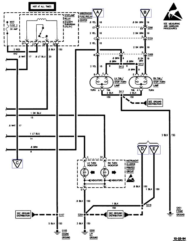

Good morning.
Does the turn signals work normally?
From the switch, the circuit goes to the turn signal switch and the third light relay.
The diagram below for you to view.

Added a new brake switch as soon as you press panel it blows out stop fuse.
I read that in your original post.
Unplug the turn signal switch and replace the fuse and see if it still blows the fuse.

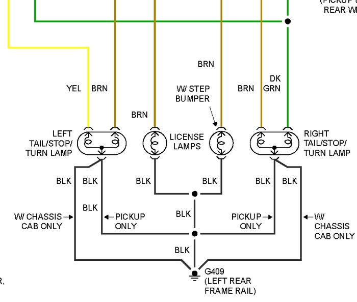

This truck is my daily and i need brake lights to drive it.

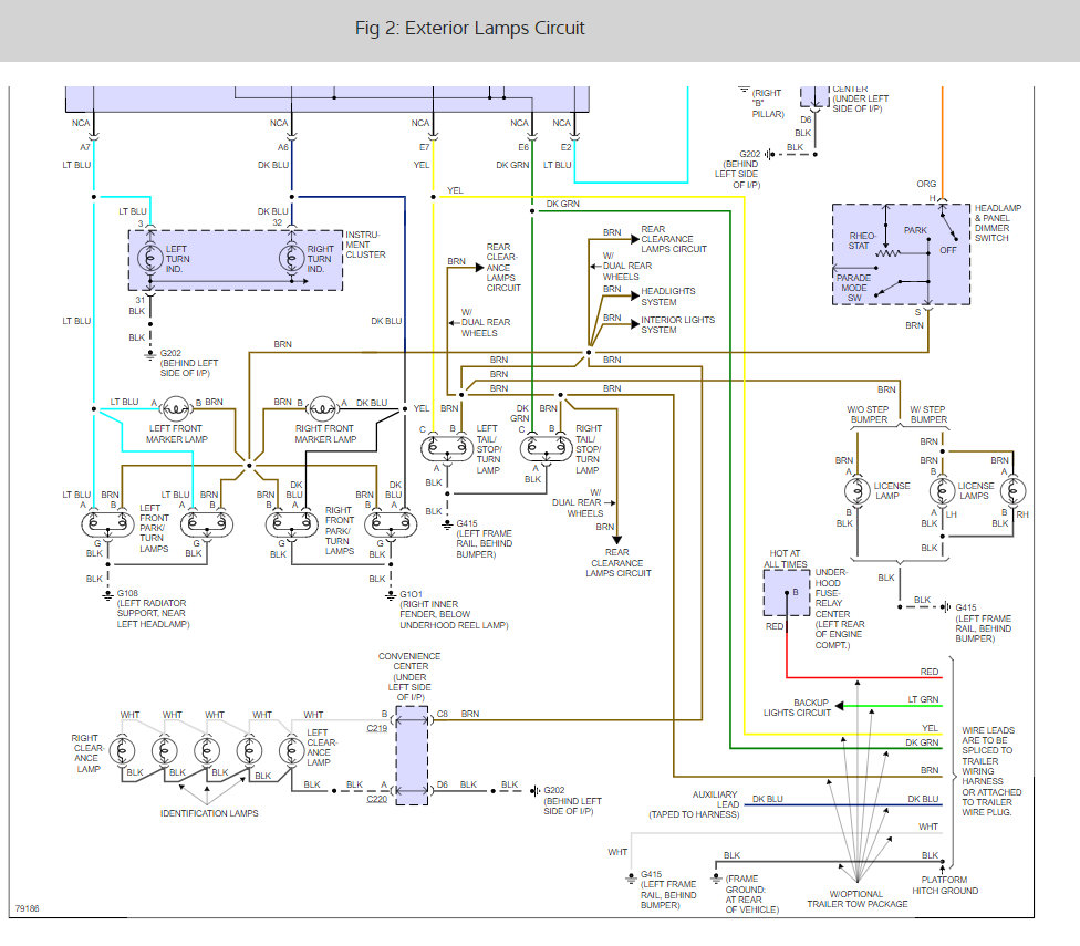

Every light but brake lights work, even running lights in the rear when the headlight switch is on. i replace the circuit boards and bulbs when i had this problem when i bought it and it fixed it for a while, until today. my brake lights stopped working and my CEL came on showing P0172 and P0175 which i've also had before but neglected to fix because the CEL went off after 50-100 miles of driving... i don't think the 2 are related but i could be wrong, please tell me if i am.
i have checked fuses, relays, grounds, and connections to the circuit boards, i even tested continuity to the brand new circuit boards as well. does anyone have an idea of what this could be? i'm not worried about the codes right now if they don't relate to the brake light issue.. i just need them to work so i can work, lol. Edit: if it matters my temperature gauge doesn't "work" either. it moves but not to where it's supposed to.
