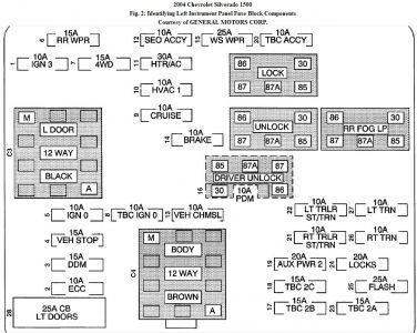

both rear brake lights inop center brake light works fine i have installed new brake light switch and new bulbs still not working
Feb 26, 2021 at 2:07 AM (Merged)

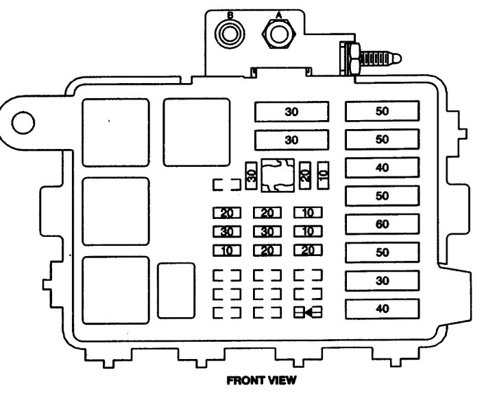

MERLIN2021
  • 17,250 POSTS

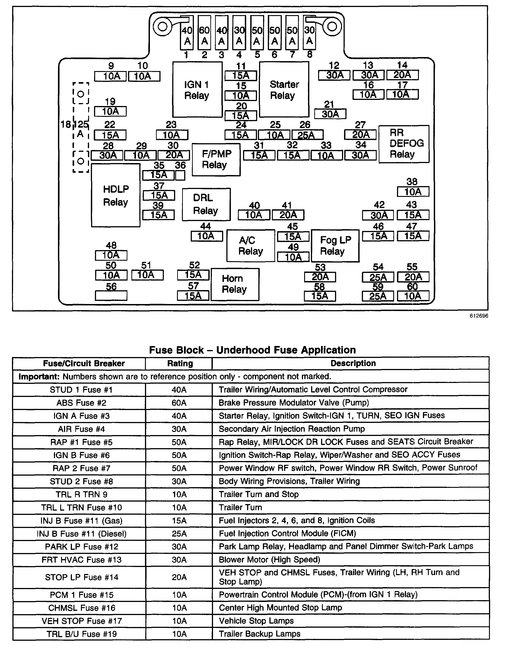

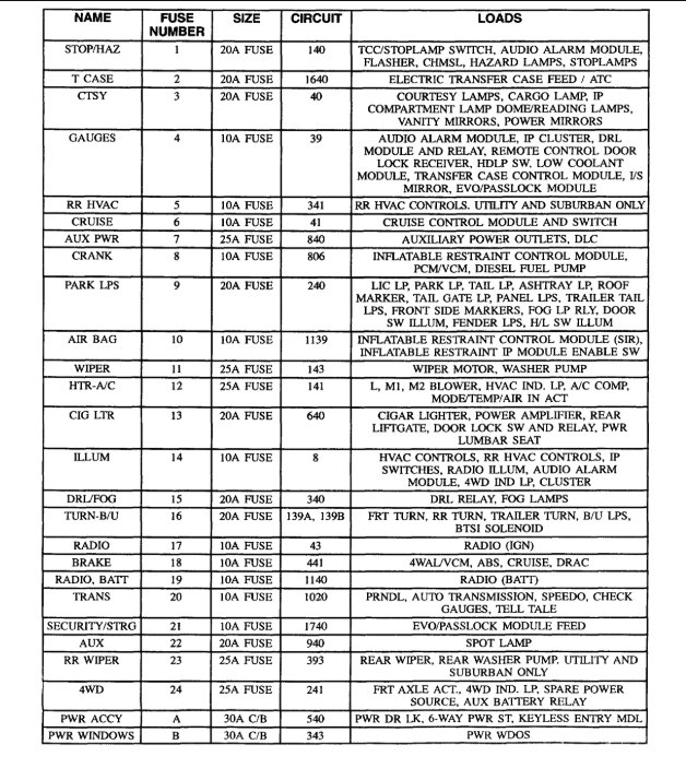

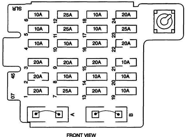

Check fuse on the left side fuse block fuse #4, use only GM approved fuses, some aftermarket fuses can cause issues! also check your email for a pdf if the fuse isn't the problem.
https://images.2carpros.com/forum/automotive_pictures/62217_fuse_panel_int_1.jpg

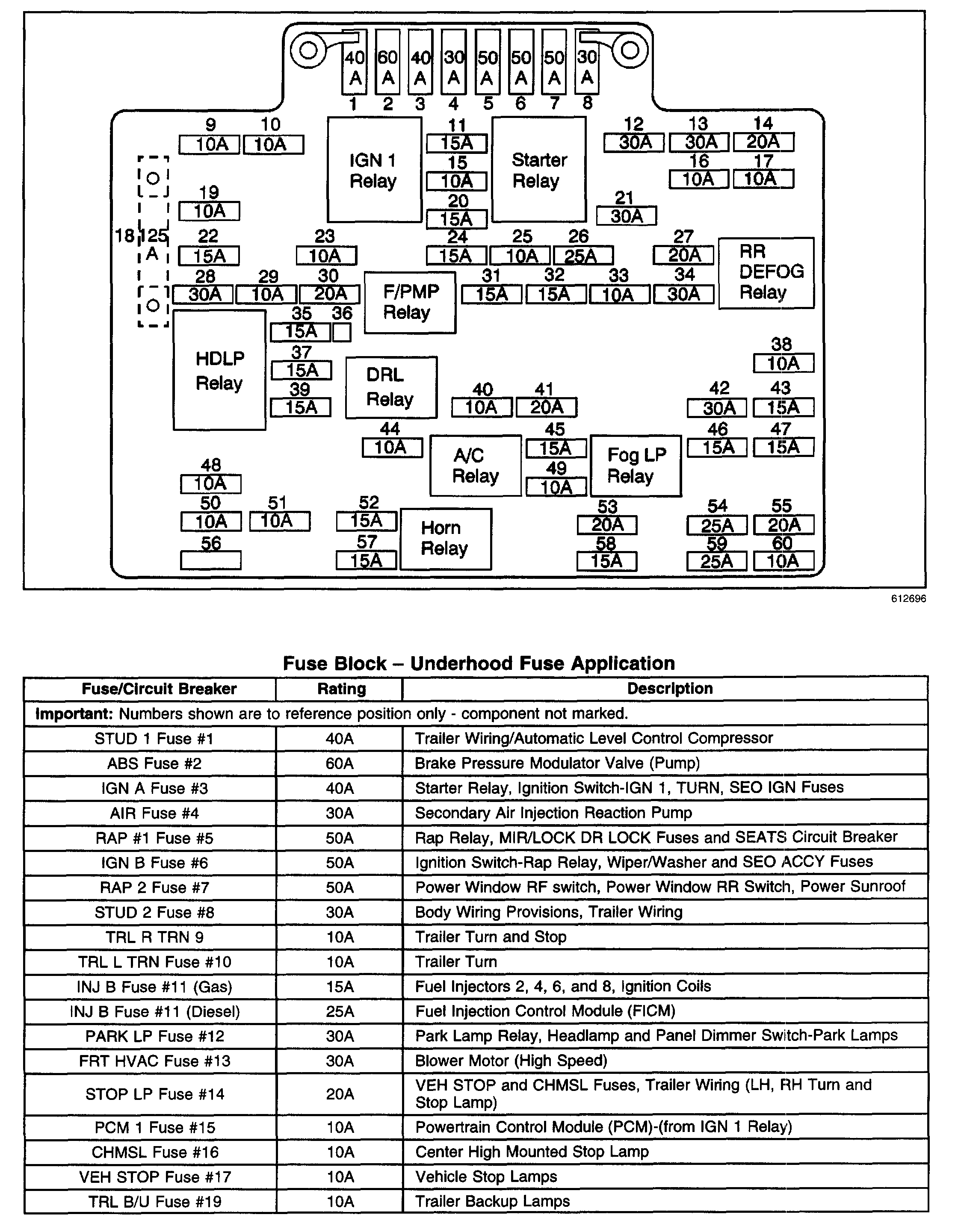

Did you check the stop fuse see below
https://images.2carpros.com/forum/automotive_pictures/12900_stop_1.jpg

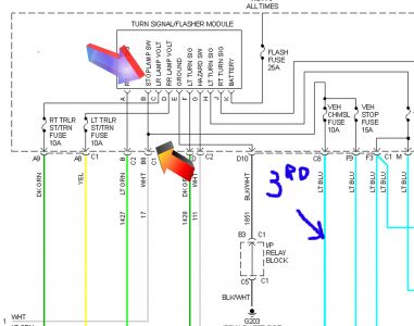

there are 2 outputs for brake lights from brake light switch. one lights the third brake light. the other feed goes to the turn signal switch then to the rear lights. if your rear turn signals work then your problem is most likely the brake light switch. if not its your turn signal switch.

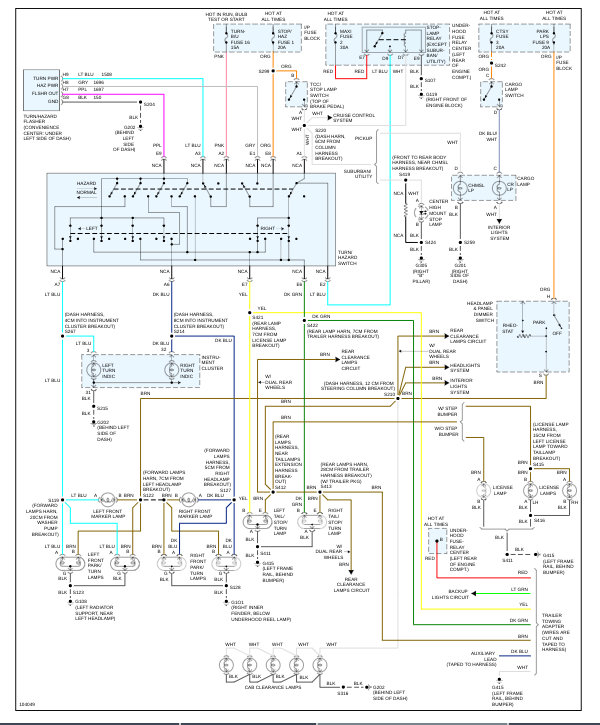

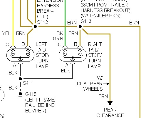

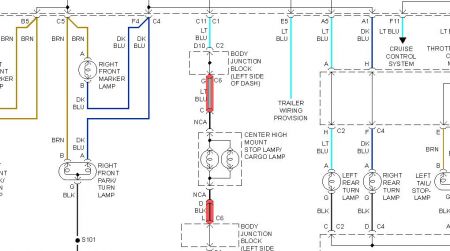

SERVICE WRITER
  • 9,123 POSTS

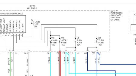

The center high mount (3rd) is powered differently and why it is working.
https://images.2carpros.com/forum/automotive_pictures/30961_sil_1.jpg
You can see where the power goes the the 3rd. So appearantly the white has power to the splice at the orange arrow. The blue arrow points to the t/s module.
https://images.2carpros.com/forum/automotive_pictures/30961_sil2_1.jpg
The brake light switch may be bad? I'm a little weak in the electrical dept. but the module, switch or a wire break would be my thoughts.

  • 110,248 POSTS
Based on what you replaced, I have to ask, did you check for a blown fuse? If not, check fuse 14 in the under hood fuse block. I have attached a picture of the fuse block which includes a legend of what each fuse is used for.
Also, here are a few links which discuss fuses, how to replace, how to use a test light, and how to check wiring. I included them because if the fuse is good, I need you to confirm there is power to and from the fuse.

KHLOW2008
  • 41,812 POSTS

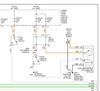

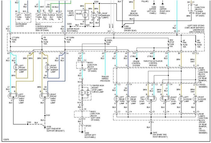

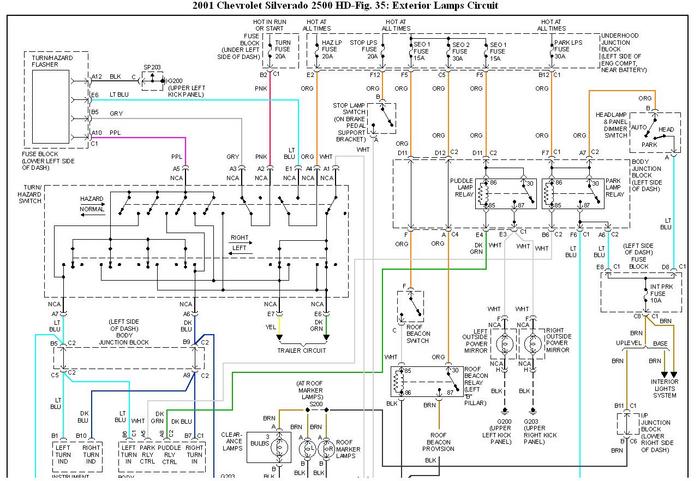

Here is a schematic of the exterior lights.
Check the Orange wire at brake switch, on top of brake pedal for battery voltage. If voltage is available, use a jumper wire to bridge the Orange and White wire. If brake lights come on, the switch is bad or out of adjustment.

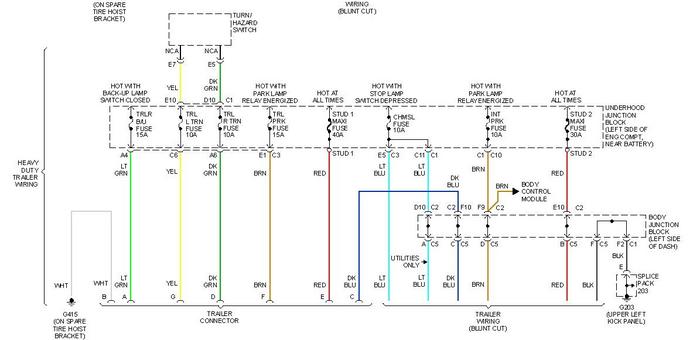

JBIGELOW007
  • 5 POSTS
The truck has functioning lights, when i plug in 7pin harness to my trailer i have running lights, turning signals, backup lights, power to my electric brakes but no stop lights on trailer> Please help Jeff
Feb 26, 2021 at 2:11 AM (Merged)
KHLOW2008
  • 41,812 POSTS
Do you mean only the trailer stop lights are not working?
Are the brake lights on vehicle body working correctly?
The CHMSL fuse (10A) is for the brake lights. If battery voltage is not available athe trailer connector, check the CHMSL fuse. Use a test lamp to test both ends of the fuse. If voltage is available and none found at trailer connector (Light Blue wire), you have an open circuit between the fuse and trailer connector.
JBIGELOW007
  • 5 POSTS
Thank you KHLow2008 will try to test that circuit (fuse is good)will advise thanks again. Jeff

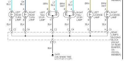

JDL
  • 16,098 POSTS
The lite blue wire is voltage for brake lamps. Black wire is ground.

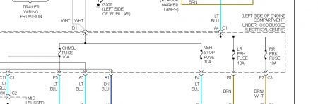

  • 75,988 POSTS
Did you checked the CHMSL fuse 10amp it powers the 3rd light-if okay-inspect and test the light blue wire at the body junction box left side of dash

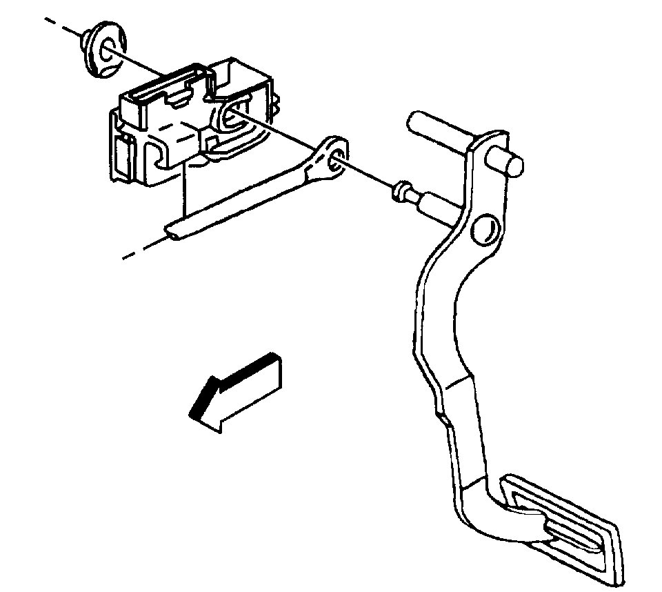

JESS BARKER
My brake lights work after 8:00 am and stay on at night, the four wheel drive does not work if the brake lights will not turn off. I am thinking it may be the sensor for the automatic lights on/off function. Any ideas?

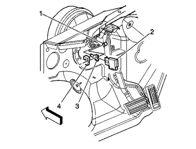

  • 110,248 POSTS
It sounds like you have a bad brake light switch. Have you checked it? It is located at the top of the brake pedal. Here are the directions for removal and replacement if you find it is bad. The attached picture shows the switch and correlates with these directions.
CAUTION: Refer to Battery Disconnect Caution in Service Precautions.
1. Disconnect the negative battery cable.
2. Disable the SIR.
3. Remove the pushrod retainer from the brake pedal pin. Use snap ring pliers.
4. Unsnap the stoplamp switch from the pushrod.
5. Disconnect the electrical connector from the stoplamp switch.
INSTALLATION PROCEDURE
1. Connect the electrical connector to the stoplamp switch.
2. Snap the stoplamp switch onto the pushrod.
3. Install a new pushrod retainer on the brake pedal pin. Use an 11 mm (7/16 inch) socket in order to push a new clip onto the pin.
4. Connect the negative battery cable.
5. Enable the SIR.
Let me know if this helps.

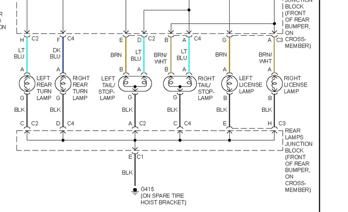

On my pickup, I have no Brake lights or taillights, they seem to work sometimes but are very dim. i was told to try a new circut boards at the tail light assembly, ive tried new bulbs, checked connection under truck and checked ground but cannot figure it out????
Feb 26, 2021 at 2:12 AM (Merged)
JDL
  • 16,098 POSTS

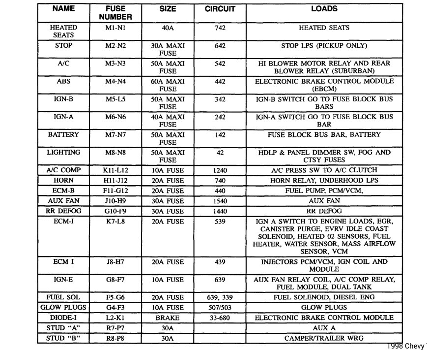

Check the fuses in the diagram, check the actual voltage readings. This is for brake lites. The stop lamp fuse and center high-mount fuse, underhood fuse block. With the brake switch activated, the voltage should be close to battery voltage. Yes, it does sound like it could be a grounD problem? this guide will help https://www.2carpros.com/articles/brake-lights-not-working
https://images.2carpros.com/forum/automotive_pictures/170934_silverado_ground_1.jpg
https://images.2carpros.com/forum/automotive_pictures/170934_silverado_brake_lites_1.jpg

JDL
  • 16,098 POSTS
Does the highmount brake lite work? Did you check for voltage going to the brake switch, orange. The lower brake lites are wired through the multifunction switch. At the lower rear, the brake lites and turn signals use the same bulb filament, just not at the same time. Check voltage and ground at the rear.
In the diagram, the brown wire is voltage for tail lamps, the other color wires are for stop/turn. The black wire is ground.
