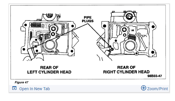

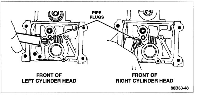

Check at the front and rear of the cylinder heads to see if there is evidence of a leak. Take a look at the pics below. I believe that is a water port that is being plugged. If it is leaking there, it could go directly into the engine. It's a theory, but worth checking.
See pic below.

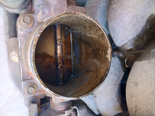

Just a follow up. I'd drained all of the oil from the engine, and the fluid from the radiator.
Made sure the oil pan screw and the oil filter were snug and just for the sake of doing it I decided to blow into the overflow tank where I fill the radiator, and there was pretty much no resistance. I decided to take the air filter housing off so I could get a better look and when I disconnected it from the throttle body oil came out. I haven't started this truck since before water started coming out of the oil dipstick tube, so this sludgy mess was in the TB prior to my fiasco with the water coming out of the dipstick hole. I know sometimes this could be an indication of worn rings, but there was a decent amount of sludge in the TB that came out when I removed the air filter housing. Thanks
Feb 7, 2024 at 3:54 AM
  • 110,244 POSTS
Wow, that is a mess. I don't think the rings caused this. When you pressurized the reservoir, you said there was little resistance. Could you hear anything that would indicate where the air is going?

You may want to inspect the plugs in the pics I attached above. Also, how much coolant was added before it started leaking from the pan? For example, was the radiator level low or high?

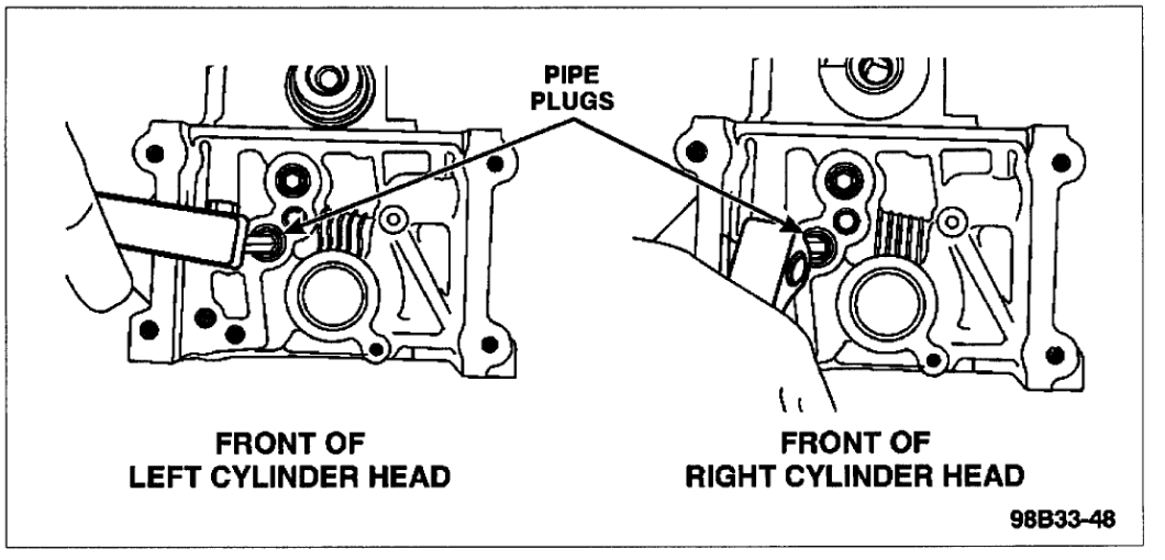

If it is coming in that fast, I have a feeling the block may be cracked. I had one a few years ago that had a hole rusted through in one of the coolant channel right where pressure is direct from the water pump.
Check closely for any internal damage to the block. If you can't see anything, I don't want to say it, but the oil pan will need removed to see where the coolant is entering from.
With the pump removed, inspect internally for cracks or rust issues.
See pic below.
Mar 26, 2024 at 1:17 PM

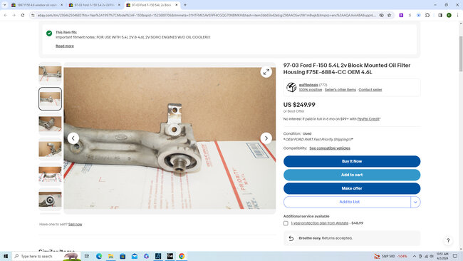

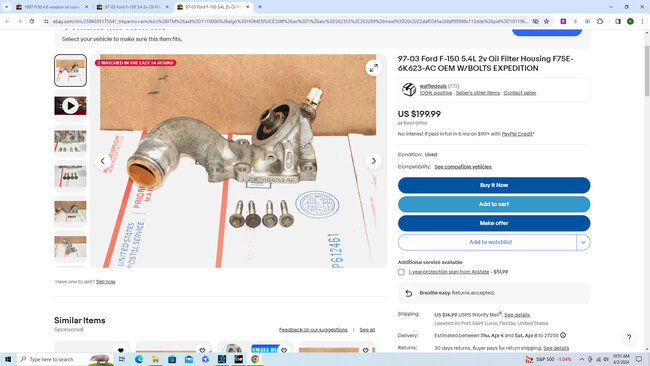

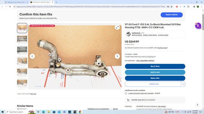

Good morning.
Evidentially some 1997 4.6 Windsor engines come with an oil cooler, and some without an oil cooler. My truck has an oil cooler, but the engine I'm looking at, based on the pictures, do not have an oil cooler. The VIN number's 8th digit matches. The oil pans, from what I've gathered, are the same. Amazed there are so many little differences in these engines that are supposed to be the same. Any idea if the engines without the oil cooler would be able to be swapped out for an engine with an oil cooler? Thanks
My VIN 1FTDX1860VNA40830
Donor engine VIN 1FTDX1761VNB31784
Apr 2, 2024 at 1:02 AM
SWILSON3828
  • 112 POSTS
Sorry, bad pic of non oil cooler.
Apr 2, 2024 at 2:30 AM
  • 110,244 POSTS
I'm almost afraid to answer. LOL In theory, you should be able to remove one and install the other. The orientation of the filter between the two will be different, but if you reuse the original one, it should be in the correct place for the vehicle.
I tried to zoom in on the base where it mounts. They appear to be the same. Is that correct or am I missing something?
Apr 2, 2024 at 3:37 AM
SWILSON3828
  • 112 POSTS
Yes, I got the same impression. If I may ask how difficult is it to remove the oil cooler housing? I really just want to take a look in the inside of the housing before I spring for a replacement motor. Just a gut feeling that that may reveal the source of the issue I'm having. Thanks
