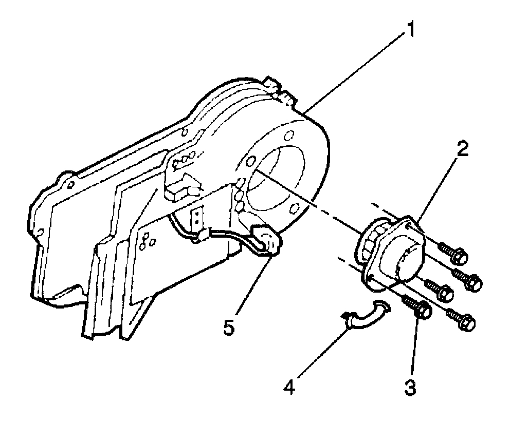

Here are the directions for replacement. I'm simply adding them so you can see what is involved and determine if it is something you can or want to do yourself. The attached pics correlate with the directions.
___________________________
1999 Buick LeSabre V6-3.8L VIN K
Blower Motor and Fan Replacement
Vehicle Heating and Air Conditioning Blower Motor Service and Repair Procedures HVAC System - Manual Blower Motor and Fan Replacement
BLOWER MOTOR AND FAN REPLACEMENT
pic 1
REMOVAL PROCEDURE
1. Remove the cross car support brace.
2. Remove the rear spark plug wires and bracket and set aside.
3. Disconnect the electrical connector (5) from the blower motor (2).
4. Remove the cooling tube (4) from the blower motor (2).
5. Remove the screws (3) that attach the blower motor (2) to the blower module assembly (1).
6. Remove the blower motor (2).
INSTALLATION PROCEDURE
1. Install the blower motor (2).
NOTE: Refer to Fastener Notice in Service Precautions.
2. Install the screws (3) to the blower motor (2).
Tighten
Tighten the screws to 6 N.m (55 lb in).
3. Install the cooling tube (4) to the blower motor (2).
4. Connect the electrical connector (5) to the blower motor (2).
5. Install the rear spark plug wires and bracket.
6. Install the cross car support brace.
