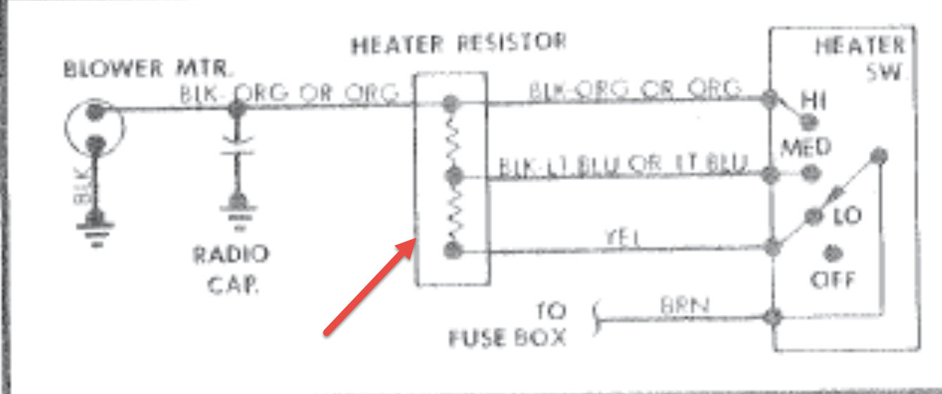

Blower motor runs only at low speed
89,000 MILES • 5.0L • V8 • RWD
GORDON HAMMOND
When I turn the heat or air conditioner on all the blower runs on is low speed.
Aug 18, 2016 at 4:49 AM
HMAC300
  • 48,601 POSTS
this may be burnt wires at switch or a resistor or a bad switch. the resistor may be on heater box under-hood, been so long I forgot and we do not list it in our manual. if this is automatic temperature control where you set temperature it is completely different.
