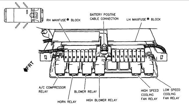

where do I find relay switch for heater blower fan?

Here is a guide to help test the relay with the location in the diagrams below.
Here are the fuse panel locations and notifications Check out the diagrams (Below). Please let us know what happens.
