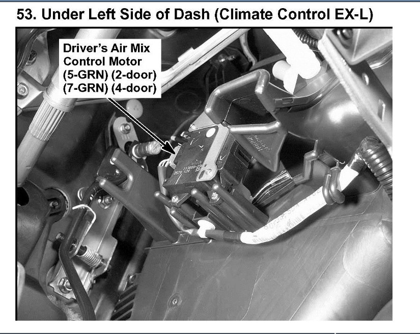

I have dual A/C. Driver side was blowing heat with temperature all the way down. And passenger side would only blow cold. I ordered both right and left side blend door actuators thinking maybe they had both gone out. I even heard the clicking sound on the passenger side. I found and replaced the one that’s part number said driver side but it fixed the passenger side problem. Can you tell me where the other blend door actuator is located? I only see motors. Including a picture of the one left to replace..

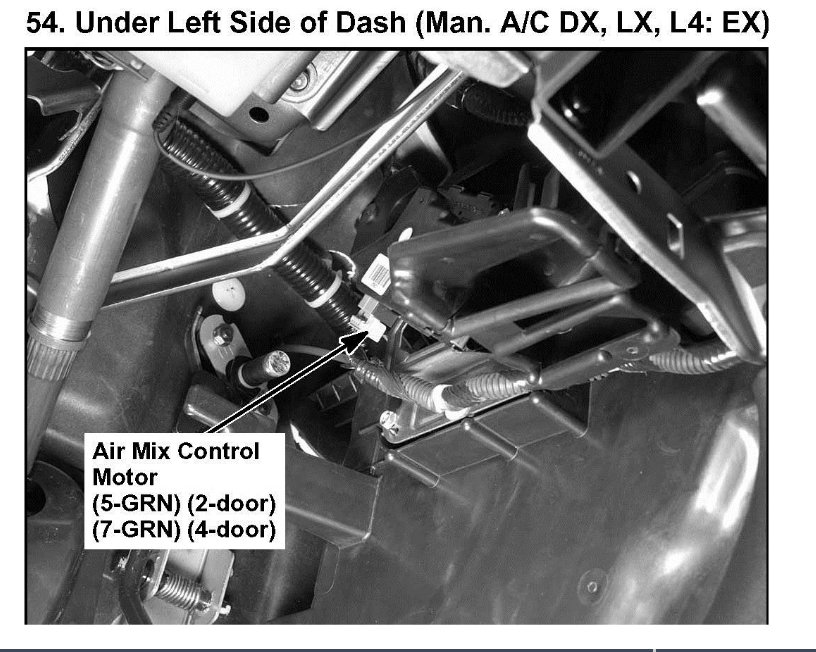

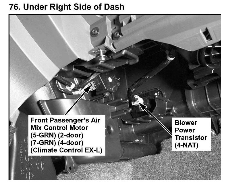

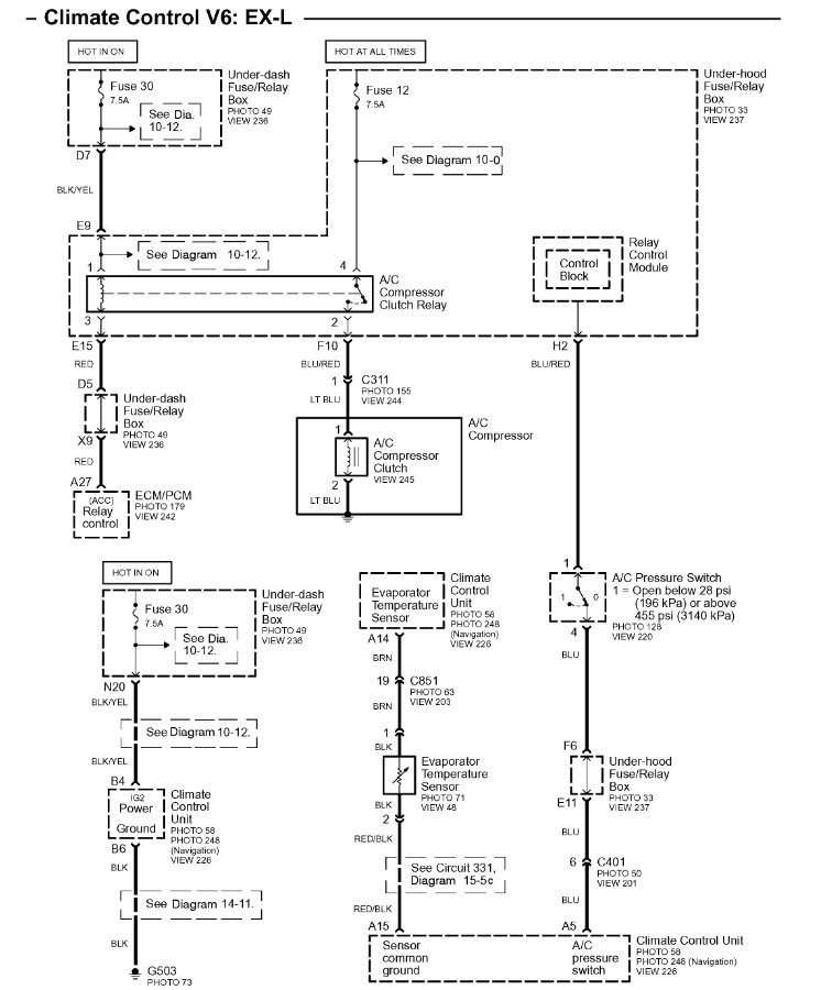

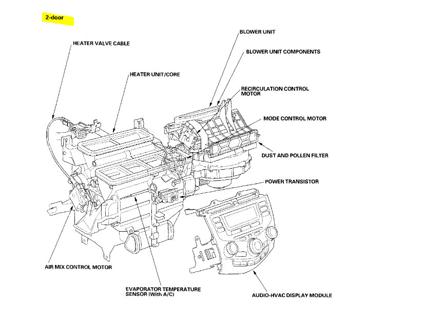

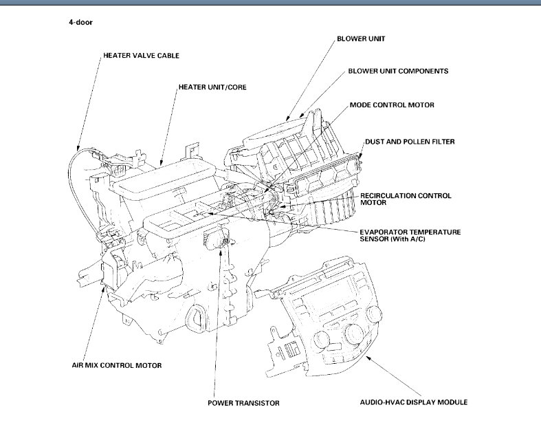

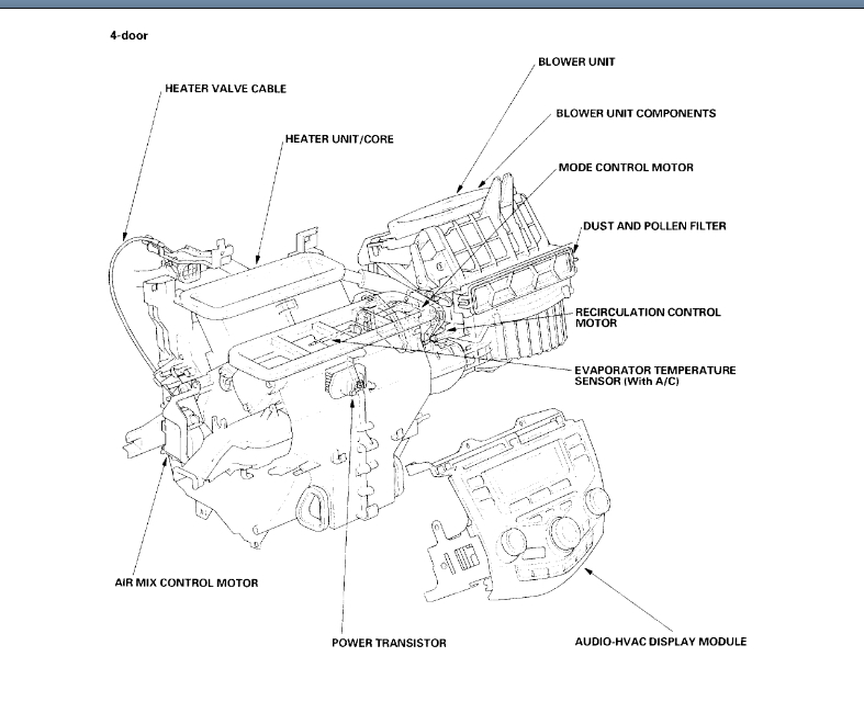

I have included the information that you have requested in the diagrams down below. Please go through the guide from the vehicle manufacturer and report back with how everything turns out, please.

I see the diagrams but are there two blend door actuators? I can only find one. And I ordered the two available. one for the drivers and one for the passenger.
Oct 11, 2019 at 11:28 AM
SCGRANTURISMO
  • 4,897 POSTS
I don't see a actuator for driver or passenger side. I did include the two diagrams, one for a coupe [2 door] and one for a sedan [4 door]. his is the only configurations that were available for the year, make, and model of your vehicle.

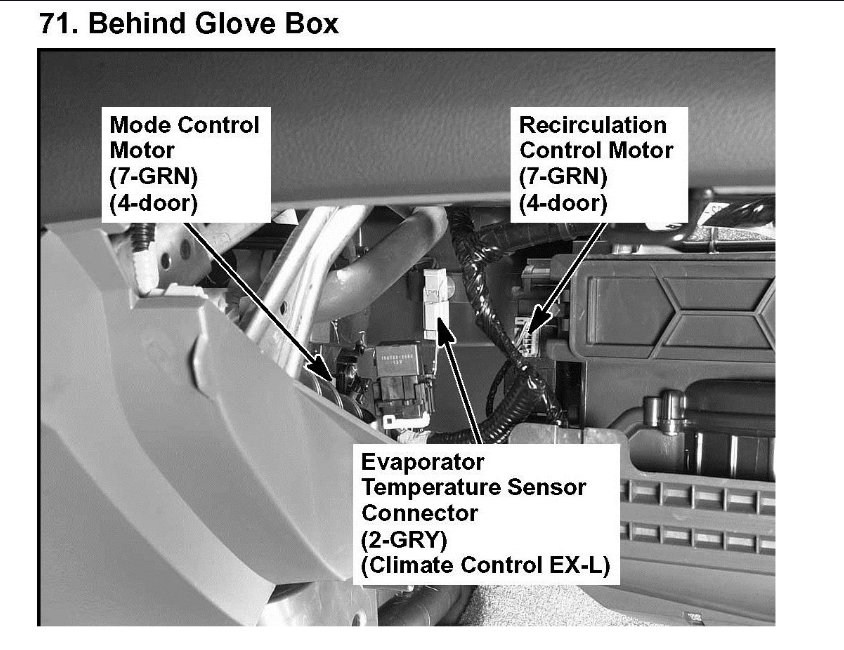

I have the car listed above EX V-6 with dual zone heat and AC. The vents blow only to the defroster. I have checked, and the mode door actuator does not move.
So, here are my questions:
1. Where is the fuse located for this? Going by the diagrams, nothing is listed for this. Online, I have seen that it is fuse #8, however that is the power windows.
2. Where can I get the motor, if needed? Looking online and all I can find is the blend door actuator. This is not what I need. I specifically need the mode control actuator located behind the glove compartment.

If the other controls work and only the mode control is not the issue is not the fuse as it provides all of the power to the HVAC controls as well as the AC relay. It is fuse 30 in the under dash box.
For the motor, that is likely a dealer only item, unless you can find a used one.
For the mode motor
Honda shows part number 79140-SDN-A01 for the 2 door unit and 79140-SDA-A01 for the 4 door.
hondapartsnow.com

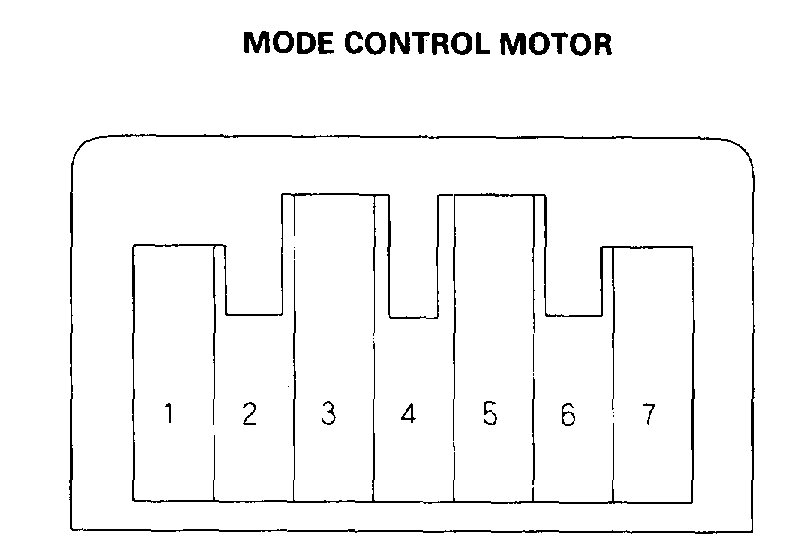

Here are the tests for that motor for both the 2 and 4 door version.
To do these tests it would be easier to remove the mode motor first. Or leave it installed and if the motor moves you could move it using a couple of jumper wires to the power terminals as needed until you found a new motor.

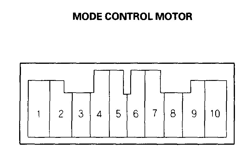

Mode Control Motor Test
4-door
1. Disconnect the 7Pin connector from the mode control motor.
NOTE: Incorrectly applying power and ground to the mode control motor will damage it.
Follow the instructions carefully.
2. Connect battery power to the No.2 terminal of the mode control motor, and ground the No.1 terminal; the mode control motor should run smoothly, and stop at Vent. If it doesn't, reverse the connections; the mode control motor should run smoothly, and stop at Defrost. When the mode control motor stops running, disconnect battery power immediately.
3. If the mode control motor did not run in step 2, remove it, then check the mode control linkage and doors for smooth movement.
- If the linkage and doors move smoothly, replace the mode control motor.
- If the linkage or doors stick or bind, repair them as needed.
- If the mode control motor runs smoothly, go to step 4.
4. Use a digital multimeter with an output of 1 mA or less at the 20 kOhm range. With the mode control motor running as in step 2, check for continuity between the No.3, 4, 5 and 6 terminals and the No.7 terminal individually. There should be continuity for a moment at each terminal as the motor moves past the switch's terminal.
5. If there is no continuity for a moment at each terminal, replace the mode control motor.

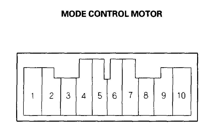

2-door
1. Disconnect the 10P connector from the mode control motor.
4. Use a digital multi-meter with an output of 1 mA or less at the 20 kOhm range. With the mode control motor running as in step 2, check for continuity between the No.6, 7, 8 and 9 terminals and the No.10 terminal individually. There should be continuity for a moment at each terminal as the motor moves past the switch's terminal.

Good morning.
It is behind the glove box. Instruction below.
4-door

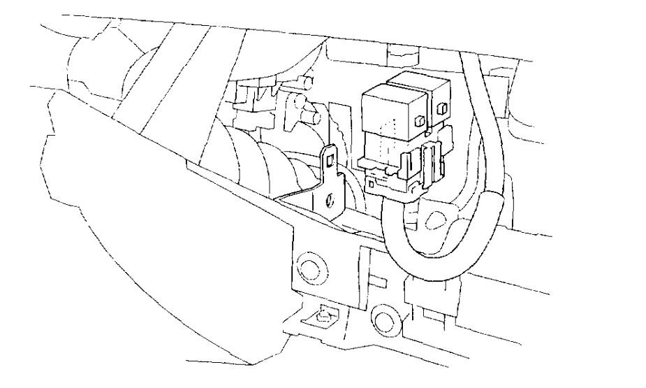

1. Open the glove box. Remove the damper from the glove box, then release the glove box stops and let the glove box hang down.
imageZoom/Print
2. Remove the relays from the bracket.
imageZoom/Print

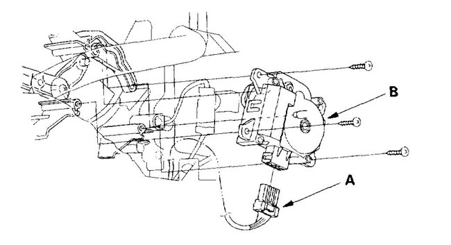

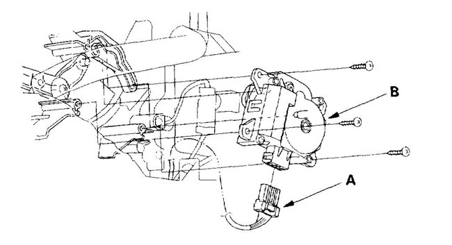

3. Disconnect the 7P connector (A) from the mode control motor (B). Remove the self-tapping screws and the mode control motor from the heater unit.
4. Install the motor in the reverse order of removal. After installation, make sure the motor runs smoothly.
2-door
imageZoom/Print
imageZoom/Print

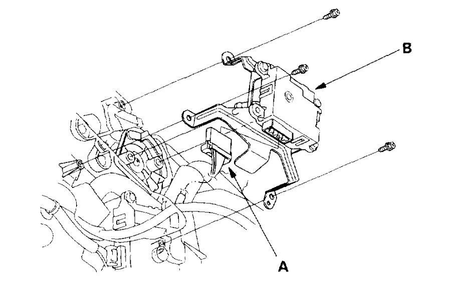

3. Disconnect the lop connector (A) from the mode control motor (B). Remove the self-tapping screws and the mode control motor from the heater unit.

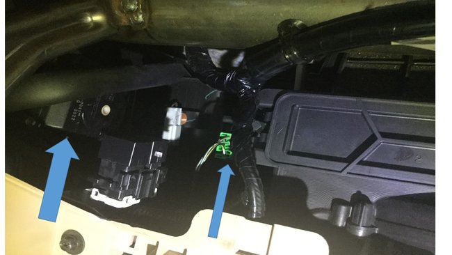

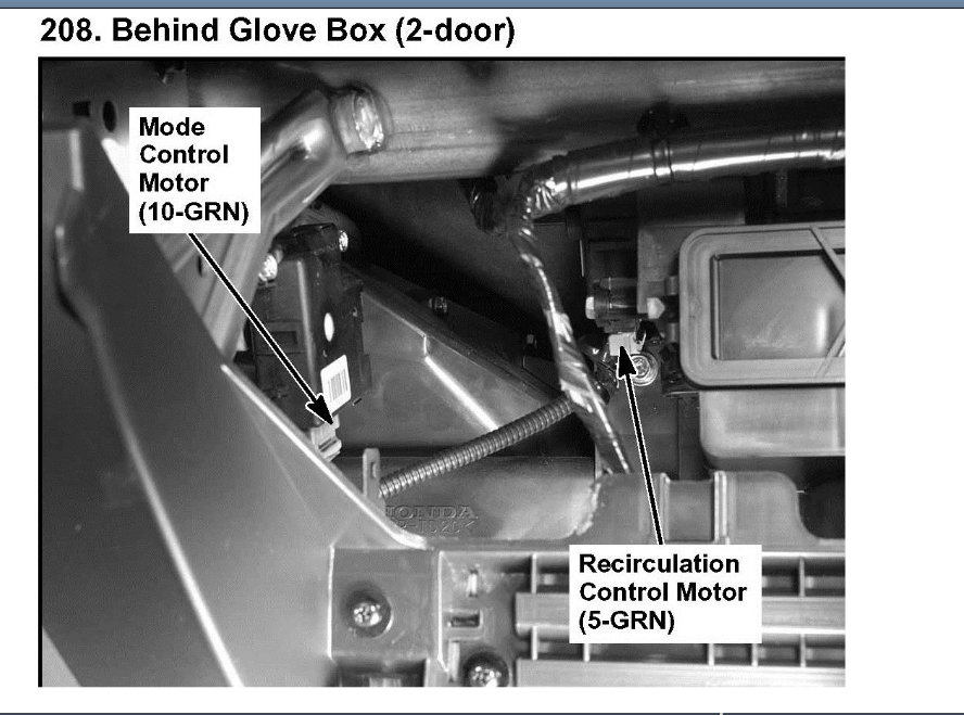

There are three actuators on my 2005 Honda Accord EX V6. One under the driver's side and two in the glove compartment. Now I know I am not concern with the one under the driver's. However, I have attached a picture of the two in my glove box. There is one right next to the cabin air filter and one away from the cabin air filter. I am thinking that the one furthest away, is the Mode Air Door Actuator. (Also, what are both of those actuators called?)
Dec 1, 2020 at 4:53 AM (Merged)
Is there one at the end of the case, that is, more to the left like in the picture?
WAYNE BLUE
  • 15 POSTS
No sir, that is it. According to one of the pictures you sent me, it is showing the actuator right behind the hose in this picture. That is exactly the position of the actuator behind my glove box.
Okay, that is the mode door.
The other doors are blend door and air circulation door.
