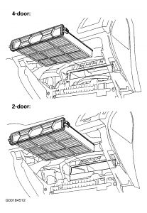

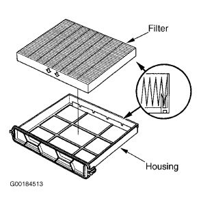

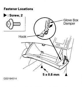

2005 Honda Accord
How do I replace cabin filter
Sunday, January 18th, 2009 AT 10:11 AM
BMRFIXIT
MECHANIC
19,053 POSTS
+1
Sunday, January 18th, 2009 AT 10:30 AM
