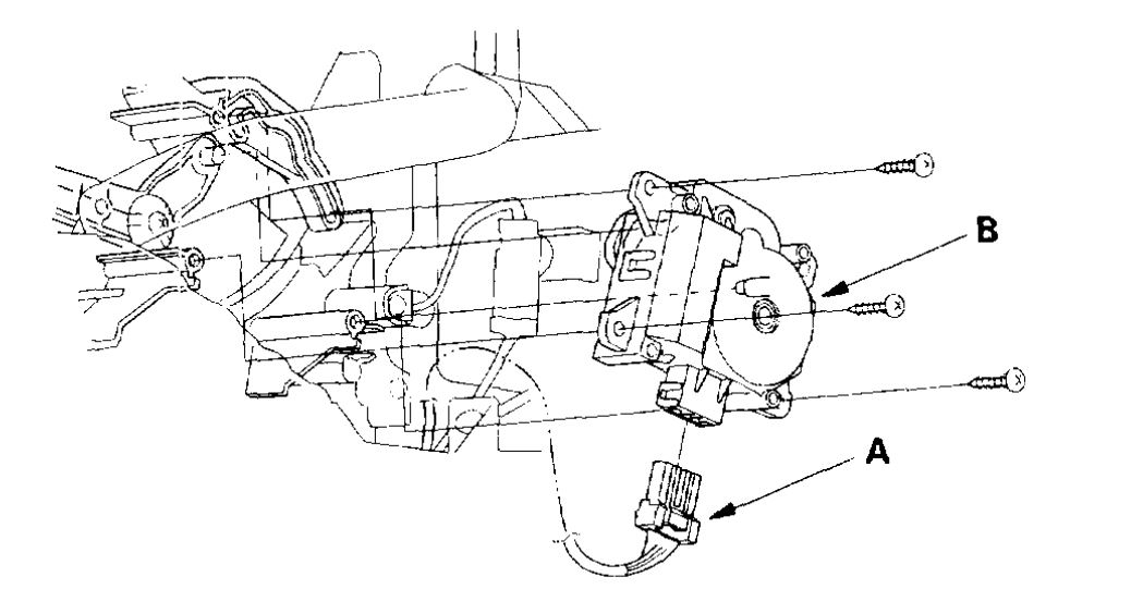

No sir, that is it. According to one of the pictures you sent me, it is showing the actuator right behind the hose in this picture. That is exactly the position of the actuator behind my glove box.
Tuesday, December 1st, 2020 AT 12:53 PM (Merged)
  • 52,797 POSTS
Okay, that is the mode door.
The other doors are blend door and air circulation door.

OK.I am having an issue with one of the two on the passenger side. It is making a clicking noise. I am not a mechanic, and usually break more than I can fix. But this one seems pretty simple.
I just want to make sure I buy the right part #. The one making the noise is the lower of the two. I don't know if that is a mode door or blend door, and I don't know if they are the same or different part #s (it seems they are the same part number, but I can't see the one up higher on the car).
I have a 2006 Honda Accord 4 dr 2.4L. I think the part I need is 604-881. The writing on the part says AW063800-0090. Please help me know which part to buy.I am sure I can install it.

To be sure, remove the one that is making noise and take it with you to the parts store so you get the correct one.
