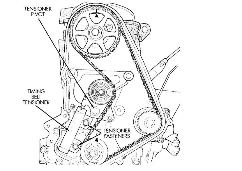

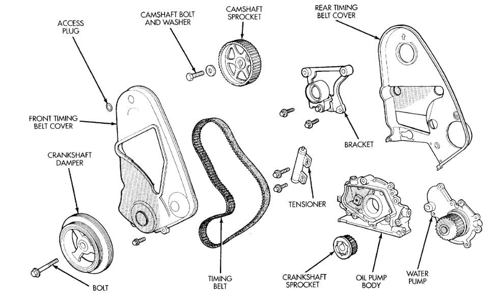

This is an interference engine. When the timing belt jumps one tooth, the "Check Engine" light turns on, and the diagnostic fault code will be "Cam and Crank Sync". When the belt jumps two teeth, the engine computer shuts the engine down. Three teeth and the pistons will hit any open valves.
The first thing to do is to check the timing marks to see if the belt has jumped. You should have a Check Engine light on though. A comon cause for the Cam and Crank Sync code when the timing belt has not jumped is a sheared off dowel pin between the camshaft and sprocket. The sprocket spins a little on the camshaft mimicking a jumped timing belt.

I would start with a compression test to verify the timing belt has not moved.

It could be the timing belt and the compression test I suggest will confirm that.

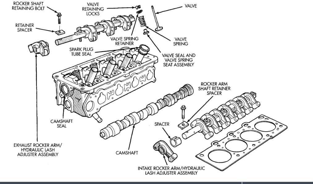

Compression test spark plug 1 60.
#2 didn't read and we'll as #3 #4 read 29.

You need to do the test first. Then based on your readings we can determine the damage.
Based on your results, it looks like the belt has failed and you may have valve damage.
The head will have to come off and be inspected.
