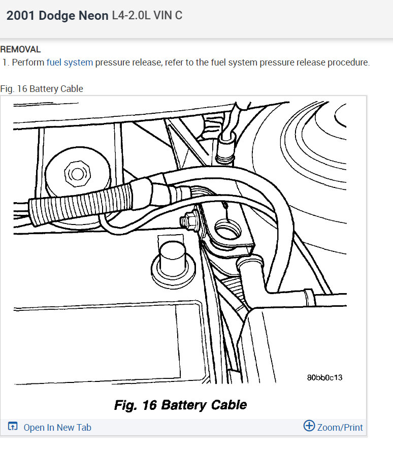

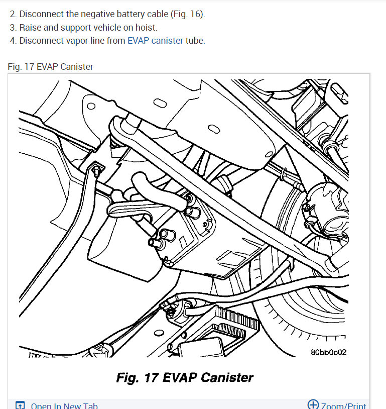

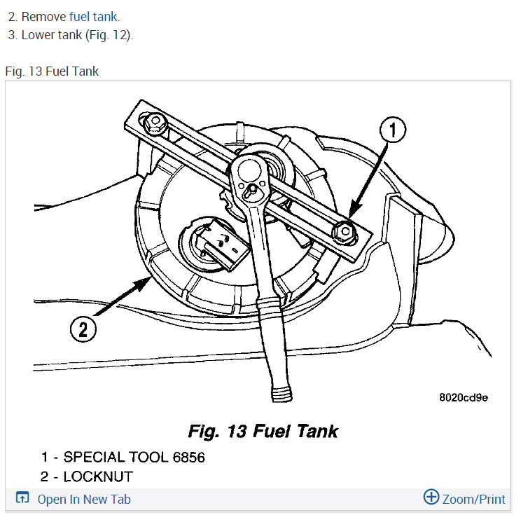

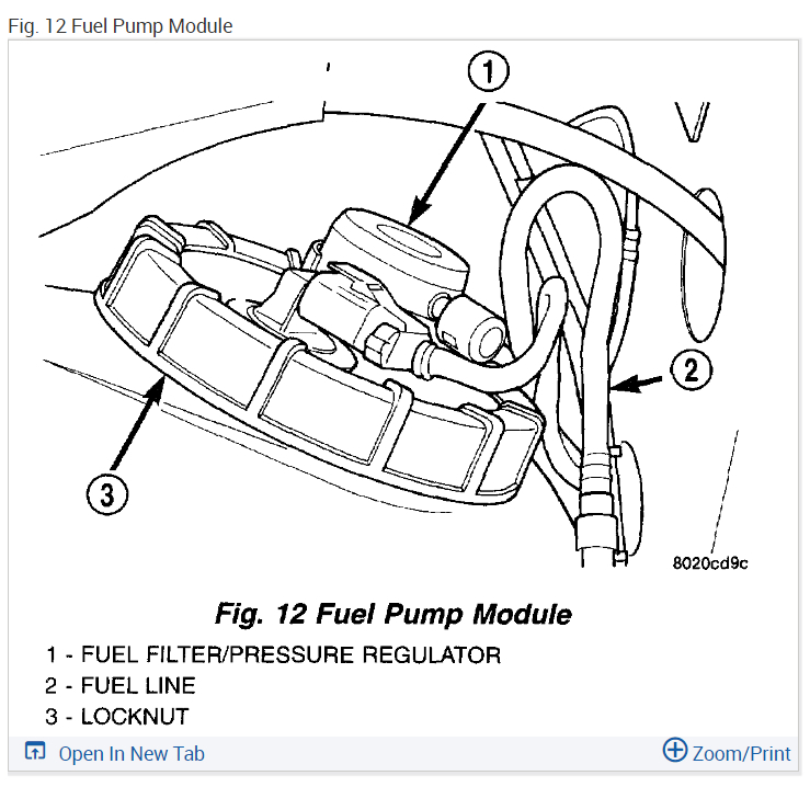

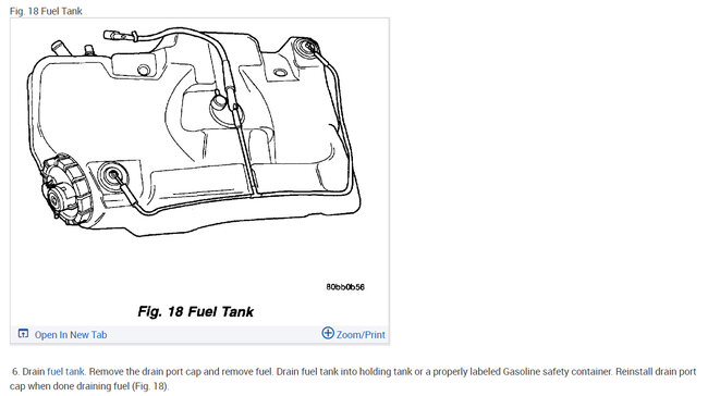

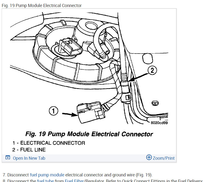

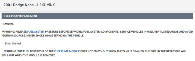

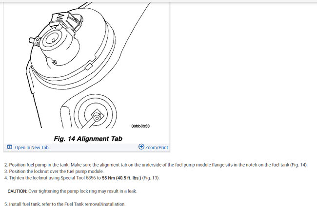

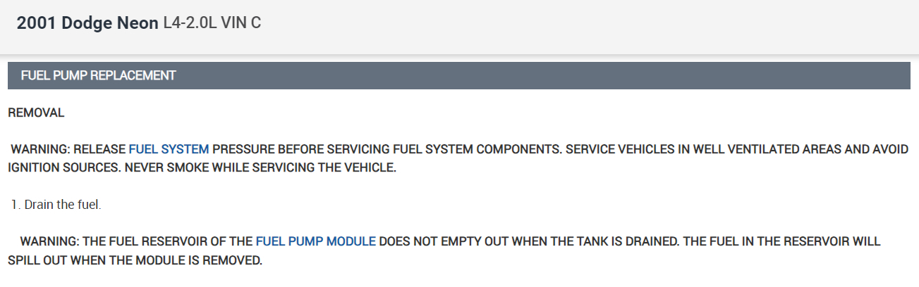

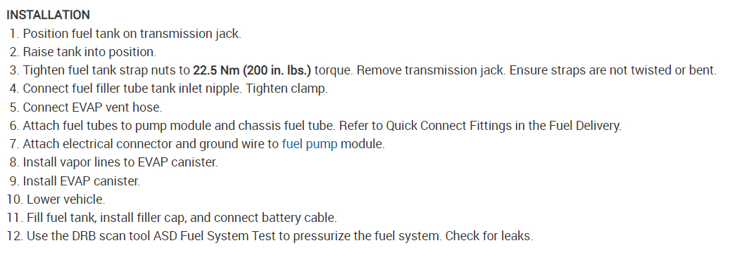

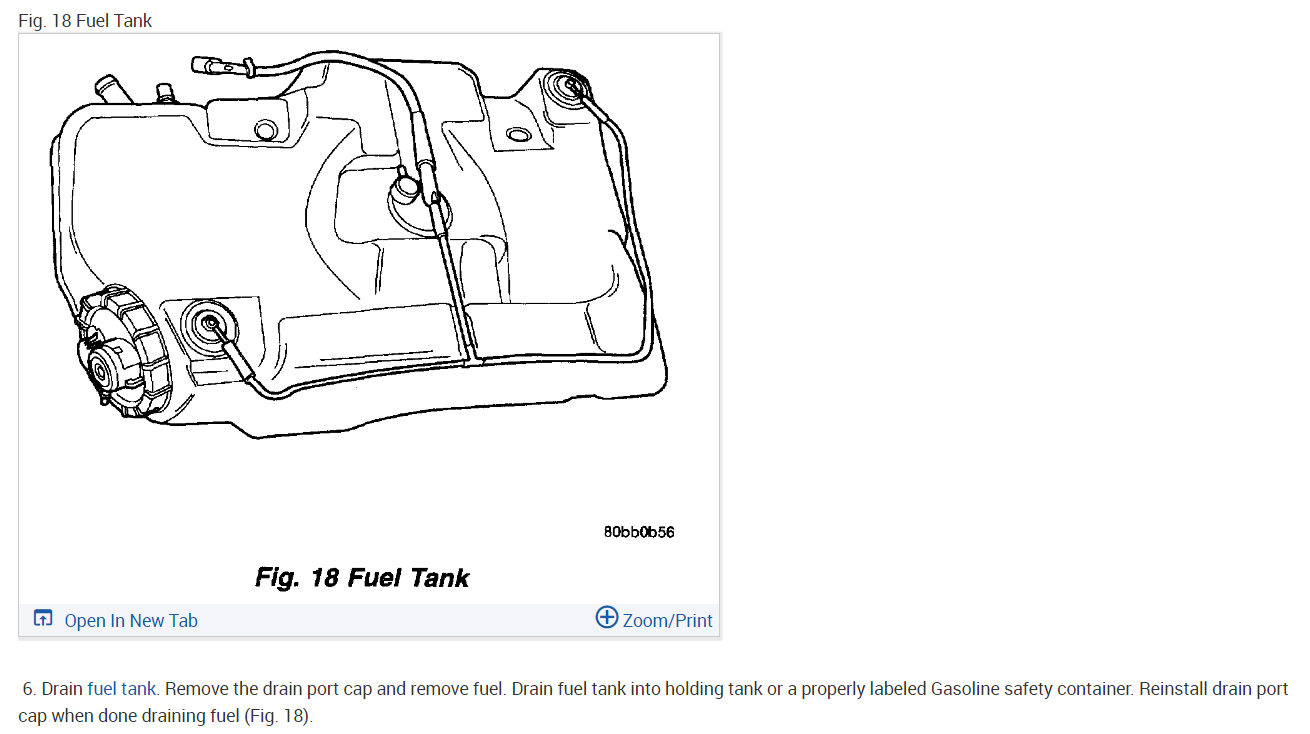

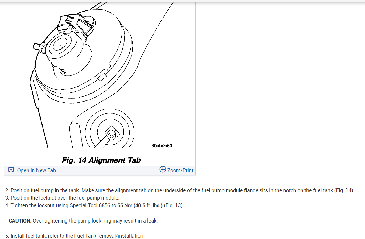

It sounds like the fuel pump is going out and the fuel pump relay is trying to supply power to the fuel pump, here is how to change the fuel pump out which should fix the problem. Check out the images (below). Please let us know what happens.
