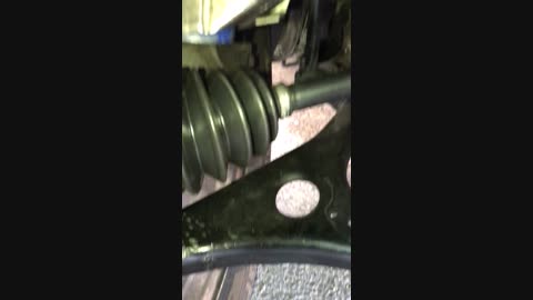

And just as a reminder, in the past year, I have replaced front sway bar links, front lower control arms (with new bushings), all four shocks and struts (with springs pre-installed), rear stabilizer bars, inner and outer tie rods, and just last week had the ball joints and both inner and outer CV axles replaced. All new parts. I just checked for any play in the sway bar links or tie rods, they are as tight as can be, no movement at all.

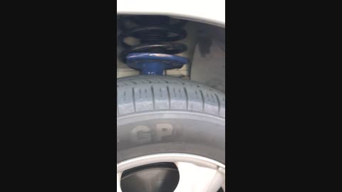

So I pushed the car back and forth with my hands, and the noise is coming directly from the upper portion of the strut. But the mounts look okay, they do not move when I shake the car, and the noise is clear from both the drivers and passengers side. Here is a video of the drivers:

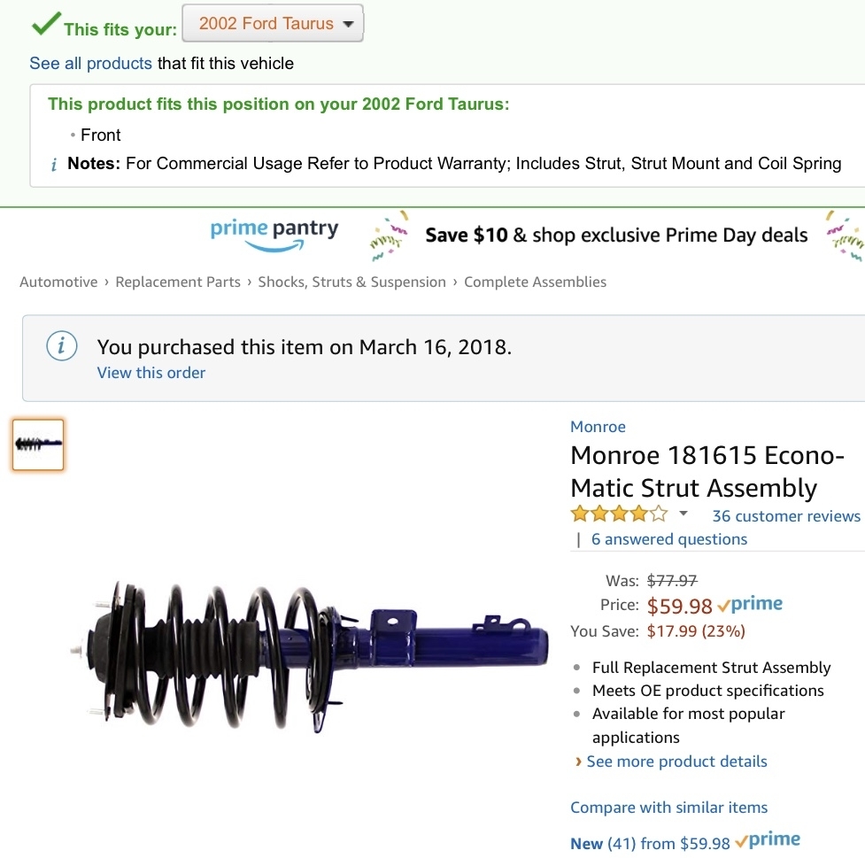

These are brand new struts. Why would it be making that noise?
Tuesday, June 8th, 2021 AT 1:52 PM
JGONZO2398
  • 364 POSTS
These are the front struts I bought. If that helps.

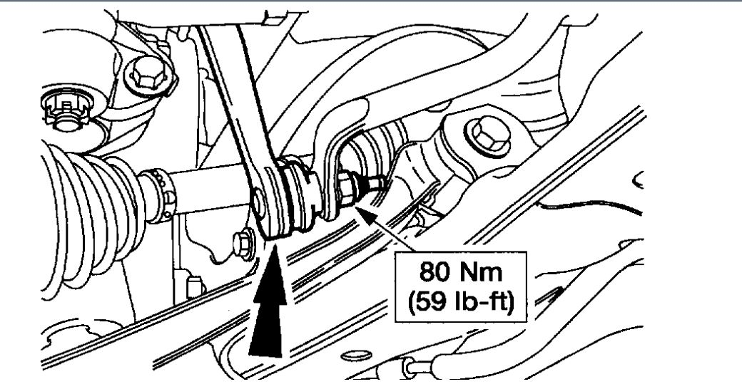

Okay, then check the link that is bolted to the strut. That is the other part I was talking about.
JGONZO2398
  • 364 POSTS
The sway bar, yeah. It does not seem like it is coming from that. I tried moving that part with my hand, shaking it and pulling on it, it does not budge whatsoever.

Have someone bounce that side up and down and see where you can feel the noise.
It has to be pretty obvious.

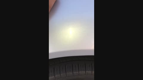

Here is one more time from the drivers side.
  • 52,797 POSTS
Okay, still the same answer.

So just the strut mounts, not the whole part itself?
  • 52,797 POSTS
The part is new so it should be covered under warranty. Just send it back and get a new strut.

Turned out to be the front sway bar links, had my mechanic check it.
