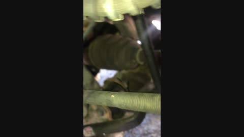

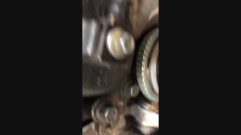

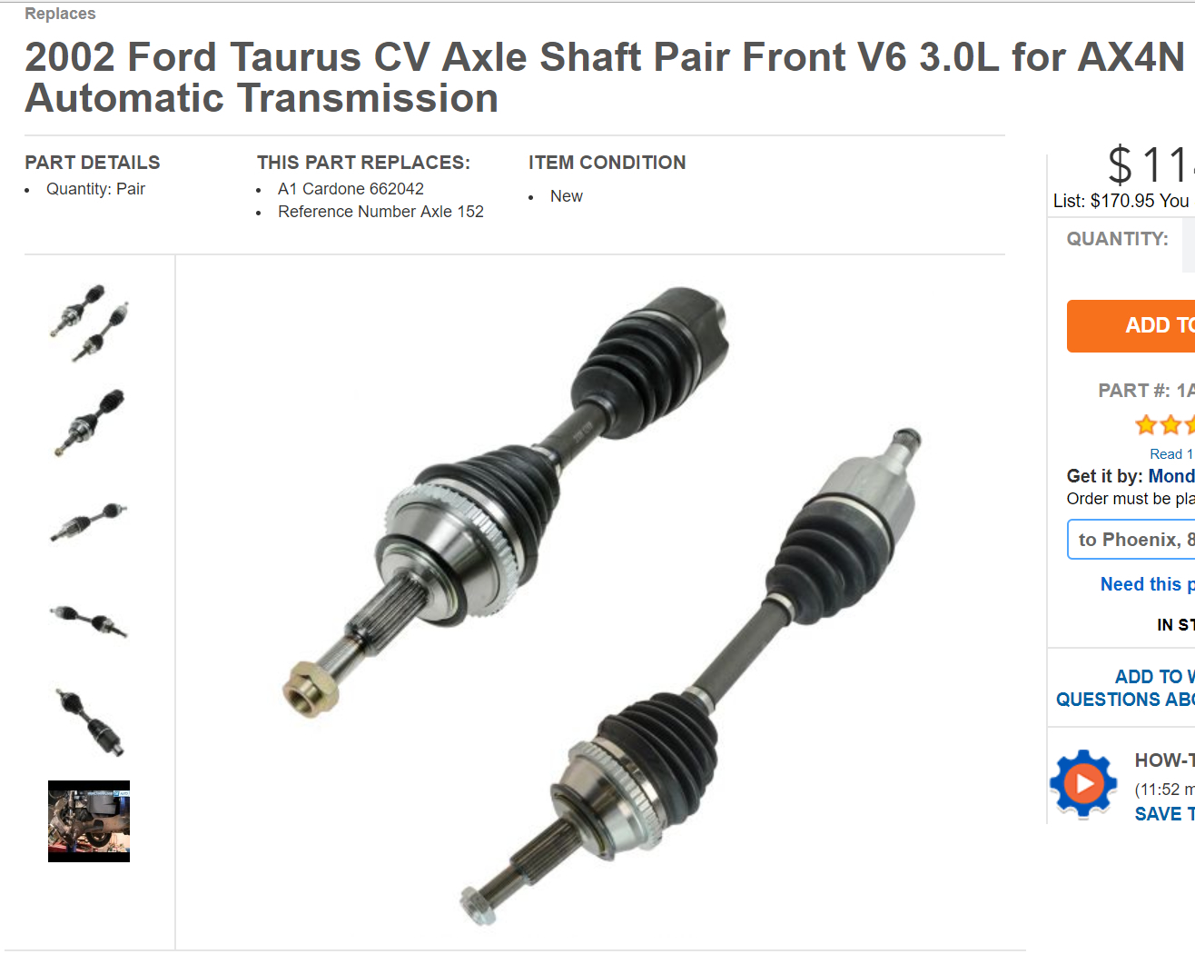

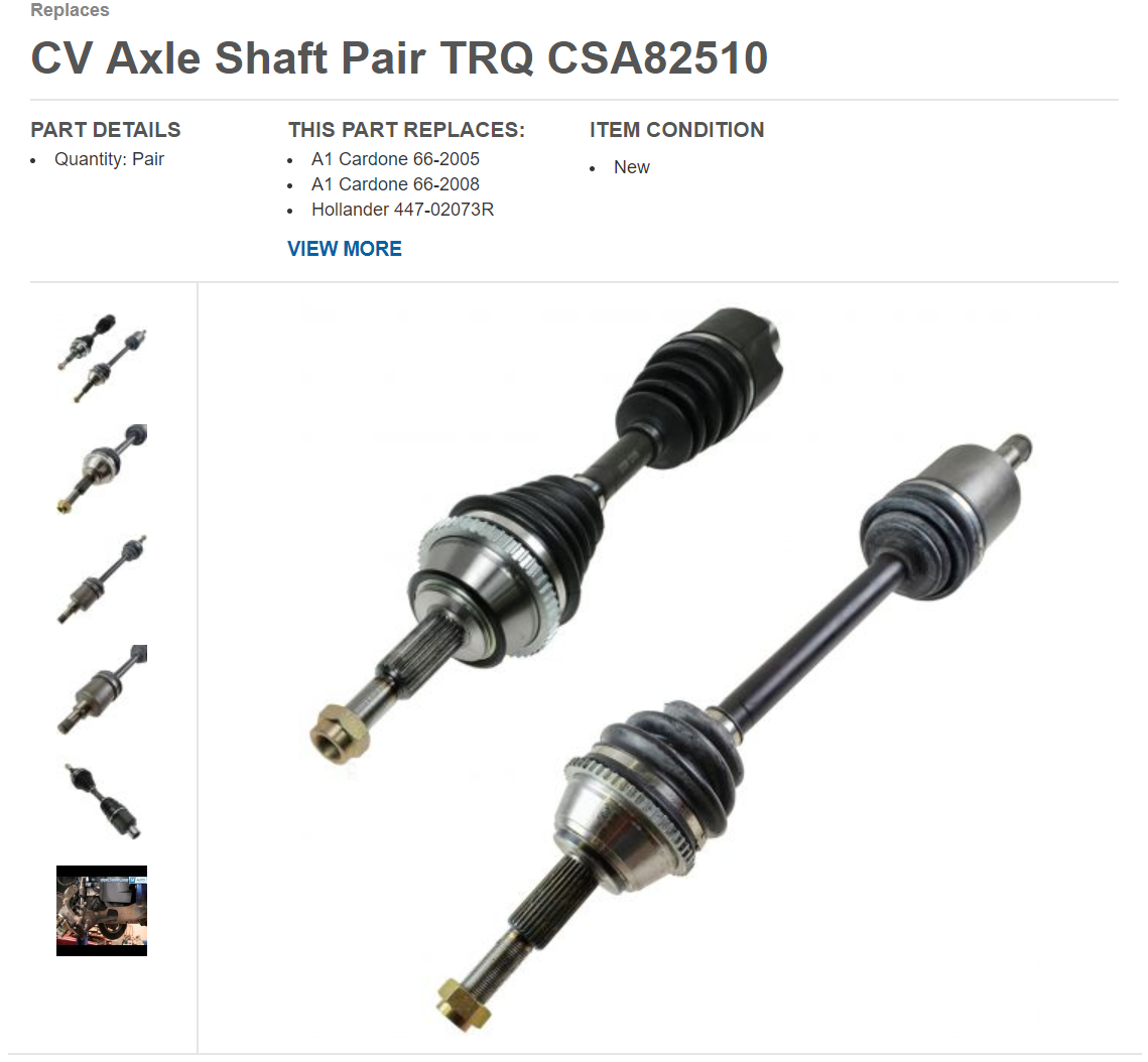

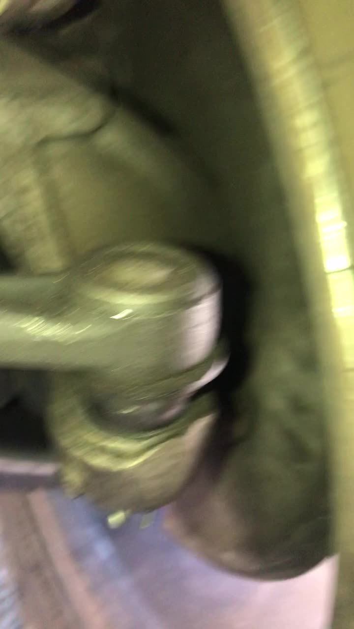

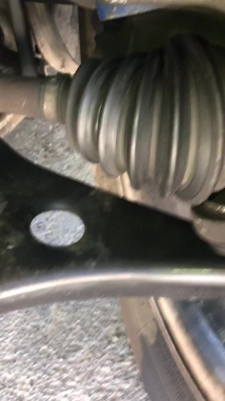

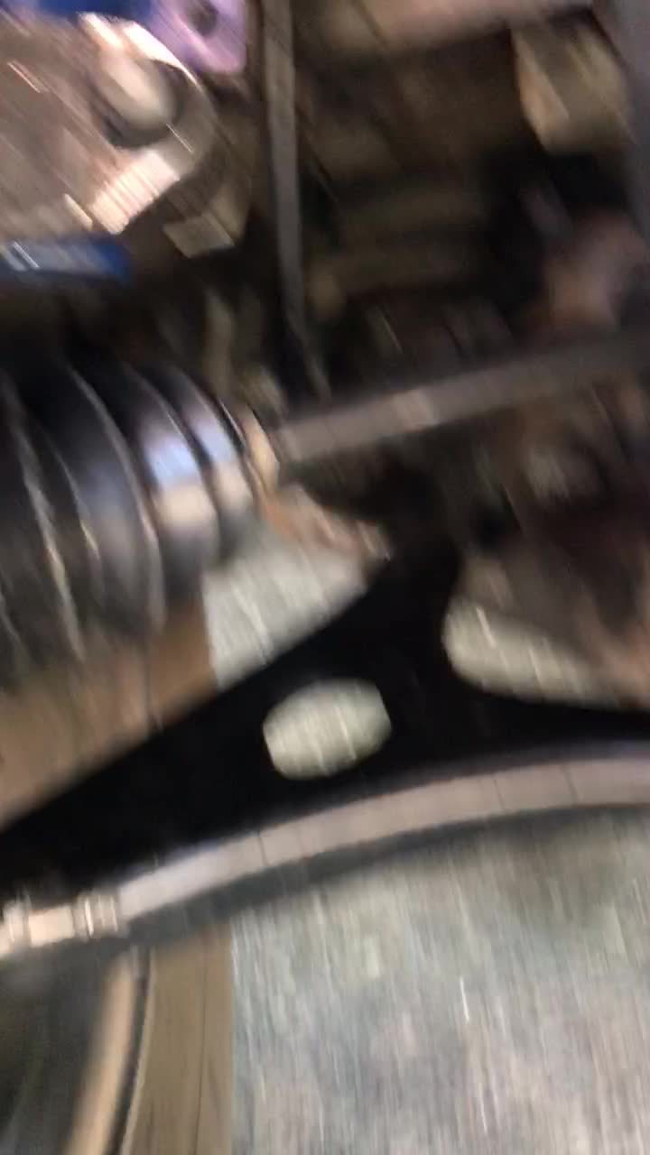

I recently noticed a clicking/clunk sound when turning my steering wheel left. It is very clear, and I am pretty sure it is the CV axles. However, I am looking online for the pair of these, and there is two different sets of them. One is for the AX4N automatic transmission, the other pair I am guessing is for the 4F50N automatic transmission. I believe I have the 4F50N transmission in my car, but the CV axle pair for that type of transmission does not look like the stock CV axles on my car. One of them seems to have a bushing on one end instead of just rubber boots on each end. I took screenshots of both CV axles pairs that I found on 1A Auto, and I also took video of both the axles on my vehicle. All images are posted below.

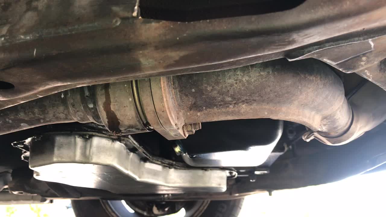

JGONZO2398
  • 374 POSTS
Correction; I just went under my car and cleaned the transmission pan, I have the AX4N metric.

Good afternoon.
Are you looking to replace both axles? I see the pictures you sent and I am wondering what or where you see a problem?

Clicking while turning is a good symptom of a bad outer CV joint. The AX4N and 4F50N are the same basic transmission, just a new name for the newer cars and the 4F50N has a couple extra sensors. The item you see on those is the ABS tone ring. You do not appear to have that on your car, as the sensors and tone rings are not in your videos.
I did not see the normal cracked boot or damage on the boots that causes the grease to escape and destroy the inner bearings but it may have been hidden.
This shows the process on a similar vehicle, you just do not have the intermediate bearings.
https://www.2carpros.com/articles/replace-cv-axle

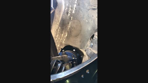

JGONZO2398
  • 374 POSTS

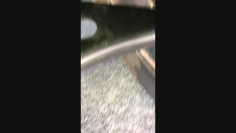

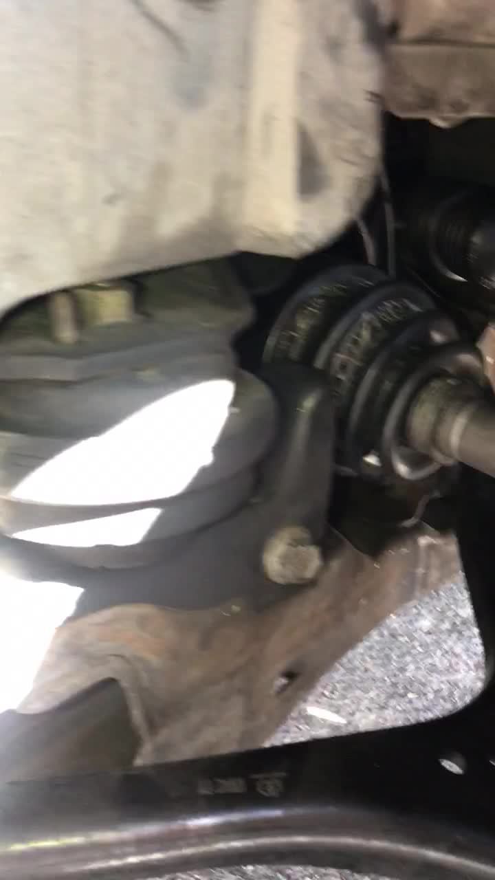

Here is the drivers side.
Jun 8, 2021 at 6:51 AM
JGONZO2398
  • 374 POSTS

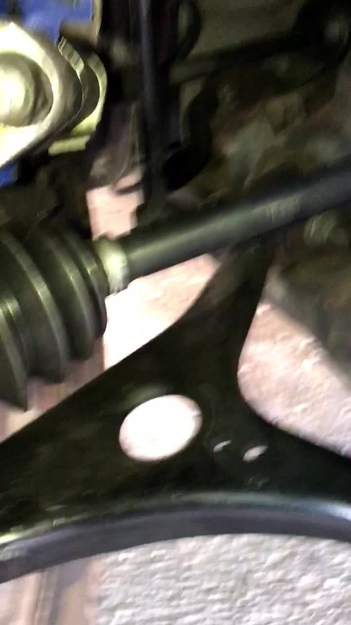

Here is the passengers side.
Okay, it looks all new.
The next area is the cradle bolts and mount bushings. They are 18mm bolts. See if they are good and tight.
Jun 8, 2021 at 6:52 AM

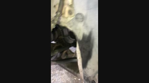

The lower control arms and bolted to the cradle. Look around the cradle and you will find two bolts in the front and two in the rear.
JGONZO2398
  • 374 POSTS

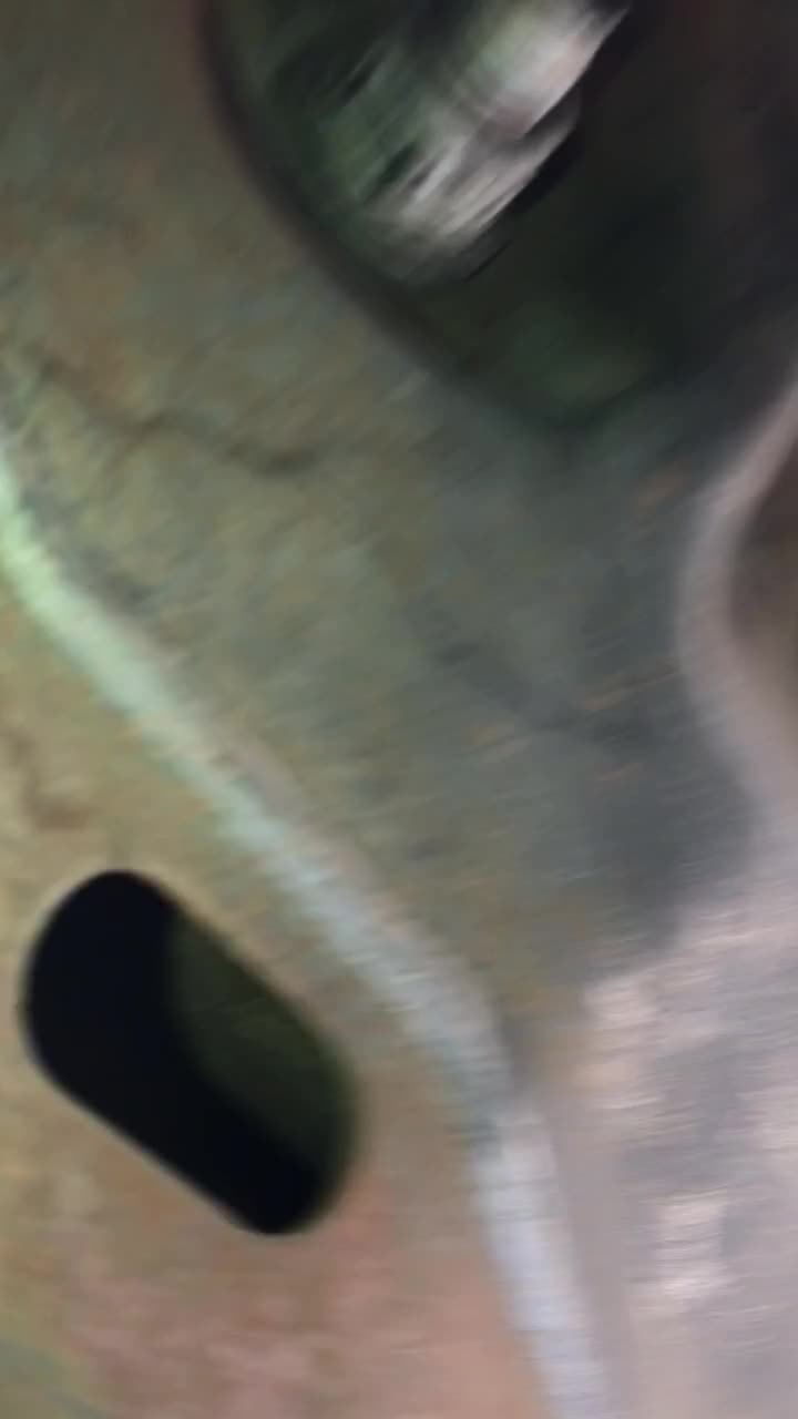

Is this the bolt? This is right under the control arm bushing.
No, that is a nut, not a bolt. It has an 18mm bolt head. They are at the four corners of the frame.

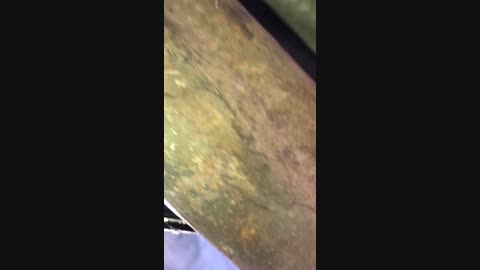

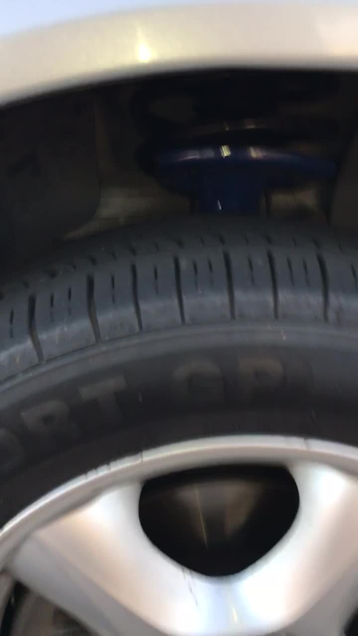

I’m back with a discovery! So I went ahead and starting pushing down on the car, next to each tire, bouncing it up and down with only my hands, there was no noise produced. So I went ahead and opened the front doors, put my feet onto the floor next to the drivers seat, and jumped up and down, no noise (surprisingly, due to the fact that the clunk noise produced when going over bumps and turning the steering wheel left, comes from the drivers side specifically). I did the same procedure on the front passengers side, and voila! Clunking clear as day, hear for yourself, what is this??
JGONZO2398
  • 374 POSTS
Here is me jumping from the outside: drivers side
JGONZO2398
  • 374 POSTS
Passengers side.
JGONZO2398
  • 374 POSTS

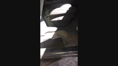

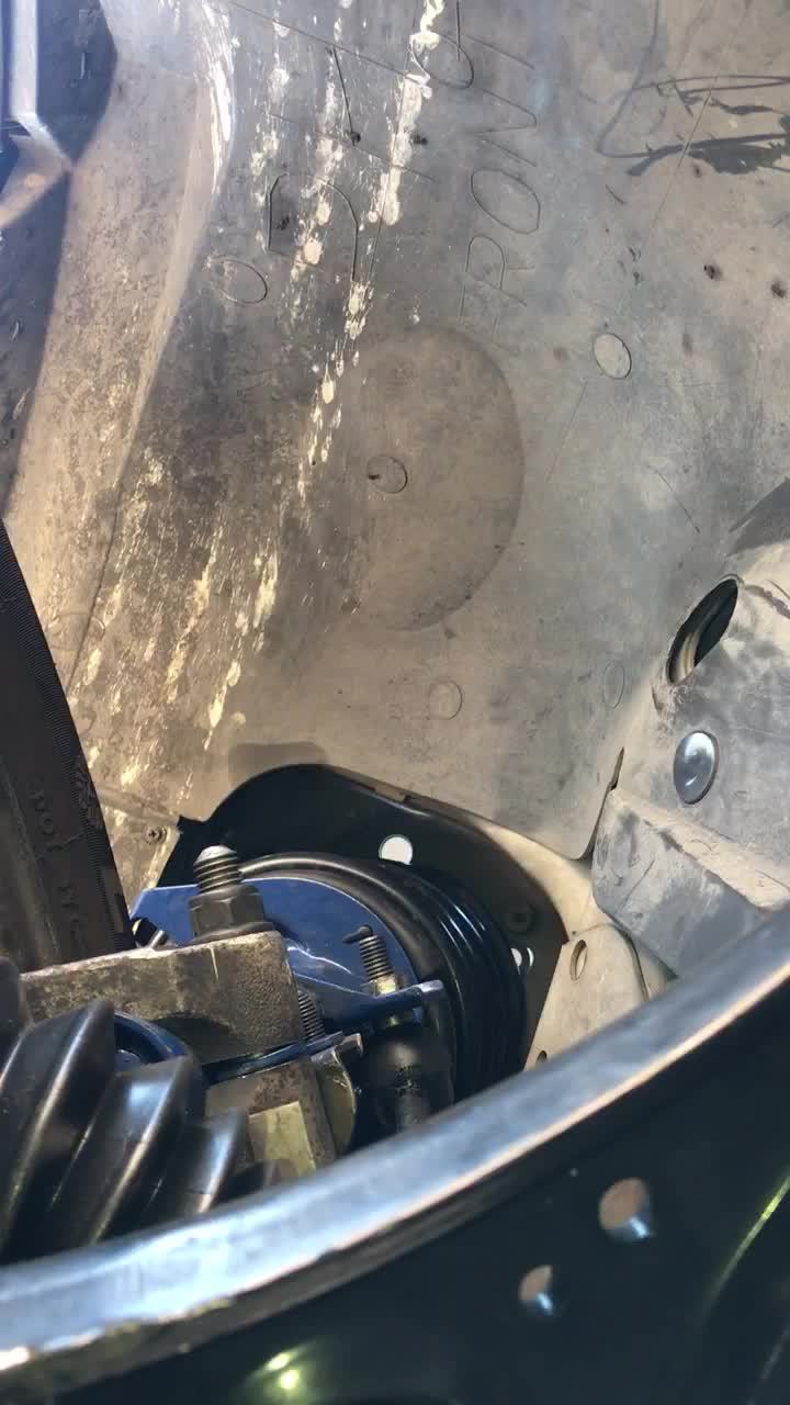

Here is a view right under the front passenger side suspension.

Check the upper strut mount on the strut. See if you can feel the noise there.
Also, check the link kit from the strut to the frame. Two common points of noise like this.
JGONZO2398
  • 374 POSTS

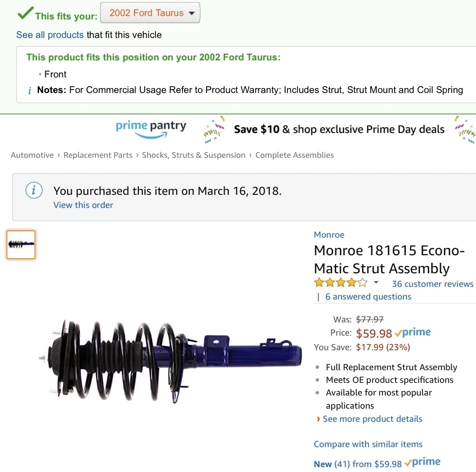

So I pushed the car back and forth with my hands, and the noise is coming directly from the upper portion of the strut. But the mounts look okay, they do not move when I shake the car, and the noise is clear from both the drivers and passengers side. Here is a video of the drivers:
JGONZO2398
  • 374 POSTS
These are brand new struts. Why would it be making that noise?
JGONZO2398
  • 374 POSTS
These are the front struts I bought. If that helps.
JGONZO2398
  • 374 POSTS
I went ahead and tried to tighten the nuts on the upper strut mount, but they are as tight as they can be.

Okay, then check the link that is bolted to the strut. That is the other part I was talking about.

  • 374 POSTS
The sway bar, yeah. It does not seem like it is coming from that. I tried moving that part with my hand, shaking it and pulling on it, it does not budge whatsoever.

Have someone bounce that side up and down and see where you can feel the noise.
It has to be pretty obvious.
