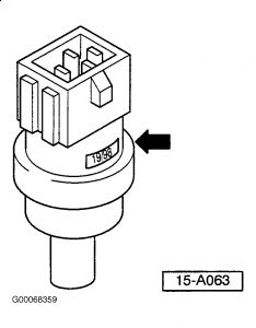

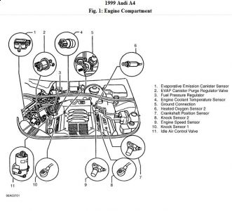

Hello Harvey. The CKP especially has a tendancy when dirty or worn to send bad or no signals to PCM when at higher temps .. then when cool seems OK .. I was an RAC tech for 10 years and have seen it hundreds of times and not just on audi's The temp sensor TSB relates to crank no start at any temperature .. and then also goes on to say if no fault is found on ECT sensor then check thermostat/injectors/fuel pressure/compression .. you could check the ECT sensor !also the TSB state that the dates for Bad sensors after week 19 of 1998 !! check your sensor for this # or after (ie.) 20/1998
https://images.2carpros.com/forum/automotive_pictures/266999_audi_6.jpg
https://images.2carpros.com/forum/automotive_pictures/266999_audi2_2.jpg
Hope this helps ..let me know
https://images.2carpros.com/forum/automotive_pictures/266999_AAA2_270.png
