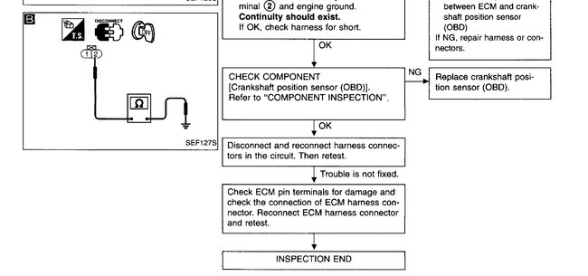

The distributor is known to be good, it was working when it was removed, I bought a spare one in case of a breakdown beside the road. I put the new one on for warranty reasons.
I like keeping extra parts for my truck, like alternators and distributors and so on .
I know how to install it. I have some knowledge in vehicle repair .
The truck was quitting on me again today, it's like you turn the key off at times but sometimes it gradually starts dropping the idling then all at once it jumps to zero miles per hour.
The coil is inside of the distributor and I think the cam shaft position sensor is in there also.
I'll try to get that distributor on in the next few days, I have a friend that will do it for me but I'll watch him to make sure. Let you know how it goes. thanks

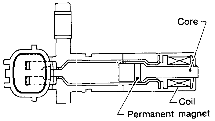

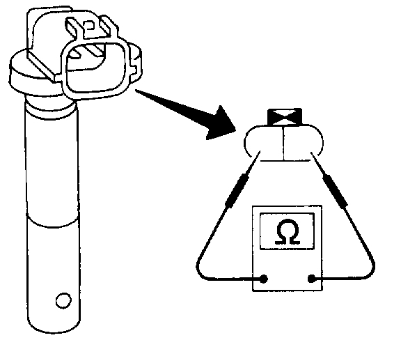

It might still be my IACV-AAC, Since it's an aftermarket, truck ran a little better today,
Reset the IAC valve pintle position by performing the following:
Depress the accelerator pedal slightly.
Start the engine and run for 5 seconds.
Turn the ignition switch to the "off" position for 10 seconds.
Restart the engine and check for proper idle operation.
www.autozone.com › ELECTRONIC-ENGINE-CONTROLS › Idle-Air-...
Idle Air Control (IAC) Valve Repair Guide - Repair Guides
Search for: How do I reset my idle air control valve?
How many ohms should a IAC valve have?
Using an ohmmeter, measure the resistance between pins 1 and 2 on the IAC valve. Resistance should be 10-14 ohms. If resistance is okay, proceed to the next step. If resistance is out of range, replace the IAC and retest.

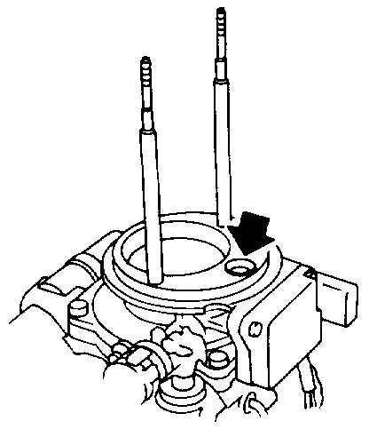

It's not fixed yet, drove it tonight doing about the same thing but it isn't quitting as much but it did once tonight. I looked on Ebay for a mounting throttle body gasket and emailed a seller about if the one he had advertised would fit this truck and haven't heard from the seller yet.
It's been raining here and more tomorrow. I'm going to take the throttle body off again and use some liquid tape to put on the metal vacuum lines to make sure there's no leaks there , going to recheck each vacuum line for leaks . Sooner or later the problem will be resolved.

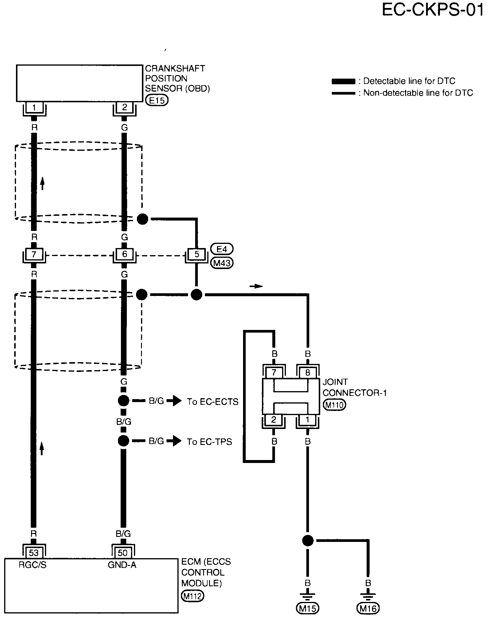

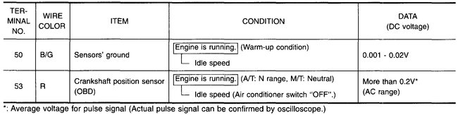

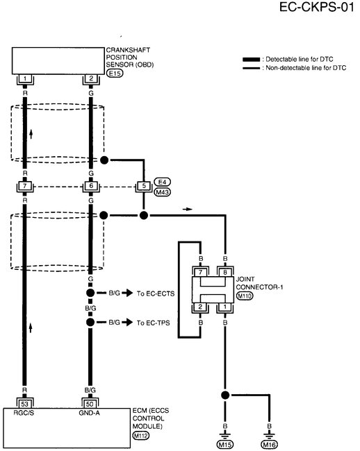

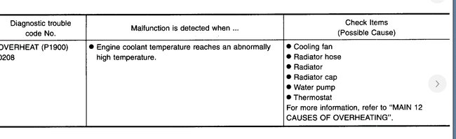

On page EC 300 in the Nissan service manual it talks about overheating maybe I understood it wrong in my memory, I tried to copy ( EC 300 ) and send to you but it wouldn't allow me to.
Feb 12, 2020 at 12:31 PM
UHSNOEBIRD
  • 342 POSTS
DTC 1900 is the code.
Feb 12, 2020 at 12:55 PM
  • 110,244 POSTS
That code is related to the ECT. See the attached.

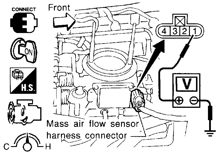

I've replaced the ECT sensor plus I bypassed the plugin for the IACV and directly plugged the wires in to the plug in and my truck is flooding out so bad it will not run on it's own without me giving it some throttle.It was flooding before I bypassed the plugin. I should get the new IACV tomorrow, not sure if I can get it on since it's going to rain. Yesterday I unplugged the IACV plugin ( while it was running to see what would happen ) and later when I checked the codes it had p0505 & p0100 ( mass air flow sensor ). I erased both of those codes and it has no check engine light on now..
Can the mass air flow sensor be bad and not give a code all the time or do you know?
Feb 17, 2020 at 7:31 AM
  • 110,244 POSTS
I would think it would throw a code. However, if it is dirty, that can cause issues. Have you tried cleaning it? The 505 is related to the IACV again. If the MAF is bad, it can be causing this. Here are the directions for testing the IACV. The two attached pics correlate with the directions.
____________________________________
1997 Nissan-Datsun Truck D21 Hardbody SE King Cab 2WD L4-2389cc 2.4L SOHC MFI (KA24E)
Component Testing Procedure
Vehicle Powertrain Management Fuel Delivery and Air Induction Sensors and Switches - Fuel Delivery and Air Induction Air Flow Meter/Sensor Testing and Inspection Component Tests and General Diagnostics Component Testing Procedure
COMPONENT TESTING PROCEDURE
COMPONENT INSPECTION
Mass Air Flow Sensor
1. Turn ignition switch "ON".
2. Start engine and warm it up sufficiently.
pic 1
3. Check voltage between terminal 1 and ground.
Conditions / Voltage, V
Ignition switch "ON" (Engine stopped.) / Less than 1.0
Idle (Engine is warmed-up sufficiently.) / 1.3 - 1.7
2,500 rpm / 1.7 - 2.3
Idle to about 4,000 rpm / 1.3 - 1.7 to Approx. 4.0
*: Check for linear voltage rise in response to increases to about 4,000 rpm in engine speed.
pic 2
4. If NG, remove mass air flow sensor from air duct. Check hot wire for damage or dust.
Let me know if that helps.
