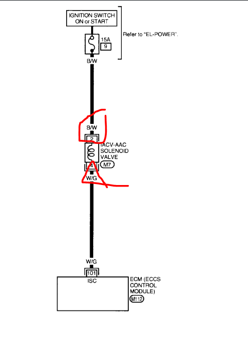

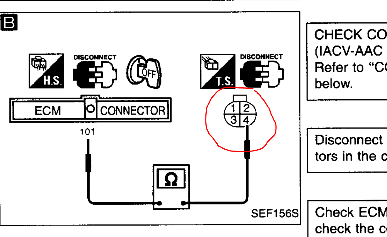

When replacing the IACV (intake air control valve) are one of the wires ground and the other one the hot wire?
The colors of the wires for my replacement valve were both black. I'm not sure if it matters which one goes where. If it does tell me. My truck is still occasionally acting up like it did before I replaced this valve. I had the code P0505 before I replaced this valve . Thank you
Jan 12, 2020 at 1:06 PM
  • 110,194 POSTS
Take a look at the pics. First, I have a pic of the harness. There are two pins used of the four. Pin 2 should have battery voltage with the key on. That should be the black and white wire from the ignition. The other wire goes to pin 4.
Let me know if this helps.

I'm getting 12 volts to the black/white wire at the no. 2 pin but the aftermarket IACV has both wires that are the color of black so I don't know if one of them is suppose to be a hot wire and theother one a ground wire but my truck is doing the same thing, when the motor warms up it wants to drop the idling at times and sometimes quit unless I catch it and press the gas pedal and it will start back running right for maybe a few minutes or so and that varies on if it will run or not. When my truck is cold it runs great.What's got me confused is the wire colors on the new after market IACV .Does it matter which wire goes to the b/w connection. Let me know. Thank you

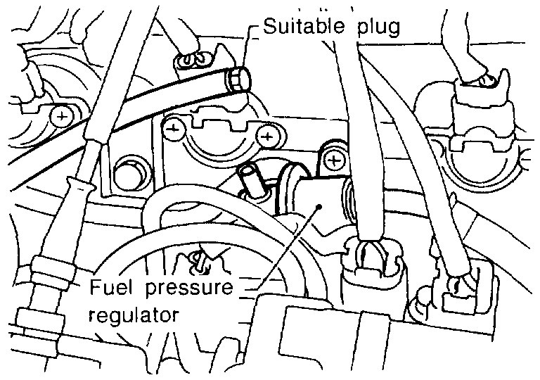

If you were seeing black smoke, that indicates a rich fuel mixture. Have you checked fuel pressure to make sure the regulator is working?

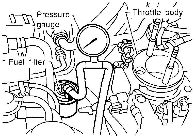

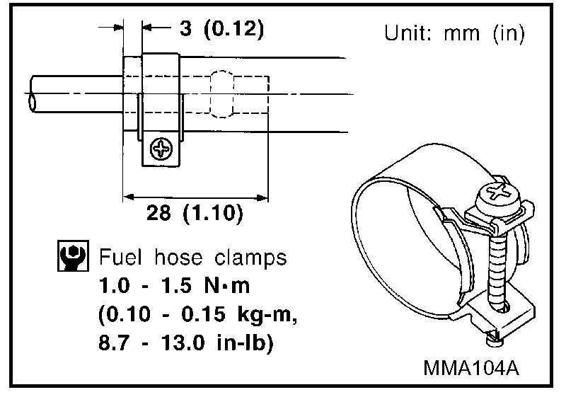

Here is a link that shows in general how to test fuel pressure. I attached a picture of the regulator location. Lets do this to see if this is the issue.
Here are the directions for testing specific to your vehicle. The remaining pictures correlate with the directions. Also, the specifications are listed in the directions.
_______________________________________
1997 Nissan-Datsun Truck D21 Hardbody XE 2WD L4-2389cc 2.4L SOHC MFI (KA24E)
Fuel Pressure Check
Vehicle Powertrain Management Service and Repair Procedures Fuel Pressure Check
FUEL PRESSURE CHECK
PROCEDURE
pic 2
a. When reconnecting fuel line, always use new clamps.
b. Make sure that clamp screw does not contact adjacent parts.
c. Use a torque driver to tighten clamps.
d. Use Pressure Gauge to check fuel pressure.
1. Release fuel pressure to zero.
2. Disconnect fuel hose between fuel filter and fuel tube (engine side).
pic 3
3. Install pressure gauge between fuel filter and fuel tube.
4. Start engine and check for fuel leakage.
pic 4
5. Read the indication of fuel pressure gauge.
At idling: Approximately 235 kPa (2.4 kg/sq. cm, 34 psi)
A few seconds after ignition switch is turned OFF to ON:
Approximately 294 kPa (3.0 kg/sq. cm, 43 psi)

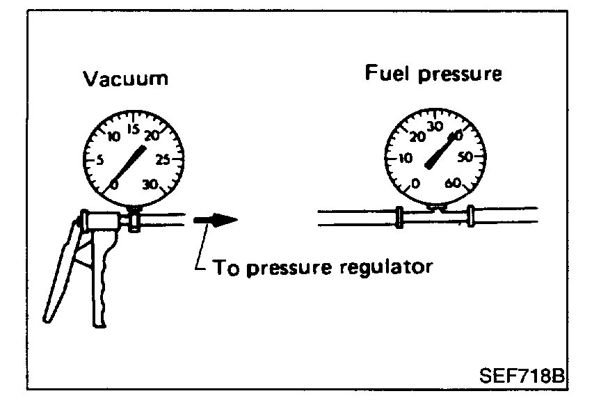

6. Stop engine and disconnect fuel pressure regulator vacuum hose from intake manifold.
pic 5
7. Plug intake manifold with a rubber cap.
8. Connect variable vacuum source to fuel pressure regulator.
9. Start engine and read indication of fuel pressure gauge as vacuum is changed.
Fuel pressure should decrease as vacuum increases. If results are unsatisfactory, replace fuel pressure regulator.

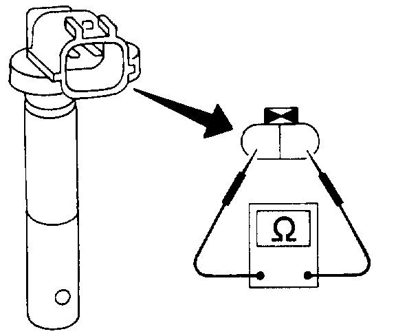

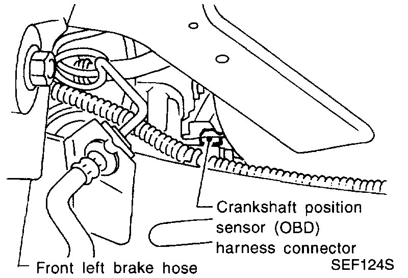

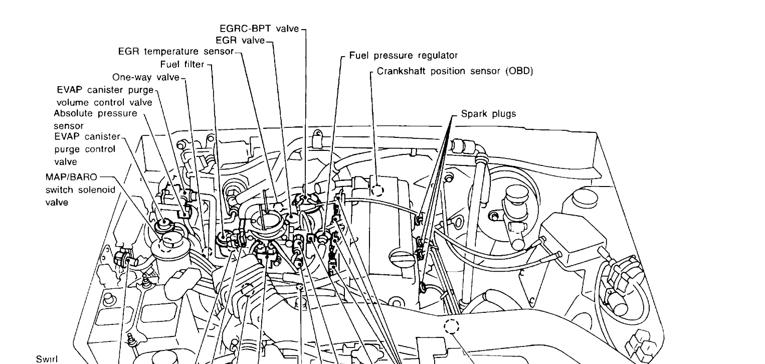

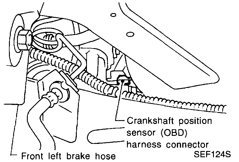

The pressure sounds perfect. Do me a favor. I want you to check the crankshaft position sensor. Here are the directions. The attached pics correlate with the directions. Interestingly, under certain conditions, the sensor can cause misfire, stalling, no start and so on without setting a code.
Component Testing Procedure
Vehicle Powertrain Management Sensors and Switches - Powertrain Management Sensors and Switches - Computers and Control Systems Crankshaft Position Sensor Testing and Inspection Component Tests and General Diagnostics Component Testing Procedure
COMPONENT TESTING PROCEDURE
COMPONENT INSPECTION
Crankshaft position sensor (OBD)
1. Disconnect crankshaft position sensor (OBD) harness connector.
2. Loosen the fixing bolt of the sensor.
3. Remove the sensor.
pic 1

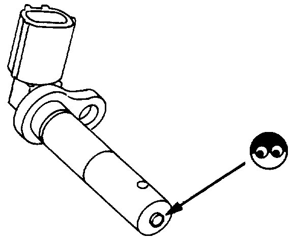

4. Visually check the sensor for chipping.
pic 2
5. Check resistance as shown in the figure.
Resistance: Approximately 166.5 - 203.5 ohms at 20°C (68°F)
Let me know if you have a chance to do that.

I'll do that, I have knowledge on using multi-meters and other things relating to that.
I'll see how the weather is tomorrow and see what I can do, that sensor sits behind the motor in front of the transmission near the top , I had one put on it one time a few years. back. Thanks
Jan 18, 2020 at 5:59 PM
  • 110,194 POSTS
Exactly, that's the one. Please let me know what you find. Also, can you confirm something for me. Originally, you listed this as a 2.0L. They only made it with a 2.4L. I am using info for that. Let me know.
Jan 18, 2020 at 6:03 PM

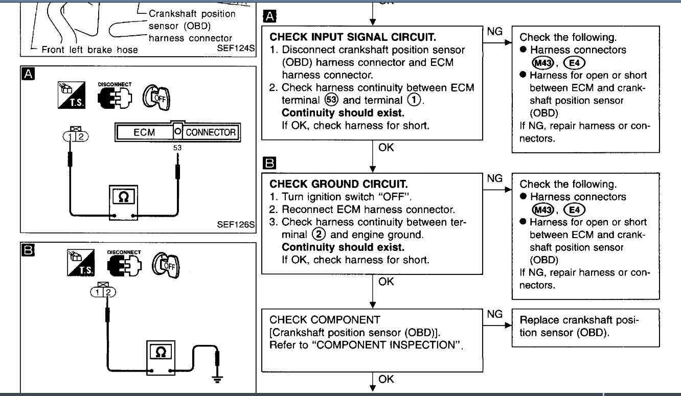

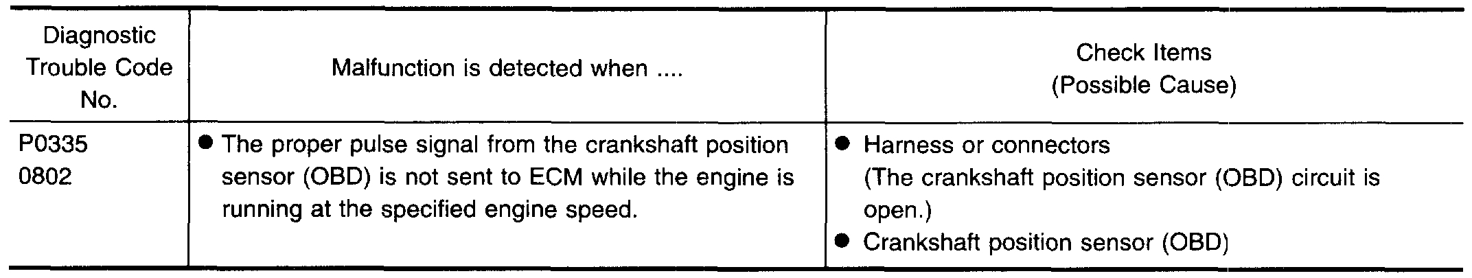

Wouldn't I get a check engine light with one of these codes if my crank sensor was bad ?
These are codes are related to my truck:
P0335, p0337, p0338 and p0339.
Jan 19, 2020 at 6:23 AM
UHSNOEBIRD
  • 342 POSTS
P0335 = Crankshaft position sensor " A " circuit
P0337 = CPS "A " circuit low input
P0338 = CPS " A ' circuit high input
P0339 = CPS " A " circuit intermittent
This is some information I found
What are your thoughts on this, Let me know. Thanks

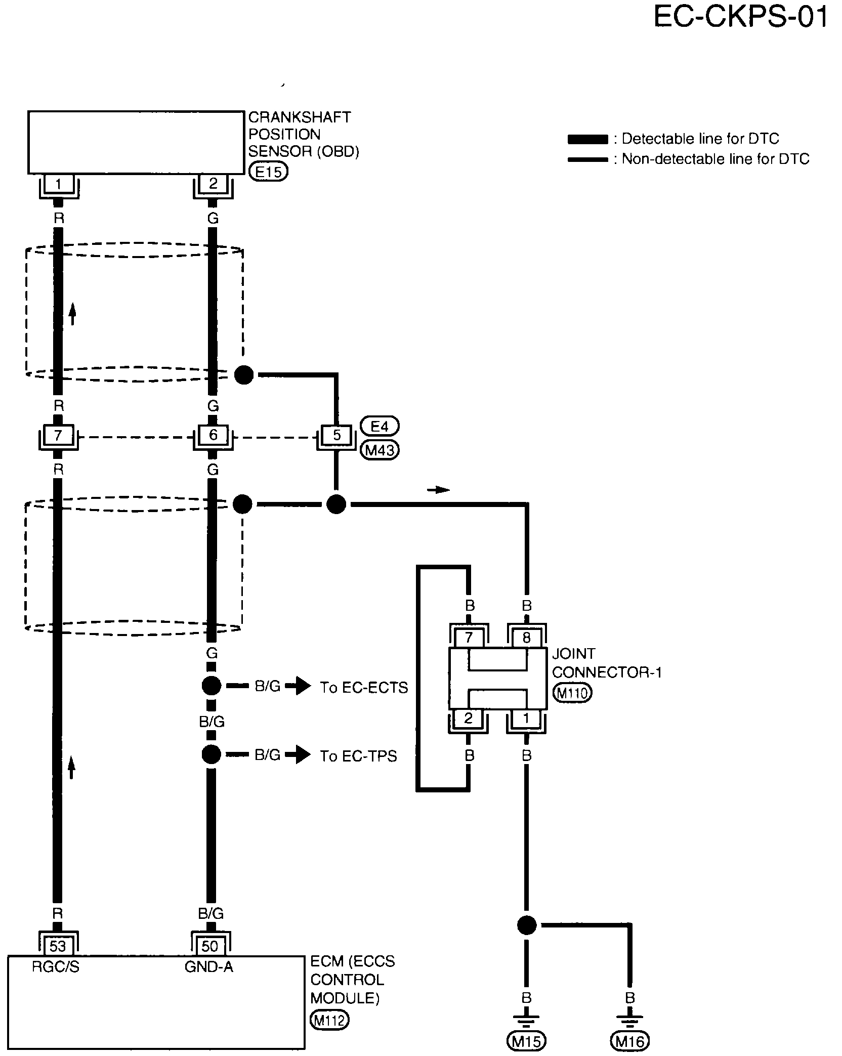

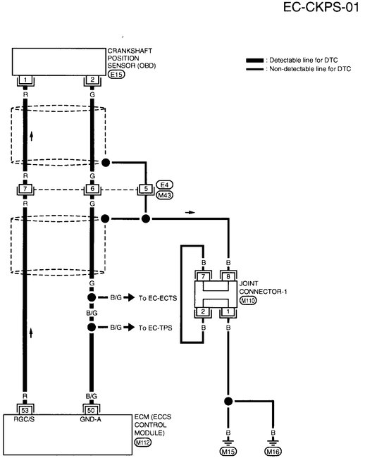

Shouldn't I be able to connect an ohmmeter to the wires on the computer that run to the crank position sensor and check it that way ? The computer is underneath the passenger seat . What are your thought on that , Joe ? thanks for your answers.
Jan 19, 2020 at 2:17 PM
  • 110,194 POSTS

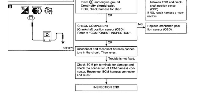

Yes, you could have a leak at the TB. Interestingly, I have even see the leak be at the throttle plate where it attaches on the throttle body. As far as the ECT, yes it could be failing as well and what you described is totally possible.

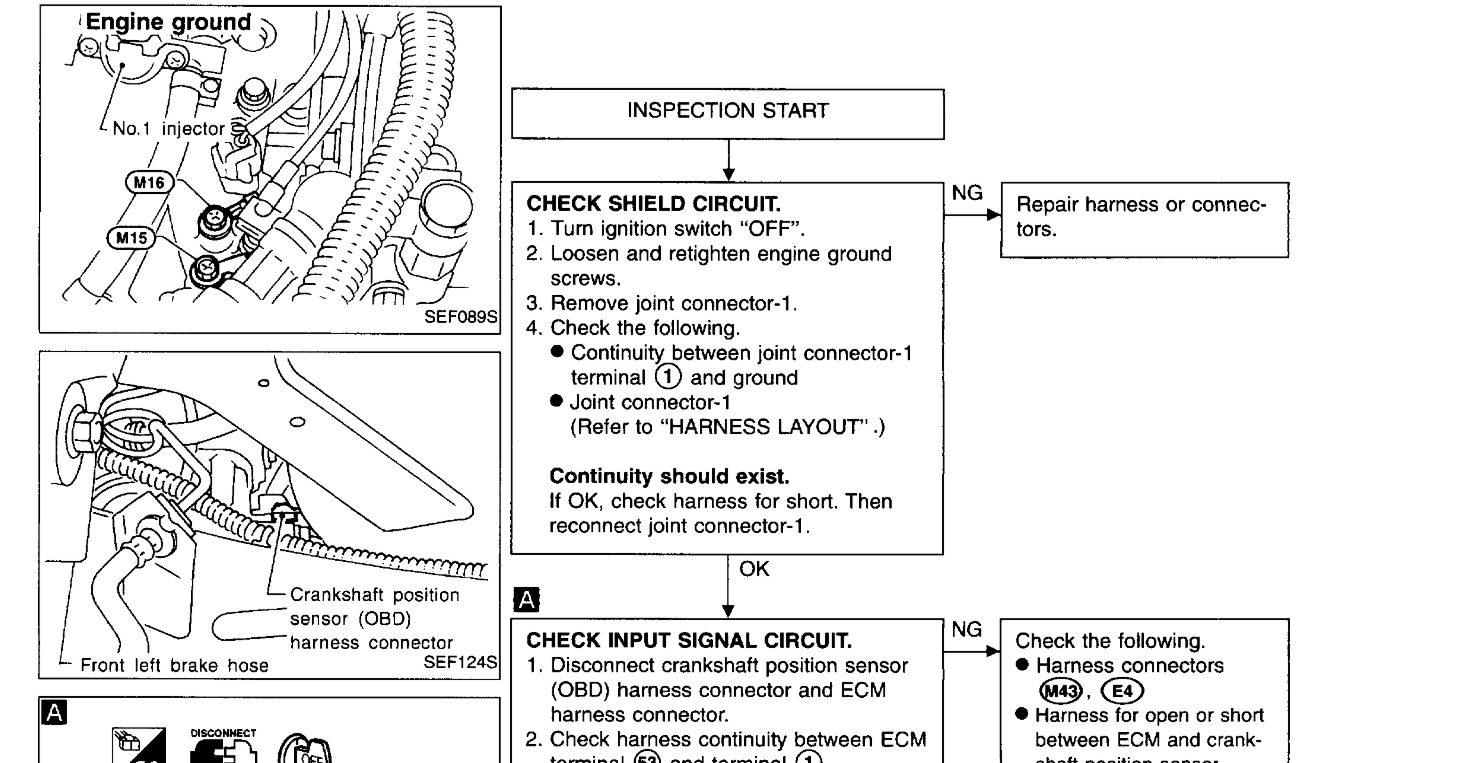

The idea of the codes you have point to an issue with the crank sensor. I don't know if you're up for it, take a look through this diagnostic flow chart and see if it helps. The attached pics correlate with the directions. There was one pic I had to break into three parts so you could follow and read it, but I made sure to overlap it so you can use it.
P0335
Vehicle ALL Diagnostic Trouble Codes ( DTC ) Testing and Inspection P Code Charts P0335
P0335
pic 1
pic 2

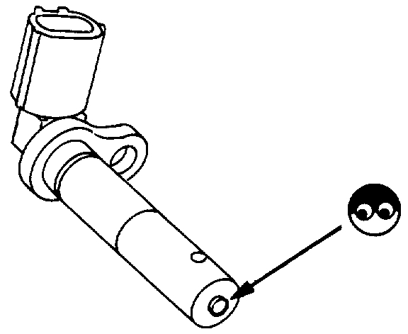

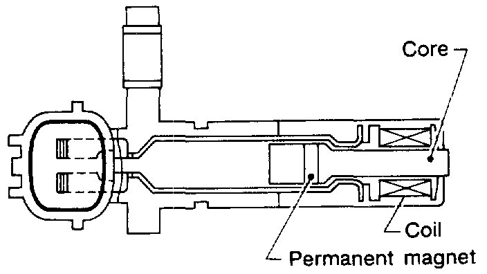

COMPONENT DESCRIPTION
The crankshaft position sensor (OBD) is located on the transmission housing facing the gear teeth (cogs) of the flywheel or drive plate. It detects the fluctuation of the engine revolution.
The sensor consists of a permanent magnet, core and coil.
When the engine is running, the high and low pans of the teeth cause the gap with the sensor to change.
The changing gap causes the magnetic field near the sensor to change.
Due to the changing magnetic field, the voltage from the sensor changes.
The ECM receives the voltage signal and detects the fluctuation of the engine revolution.
This sensor is not used to control the engine system. It is used only for the on board diagnosis of misfire.
pic 3

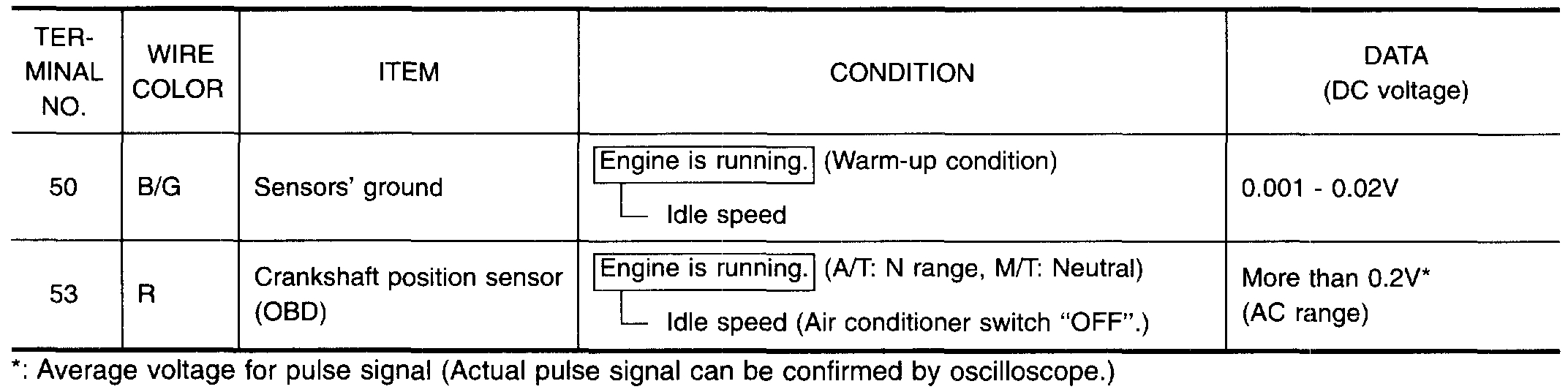

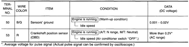

ECM TERMINALS AND REFERENCE VALUE
Specification data are reference values and are measured between each terminal and (43) (ECCS ground).
pic 4

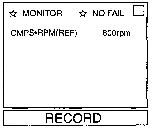

ON BOARD DIAGNOSIS LOGIC
DIAGNOSTIC TROUBLE CODE CONFIRMATION PROCEDURE
With CONSULT
pic 5
(1)Turn ignition switch "ON" and select "DATA MONITOR" mode with CONSULT.
(2)Start engine and run it for at least 10 seconds at idle speed.
OR
With GST
(1)Start engine and run it for at least 10 seconds at idle speed.
(2)Select "MODE 7" with GST.
OR
NO TOOLS
(2)Turn ignition switch "OFF", wait at least 7 seconds and then turn "ON".
(3)Perform "Diagnostic Test Mode II (Self-diagnostic results)" with ECM.
EC-CKPS-01 Crankshaft Position Sensor (CKPS) (OBD) (DTC P0335)
pic 6

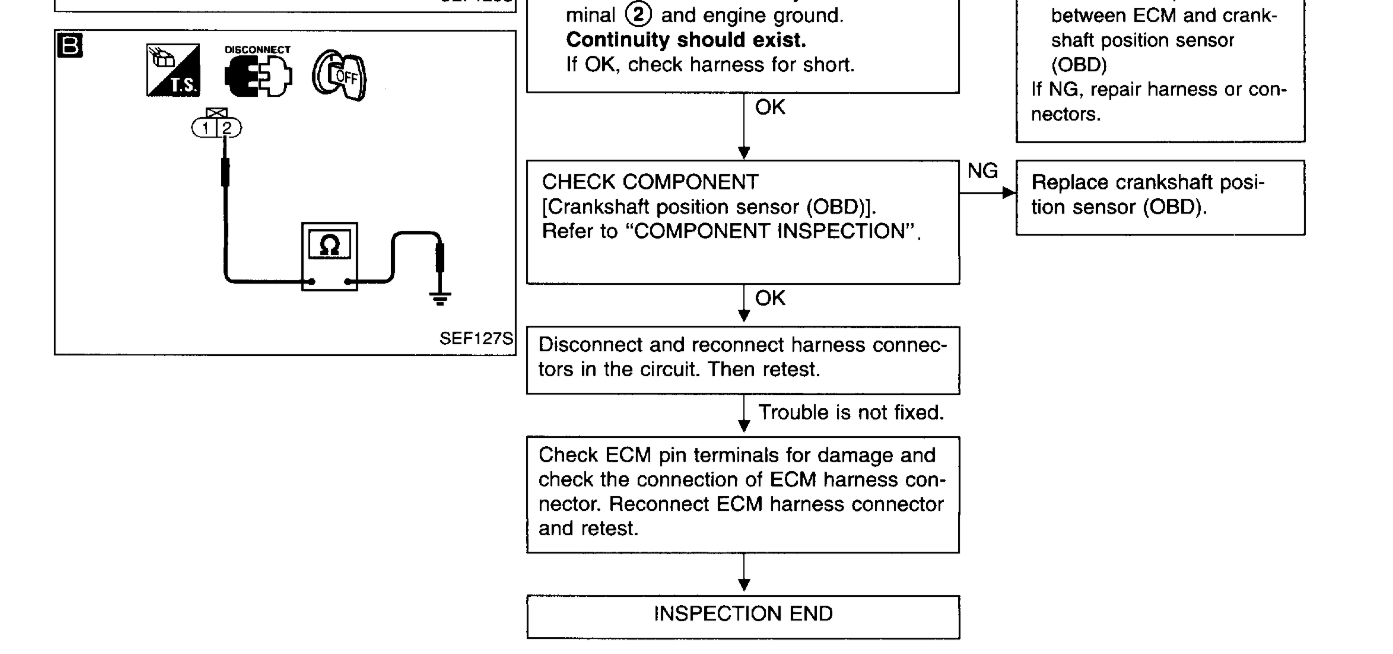

WIRING DIAGRAM
pic 7, 8, 9
DIAGNOSTIC PROCEDURE
pic 10
pic 11
Let me know if you can do this.

Joe, can't I take the plug in off the computer and take an ohmmeter and check the wires going to the crank position sensor that come from the pins 50 and 53 on the computer and check the resistance of that CPS sensor that way?
Jan 20, 2020 at 8:07 PM
UHSNOEBIRD
  • 342 POSTS
Joe, if that crank position sensor is bad shouldn't the check engine light be on and when I connect a diagnostic scanner it should give me the code P0335 if it's bad ? Just double checking.

Yes, you can test it that way. However, make sure the battery is disconnected both before unplugging the PCM and plugging it back in. Once you finish the test, reinstall the connector and then connect the battery.
In most cases, the crank sensor will set a code. However, under some conditions, it won't. Take a look through this link. Start at paragraph three.

I've got a crank position sensor ordered just in case I need it, be Monday before I receive it. This might be the problem because my truck keeps wanting to quit during idling. I will let you know the outcome. Take care
Jan 22, 2020 at 8:00 PM
UHSNOEBIRD
  • 342 POSTS
Joe, I received and installed crank position sensor and the truck is running fine. drove it about 20 miles and everything seems okay.
It quit on me one time while I was idling and in a turn going slow but I think that part fixed it. I will follow up on this in a few days to fill you in. Thanks for your help!
