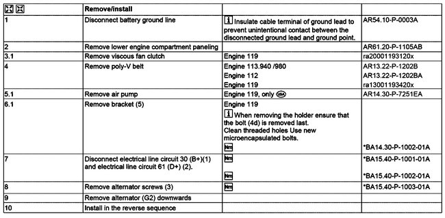

I am curious about difficulty and any advice about doing this repair I have done a few of them, but not on any German cars. A tool list would help and thank you in advance for any and all help.
Aug 21, 2022 at 9:10 PM
  • 110,194 POSTS
It really isn't any different on this vehicle other than location, location, location. LOL It's low in the engine compartment which makes it a little more difficult. As far as tools. make sure you have a good metric socket set and other general tools.
Also, before you do anything, disconnect the battery negative terminal. Additionally, here is a link that may help:
https://www.2carpros.com/articles/how-to-replace-an-alternator

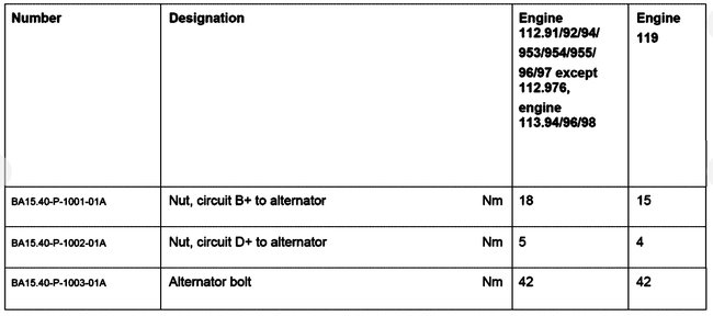

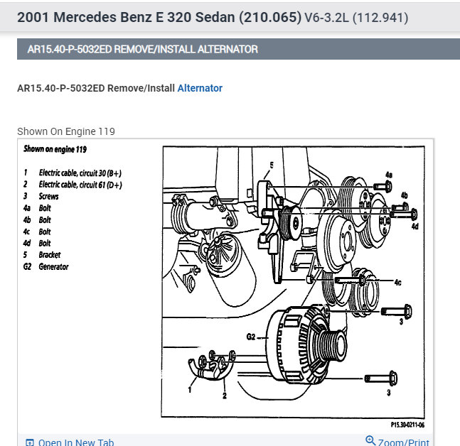

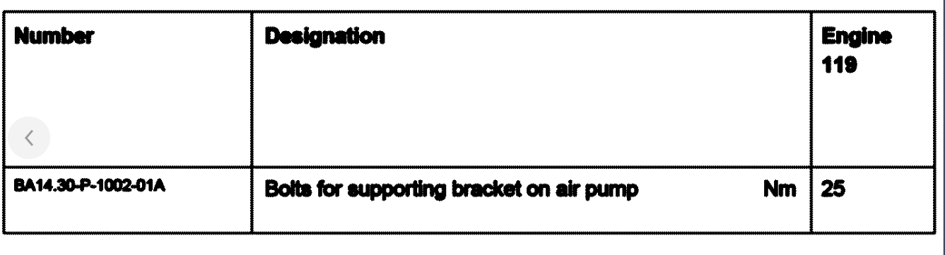

If you look below, I attached the directions specific to this vehicle. The directions include an exploded view of the part/area, part names, and directions.
