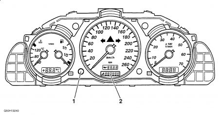

2003 Mercedes Benz 320e Automatic 53000 miles
Can you tell me how to turn off my "regular scheduled Maintenance" light?
Aug 12, 2009 at 1:44 PM
DOCFIXIT
  • 18,828 POSTS
Hi Turn ignition to position 1 Press button 1 hold( see diagram) Turn ignition switch to position 2 after 10 seconds signal will sound display shows 7500 miles release button 1. Hope this helps Thanks for donate

Unfortunately, it didn't work. Any other ideas besides visiting the dealer?
Aug 13, 2009 at 2:07 PM
DOCFIXIT
  • 18,828 POSTS
Need body number VIN drivers door is it
210.265, 210.282, 211.065 or 211.282?
