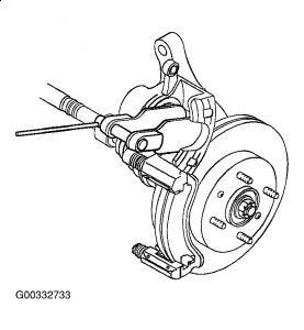

I would like to know how to compress the caliper i have it off the roter and the new brakes on but the caliper will not go in go in

Insert the piston in the cylinder using the special tool (09581-11000). Fig. 47: Depressing Caliper Piston

Depress the rear caliper piston into the cylinder using special tool 09581-11000.
