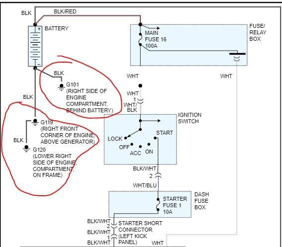

When I exited to a stop sigh it just shut off. Tried to jump it nothing no crank towed it home took alternator off replaced it with a new one replaced the battery. Same thing got all systems and the idiot security working but still no crank.

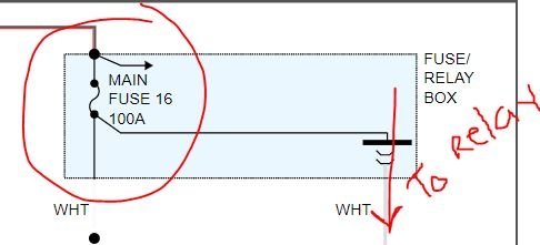

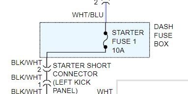

Okay, I am going to attach pictures of the starting system and work through them with you. First, I need you to confirm that two fuses are good. One is a main fuse, which if everything other is working, it should be good. However, there is a starter fuse under the dash I need checked. See pics 1 and 2.
Pic 1 shows the fuse in the vehicle that I'm questioning. Pic 2 is the main fuse and the white wire I so poorly drew an arrow on goes to the starter relay.

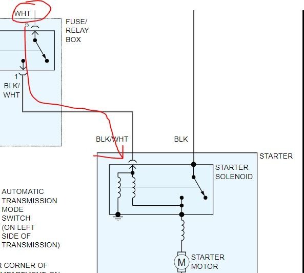

From the relay, power is supplied to the smaller wire on the starter solenoid. Check to see if you have power there when someone turns the key to the start position. See Pic 3 Also, here is a link that explains how to check a starter. You may find it helpful.

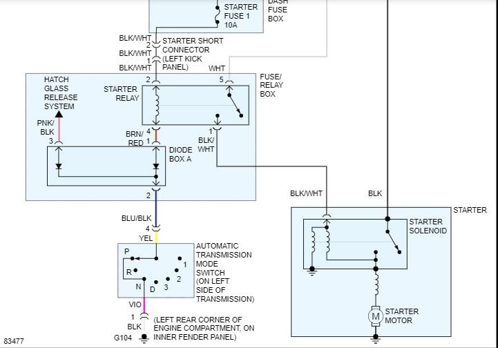

Additionally, check the starter relay. Simply switch it with another relay in the box with the same part number. If there isn't one, here is a link that explains how to check a relay. Pic 6 shows the starter relay location.
I would really like you to recheck the ground between the battery and the engine block to make sure nothing is loose, corroded, or damaged. And, do a visual inspection of the main wire between the battery positive and the starter to make sure it isn't loose. One more thought, see if it starts in neutral.
Pictures 4 and 5 are schematics of the entire starting system. I had to cut it in two so it would fit. I did overlap it so you can follow it. Please recheck the grounds I circled in the pic.

Let me know what you find or if you have other questions. This could be something really simple. The idea that it just stalled and wouldn't restart since leads me to think it has something to do with a faulty ground, but that is to be determined.
