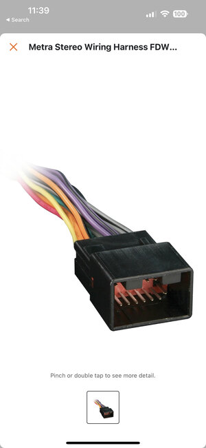

So, I have a aftermarket stereo from Amazon and after I bought a wire harness, I hooked up all the color coated wires, the stereo turns on, but I have no sound, I heard plugging in a blue/white wire can fix it, but I don’t have one on the stereo. I also have a left-over orange/black wire, a grey and plain blue wire, I hooked all the wires I could up to the aftermarket harness and those are just leftovers, would any of those wires cause no sound?

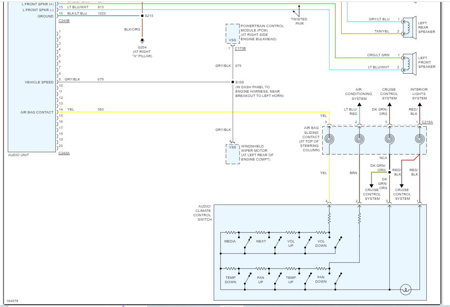

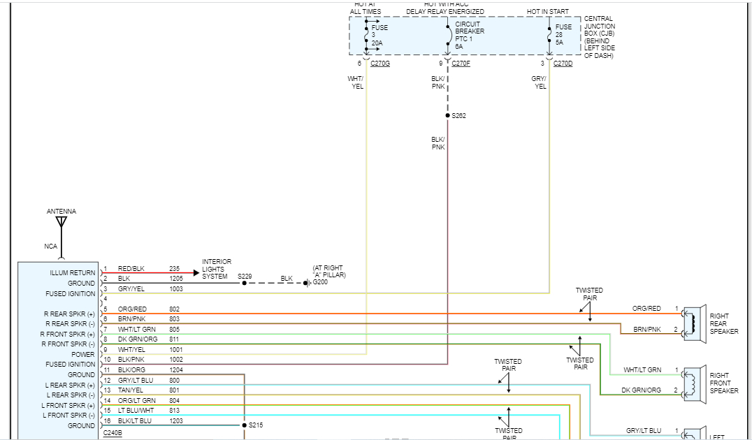

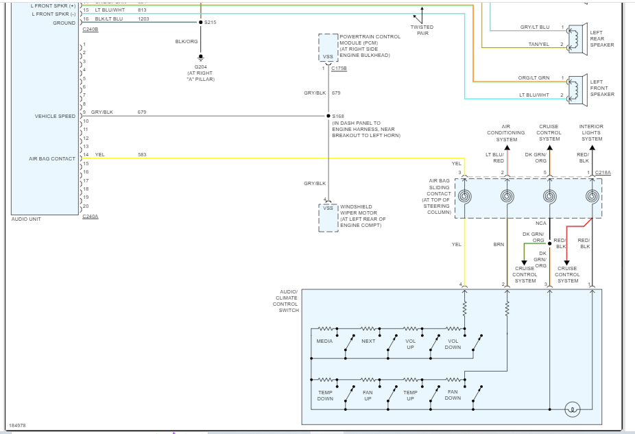

Also, I attached the schematic below for the non-audiophile system so that you have it as a reference. None of the colors you mentioned (wires) are present in the schematic. By chance, are the wires you referred to in the adapter harness? Also, could you take a few pics of the wiring schematic that came with the new system and adapter? I'll take a look through them and see if I can find a possible cause.
Also, I believe this vehicle has an audio amplifier. Has that been taken into consideration?
joe
See pics below. Note: The pic was one page, but I had to cut it in half to make it readable. I did overlap them so you can follow from one to the next.

I can put a picture of the wiring harness, I’m currently busy so I can’t get a picture of it at the moment.
