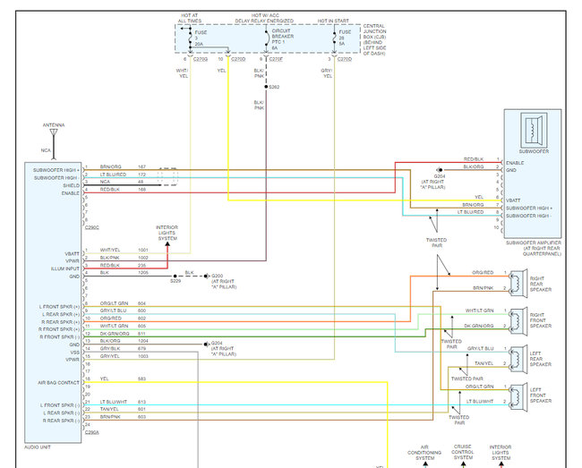

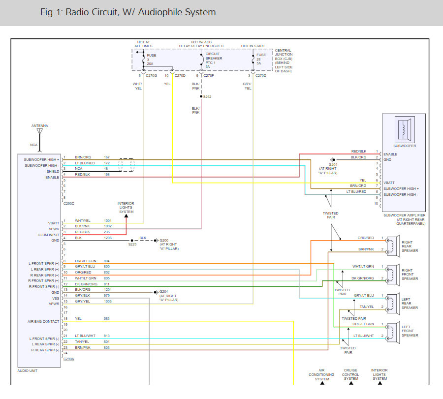

yes i tried to print wiring diagram but can't read it was wondering if you could send me a better picture.i have the 2004 ford sport trac with the pioneer stereo and subwoofer. thank you

Here is a guide to help check the wiring and the radio wiring diagrams below.

I am looking for the car radio wire diagram so that i can install an amp Its on a 2003 ford explorer (sport edition) with the 6 disc cd changer as well as back seat radio controls

see pic this is for a base radio. Check out the diagrams (Below). Please let us know what happens.
