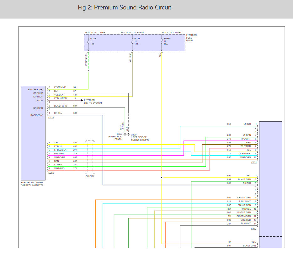

I have taken out the old stock radio to replace it with a JVC radio model number KD - g400. To do the swap I had to buy the JVC radio harness and the harness to switch from stock radio to aftermarket radio for the truck itself, after everything is hooked up properly, but I cannot get sound out of my speakers, but everything else turns on. The only way I have sound as if I hardwired it from the JVC harness directly to my speakers. What would be going wrong for that to happen?

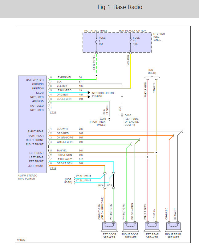

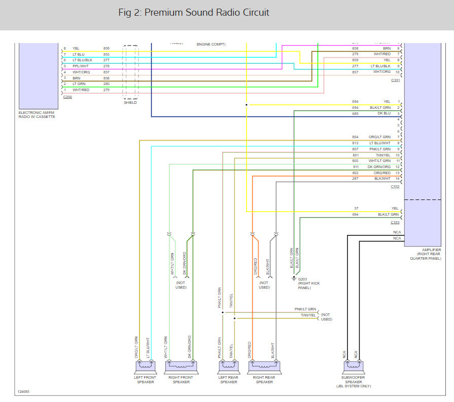

There is a n amp that needs to be triggered by connecting the antenna trigger to the light blue wire of the amp here are wiring diagrams for the radio and amp system so you can see how it works.

Thanks worked perfect :)
