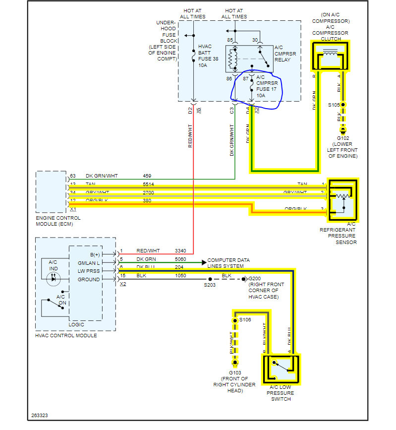

I am having hugh issues with the A/C. I bought it when it was cold so i really didn't pay attention to the A/C but now i've spent over $2,700.00 trying to get it fixed and it's still not working. I've replaced the evaporator core, A/C accumulator, freon, upper and lower hose clamps, fuses, and the A/C compressor. It's still not working. I got all my parts from Napa. They have given me the wrong part 2 times. I had it working for about a week then the A/C compressor went out. I've replaced it 3 times. The last time i replaced it they gave me an A/C compressor with two sensors on it which was kind of weird because the previous two other ones didn't have 2 sensors on it. So now the compressor isn't working at all. Napa said it's the same part number as the previous two other ones i bought. So my question is, does the front A/C compressor have one or two sensors on it? And if so does that mean i have an electrical problem?

The compressor has only one sensor. The fact the replacement has 2 does not mean much. The same part numbers can be different. I would not be afraid of using it.
Why did the other compressors fail? I attached the wiring diagram for you to view the system. You need to check the relay, fuses, and wiring for the compressor.

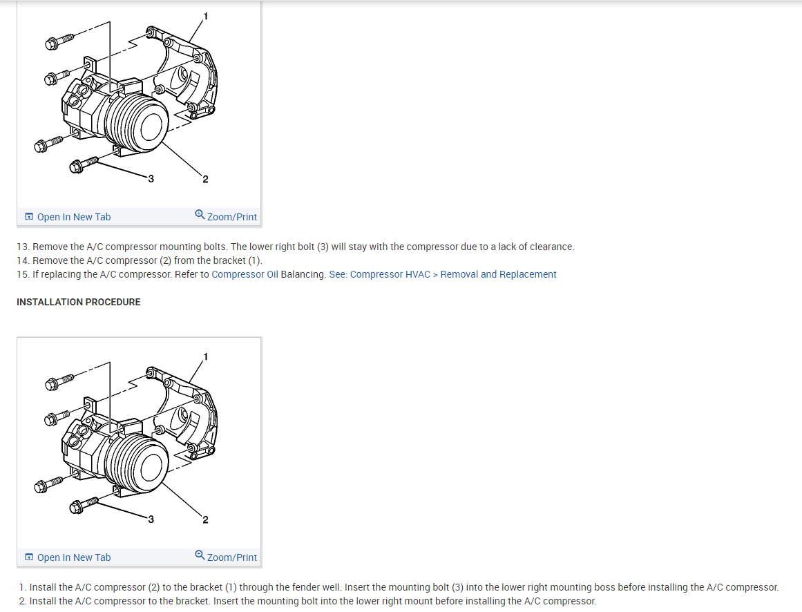

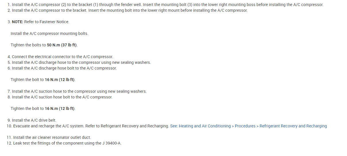

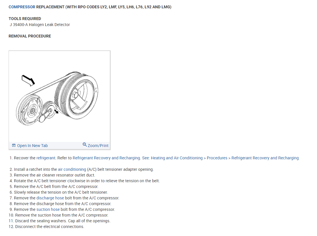

https://www.2carpros.com/articles/replace-air-conditioner-compressor

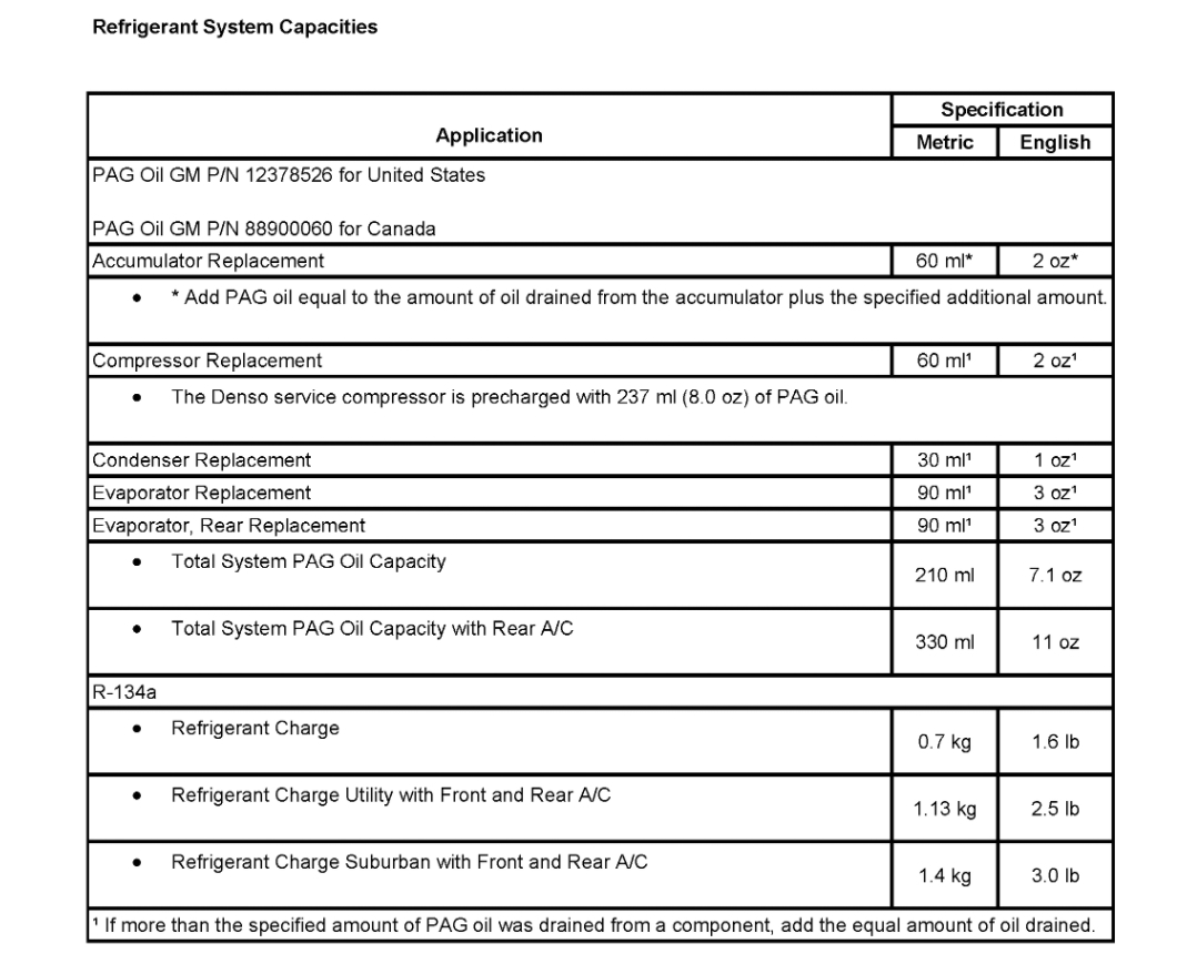

If they locked up, you need to replace the accumulator again as it is full of debris. That may be causing the others to fail.
