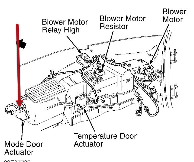

Hello, I have a 1999 GMC Yukon SLT. I've been noticing for a while now, that when I cut my heater or A/C on it doesn't blow through the vents on the dash. But it blows underneath the dash onto the feet in order for me to cool down or heat up the inside faster I have to use the rear passenger vents. Any idea what could be the issue? All of the lights and stuff work, it's just the front dash vents blow.
Thursday, July 16th, 2020 AT 12:17 PM (Merged)
HMAC300
  • 48,601 POSTS
You actuator is not working right, try pulling hvac fuse inside truck with key on for 60 seconds and it may reset. If not thenyou will probably have ot replace it see pic.

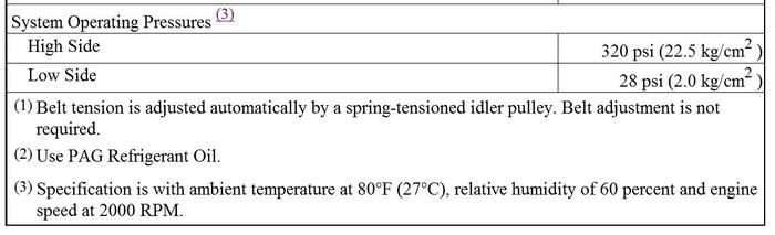

my truck is a 98 yukon. Had some a/c problems causing the high side to be super high and kick out. Got my blockage fixed but my high side is still running up there pretty high 350-375. Have I blown my compressor? System has been flushed oiled and vac'd and charged with the correct amount of r134.

KHLOW2008
  • 41,814 POSTS
What is the low side?
CAROLINACARCONNECTION
  • 66 POSTS
55-57 psi ambent temp is about 96-98
KHLOW2008
  • 41,814 POSTS
There seems to be too much freon in system.
  • 66 POSTS
Its not a overcharge issue. It started running high when the first 8 ounces were added

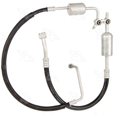

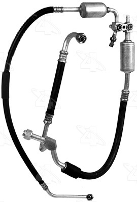

NAVYCLAY
  • 1997 GMC YUKON
  • 190,000 MILES
I'm replacing the A/C hose assembly on a 1997 GMC Yukon without rear A/C. The old part has three ports that come out above the compressor. High pressure, Low pressure, and some electrical port that plugs into a wire assembly. The new part I recieved form the auto parts store has the three ports, but the one where the electrical component should be is just a regular port similar to the high and low ports, only without a cap. The hose assembly for the model with rear A/C has the electrical component I need, but it also has an extra hose that I don't. Removing the electrical portion I need for the old part does not look like an option as it appears to be welded or pressed on. How should I proceed? Is there an adapter part required or is the electrical portion even necessary? Please help. Thanks.

KHLOW2008
  • 41,814 POSTS
Was the system evacuated? If it is not overcharging then there is air in system. Both low and high are showing high pressure.

NAVYCLAY
Roy,
The hose they gave me is correct except it's missing an electrical connection at one of the ports on the housing that attaches onto the compressor. I think it's a sensor or a switch, but I'm not sure. It has a port similar to one you would plug a compressed air hose onto rather than an electrical housing for an electrical connector. The images below are the hose with and without rear a/c. The one with rear a/c has the electrical connection needed, but the extra hose that is not. I forgot to metnion that the engine is a replacement of the original so that may be a factor.
