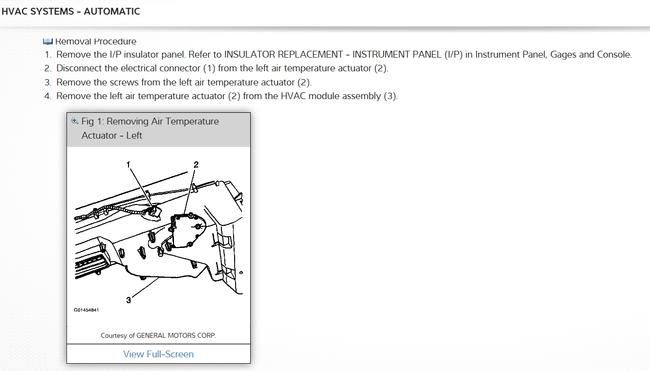

Hello - having a intermittent problem when driving with my a/c blowing hot on the driver's side. All other vents blow cold. Changing the temp control switch does not make it cold again. This can be corrected if I turn off the engine and back on again. Any idea what the problem may be? Thank you!!
- Ken
Oct 13, 2014 at 5:39 AM
  • 55,224 POSTS
Hi Ken,
It is a common problem with these vehicles that the blend door actuator has gone out, so the temperature door is not moving into position.
Here is the instructions and diagram of what it takes to change it
