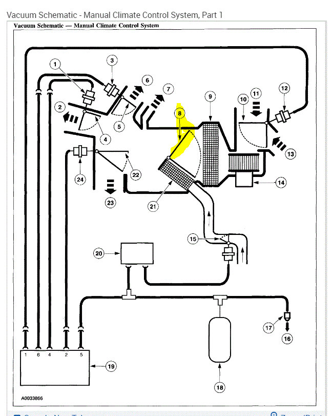

Hey all, I have the vehicle listed above that I’m having A/C problems with. The A/C didn’t work hardly at all when I got the car. I’ve gone through the entire system nearly, but this last part has me stumped. If I’m sitting in park in my driveway with the A/C on, it will work perfectly fine and be cold, even after I drive slowly it will be nice and cold as long as I’m super easy on it. When I got the car, it was overcharged, so I evacuated it and recharged with the correct amount of Freon. Now it works much better but under easy acceleration it will suddenly get warm until I cruise at a constant speed for a while. It isn’t the high- or low-pressure switch, it shouldn’t be the full throttle circuit, as I’m barely giving it gas, and I can floor the car if it’s in park, and it will never get warm. Only when in drive going down the road it will get warm. What could this be? The compressor works perfectly, all the vents/vacuum hoses are in working order. I removed the vacuum check valve and it tested good as well. It’s not vacuum related. I’ve also noticed even when the ac is working nice, and cold idling, the A/C lines are not “sweating” like they should in 100+ degree weather under the hood. Thanks in advance for any help/answers provided.

The HVAC on this vehicle is controlled by an engine vacuum. I suspect there is a leak in the system. When you place the engine under a load, the vacuum drops. When you let off the throttle, it increases. So, do me a favor. If none of the other functions are giving you trouble, try this. Listen closely for a hissing sound from under the dash. I suspect there is a slight leak between the controller and air temperature door.
I attached the vacuum schematic below and highlighted the air temperature door. Let me know if you hear anything and pay attention if any other functions act oddly when you accelerate or place the engine under a load.
See pic below.

Hi Joe, thanks for the reply. Like I previously stated I have checked all of the vacuum lines under the hood and behind the dash that I can get to. There is no vacuum sound bleeding off. What I am wondering, would cause the pressure in the A/C system to drop rapidly under acceleration? It idles at about 50lbs of Freon, when I give it gas, the pressure drops to roughly 30lbs. I suspect this is the issue, as it’s probably dropping even more under strain while driving, causing the low-pressure switch to do its job. Thanks again!

The pressures you indicated dropping, the low side will drop when you rev the engine and at the same time, the high side will increase. If you are getting a loss of cooling, there could be a vacuum leak anywhere that would cause the blend air door not to hold. If there is a leak under the hood, the vacuum in general will be lower.
That is what I suspect is happening.
Let me know your thoughts.

I think checking the vacuum with a gauge will help. As I mentioned, the leak doesn't even have to be in the vehicle, it could be under the hood.
As far as revving the engine, I don't think the vacuum drops long enough for a change. On the road, you will hold the throttle open longer which provides more time for a drop in vacuum.
I don't know if you need it, but here is a link you may find helpful. Take a look through it if you get a chance.
Let me know what you find. I'm really interested in knowing. Since it happens under a load, a leak is my primary suspect.

Try this. Go to the vacuum supply from the engine. Disconnect it. With the engine running, is there a vacuum supply? If there is, place a vacuum pump on the interior side. See if it holds vacuum. To me, I think the issue is vacuum overall that is causing the blend air door to move allowing the temperature to change. This is a theory, but that is what makes sense to me.
Let me know what you find. Also, confirm if this has manual climate control or automatic.

Okay, remove the blend air door and inspect the actuator and the door to see if it could be moving when accelerating,
Also, since the pressure drops (low side) I suspect the high side increases. That shouldn't be the compressor. However, we don't know the high side.
I just sent a message to the site owner. He is excellent with A/C. Let's see what he suggests.
