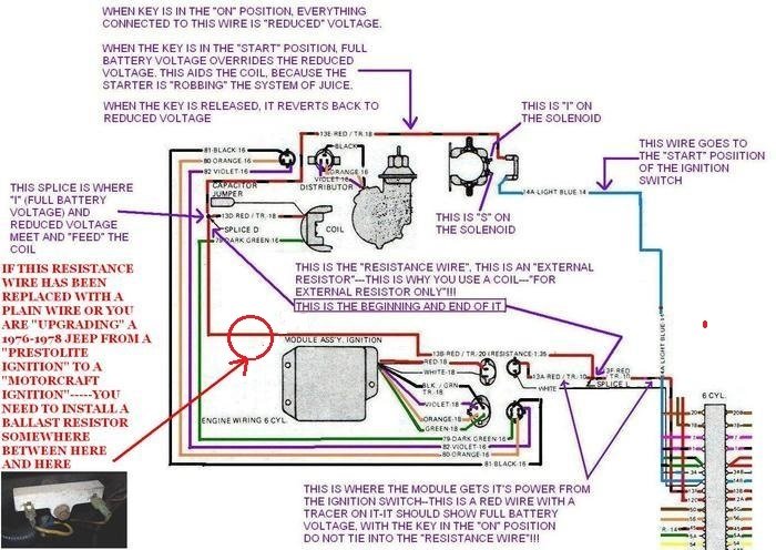

Once you are ready, I will try to tell you what wires you will need to hook this up. Mainly the two wires that will feed the new 1979 ignition module.
I think you mentioned this.

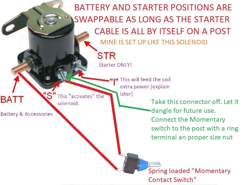

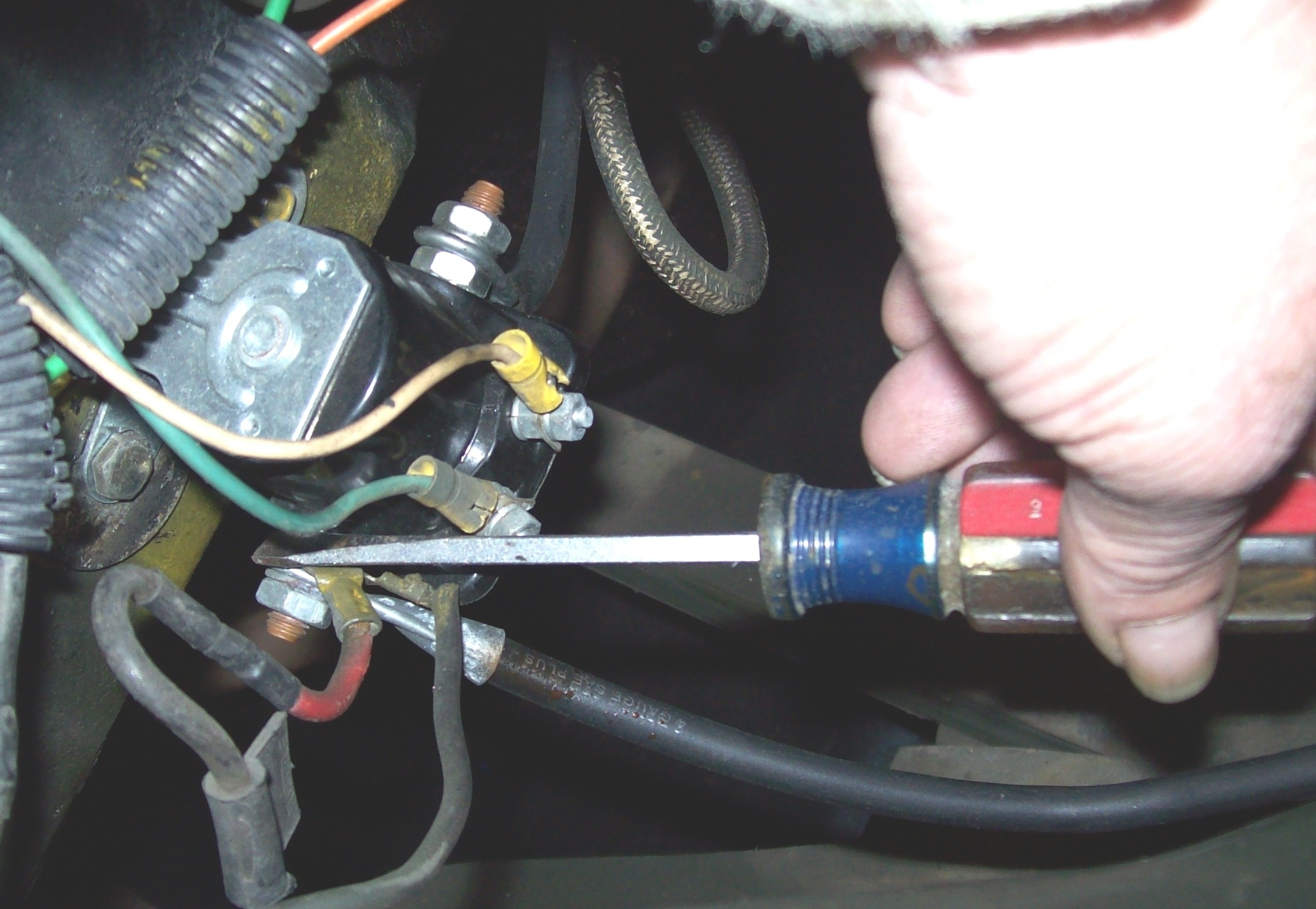

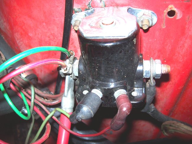

Below is a diagram of the solenoid
Picture one, this is how it looks originally.
Picture two, this works too, mine are like this, swapping the big posts' wiring (starter is still by itself, just on the opposite post).
The solenoid do not care which big post is used, as long as it is a mirror image the original.
"S" and "I" must remain the same!
I do this so that I can "bump" (key off) or "start" (key on) the Jeep at the solenoid with a screwdriver picture three (should I not have my remote starter handy picture four).
This puts "hot" right beside "S".
This comes in handy at times, such as the day a stick jumped up and popped my fan belt off. I was by myself with only a screwdriver.
I was able to stretch the belt most of the way over the water pump pulley and held it tight in place with another stick. Then I bumped the engine (key off) with the screwdriver. Presto! The belt jumped on!
Let me know where to start, any questions?

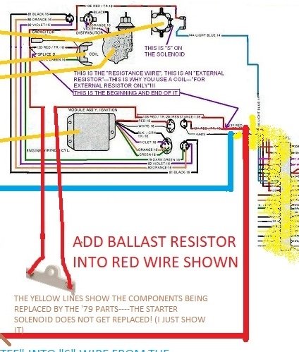

Yes, you can hard wire the connections.
Yes, chopping connectors off will probably void warranties.
I really try to keep things consistent if I can, The entire system becomes a 1979, no improvising/making do/rigging.
If I need any ignition part now (maintenance), I tell them at the parts store that I have a 1979 CJ-5 (no need in confusing them!).
There is only the one part that was needed to make it work that is not 1979.
That would be the "ballast resister". The 1979 has a resistance wire to the coil, the 1977 does not. The ballast resistor sorta converts it (coil wire) to be like a 1979.
Insure the distributor is perfect, giving you a review on how to do it correctly.

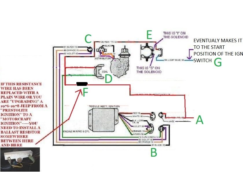

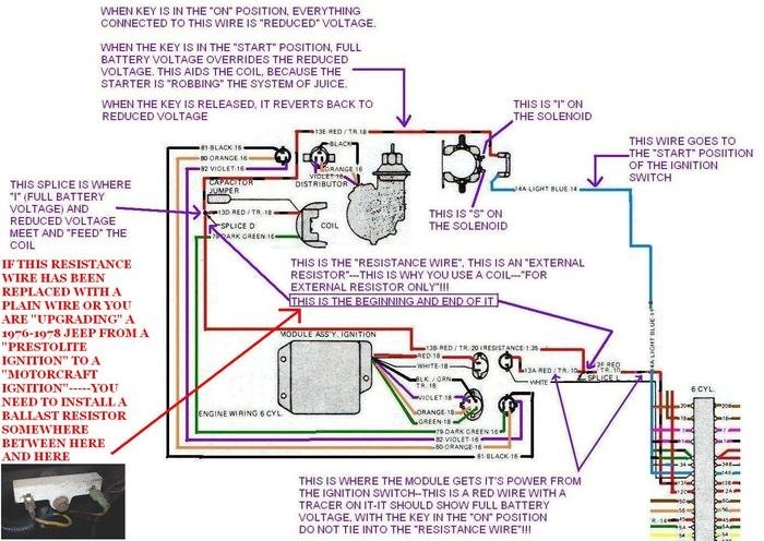

Sort of the easiest way I could do this.
The first two items are what is needed
The first is to the distributor. (one of the wires is a piggyback, it is not used)
The second is for the module output.
https://www.carid.com/ignition-control-module-connectors/
I cannot find the connector for the input side of the module (it will have only two wires) This might be something to get at an auto salvage yard.
The correct way to disconnect this connections is to grasp the wires on either side and pull!
I took my diagram and sort of stripped away the stuff in your way.
I also labeled areas of the wiring with green capital letters so you can reference the area back to me that you may be having problems with.
Let me know where you need assistance.

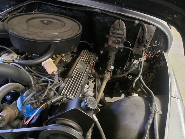

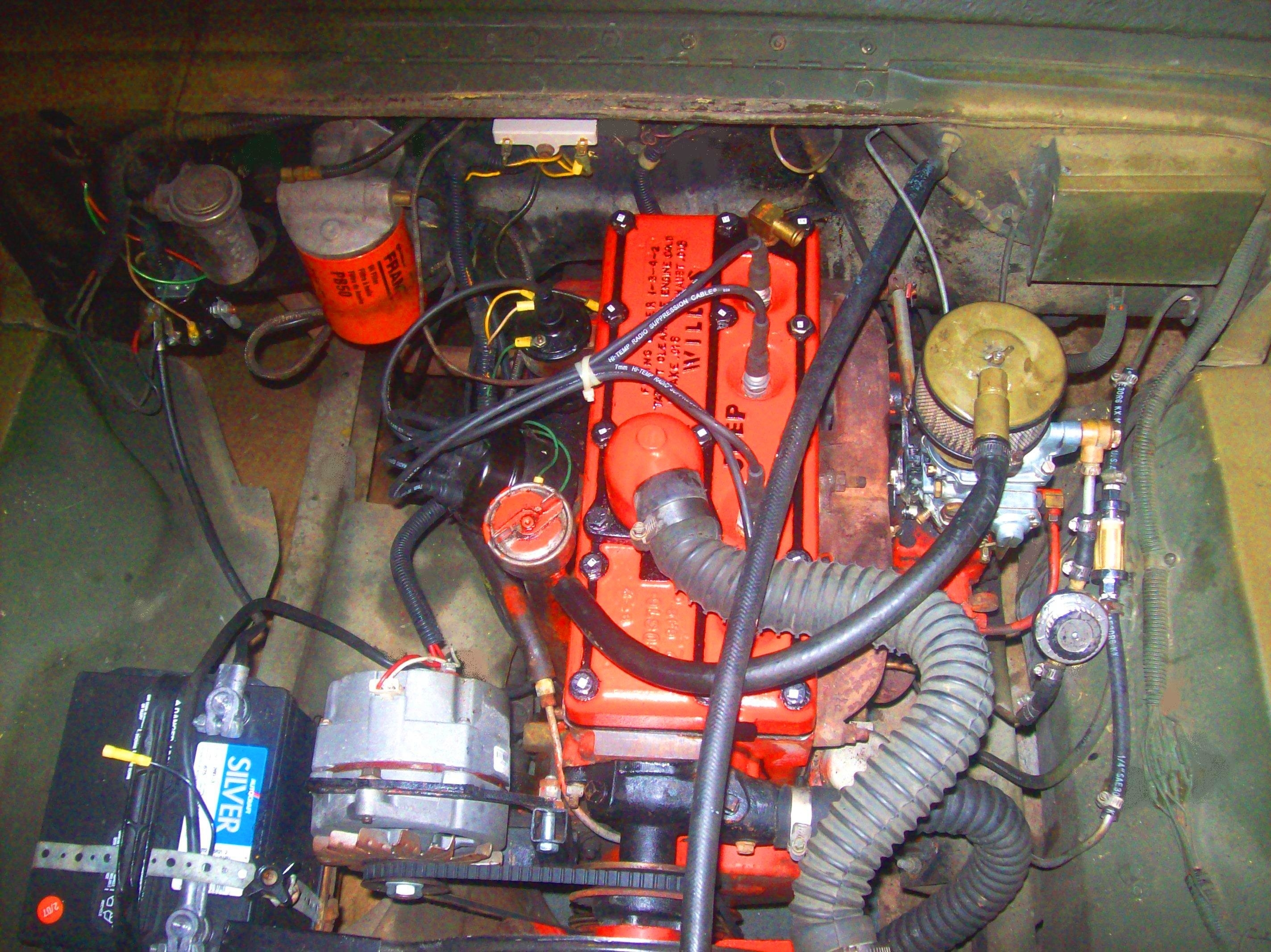

Send several pictures of carburetor/ intake, some with breather off.

You have everything discussed to upgrade this to being like a 1979's Motorcraft system?
I have got to make some pictures and do some behind the scenes work to get the rest of this to you!
Please be patient, I will not forget about you!

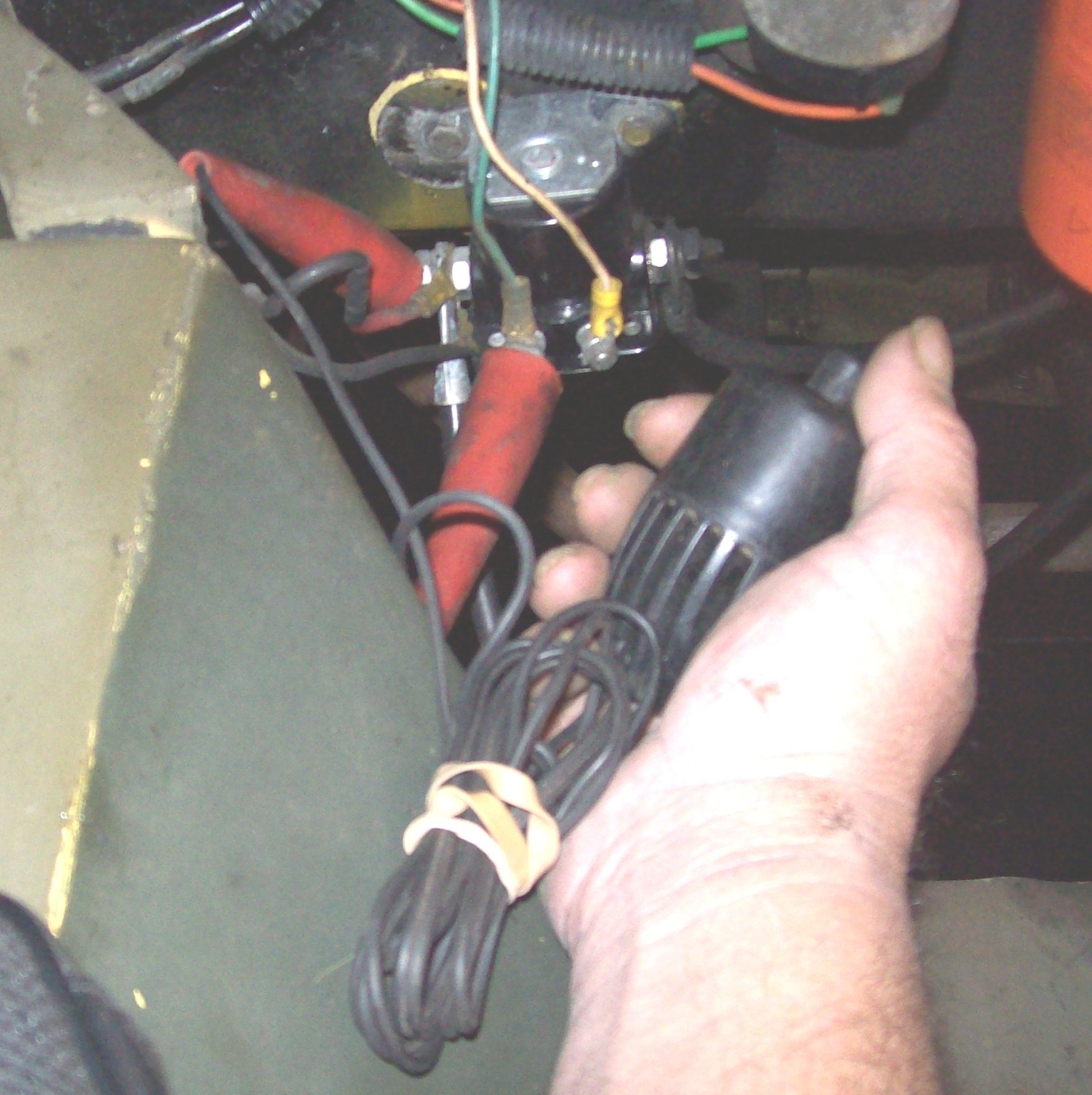

I assume the key will go to the "on" position as it used to, to power everything up. If not, let me know the situation.
I worked this up. It should give you something to do for a bit.
If you do not understand something, let me know.
This will be the easiest was to "crank" the starter over.
Remember the post goodies can be swapped (if desired) Yours may be opposite of this diagram (which is fine). All accessories and the feed for the momentary switch stay with the battery cable side.
The starter cable will always be on a post by itself.
See my beautiful diagram below.
I will catch you up on the other stuff soon.

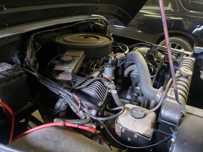

Man, am I glad to see this! I will get you pictures of the current wiring catastrophe. I can move the slide thing with teeth to the on position but it kept getting harder to do, I think something in the column has a sweet spot now that I cannot make happen every time. But I did but some toggle switches and a button. But there is a noticeable position where it stops every time, the sweet spot just made the dash brighter if that makes any sense, it is all I noticed it do. My wiring job ended like this out of desperation trying different combinations because the diagrams I was going off of were different from each other and I just got more confused.
Thanks for showing up I am not ready to give up! Out of the three Jeeps in my yard the CJ5 is my favorite and runs better than the others when it starts. Pictures coming soon.

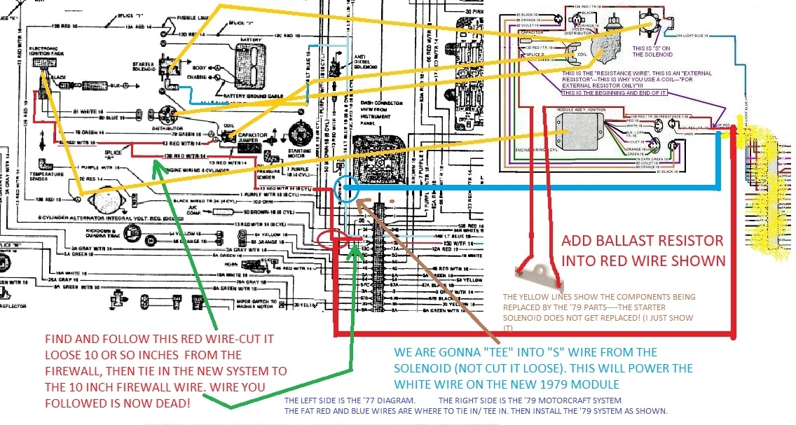

Your new module needs to be bolted down so that it grounds.
You may have to go back and forth between diagrams to get better views.

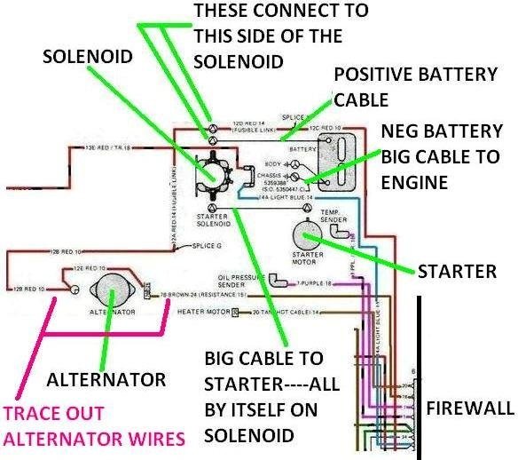

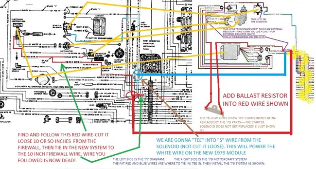

1) This is the upgrade like a 1979 - it must be connected exactly like this.
2) Lots of time making this (may be hard to see?). This is a partial 1977 diagram showing you where to tie in the feed wires for the '1979 system.

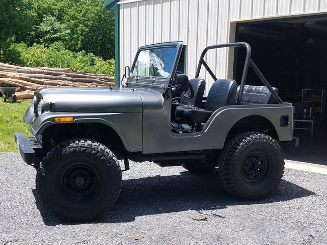

3) "Willy" (Restored in 1993) With a new 2017 paint job and insignia.
4) One of "Willy's" brothers in WWII, yep even now, 72 years later, I find those magnets stuck to mine when I get back out in the parking lot!
I did not show the 1979 coil connector being tied onto the old 1977 coil wires. If it is not clear as to what to do, let me know, I will fix you up.
Once we get it running, we will tune it up to get it all back to its correct settings.

Is it possible to install or wire the external resistor backwards? I finished wiring all this and it does a thunk, thunk, then really squeaky turns over with not much conviction then stops, then thunk, thunk, every time I bump the starter. And the solenoid was smoking where the red wire ties on to the "i". When this happened I disconnected the battery and stopped messing with it.
Jun 25, 2018 at 8:23 PM
CPTNHWDY
  • 13 POSTS
And there are a red, black, and green wire from the aftermarket tachometer, red and black having power. Should I tie them in to something?
Jun 25, 2018 at 8:25 PM
CJ MEDEVAC
  • 11,004 POSTS
Resistor can go either direction.
Recheck your wiring. Should not smoke!
It ties in between the coil and its power source.
"I" comes off of "I" (embossed on the solenoid) and basically ties onto the positive side of the coil (or a few inches back) on the wire between the positive coil wire and the resistor. In my diagram, it looks like a "Tee"
We will deal with the tachometer after we are running, do you have instructions for it?
Can you send pictures of what you have done so far?
This "thunk" sound is the engine trying to crank/ start? Or is it something else making the noise?

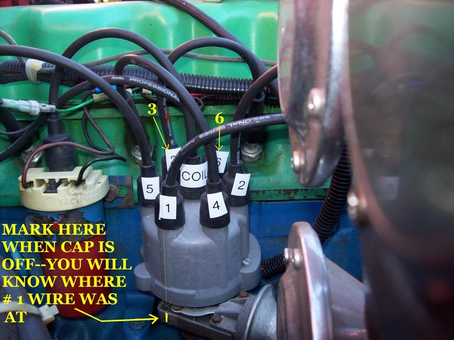

This is how you replace a distributor. I am going to show you the way I do it, then give you a couple of links of someone else explaining and showing. (You might see why I do it in slow motion)
Xdistributor (this word helps me search for this quickly, if I need to copy and paste some or all of this to someone else!)
Using the starter to bump the engine to find the compression stroke works fine with a seasoned auto guy. It is too easy to "overrun" your stroke and not realize it if you are not familiar with the procedure.
Let's do it in slow motion, it is more accurate in my opinion.
Hide your keys, chock your wheels, put the transmission in neutral.
Remove number one spark plug.
Stick it back in and only screw it in barely by two threads. This will allow compression to "hiss" by it (some remove the plug and stick their thumb in the hole - this scares folks!).
Remove spark plug number one.
From the front, a CJ's engine turns clockwise when running, this is how we will turn it "by hand" using a ratchet or wrench on the harmonic balancer bolt (picture number one below).
As you rotate (being this is a four stroke engine, you may have to turn two full revolutions to find the compression stroke) eventually you will hear a "louder" hiss from the loose number one plug. (you may hear faint hisses from the other cylinder leaking past the rings)

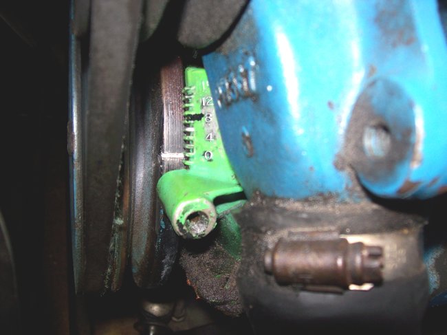

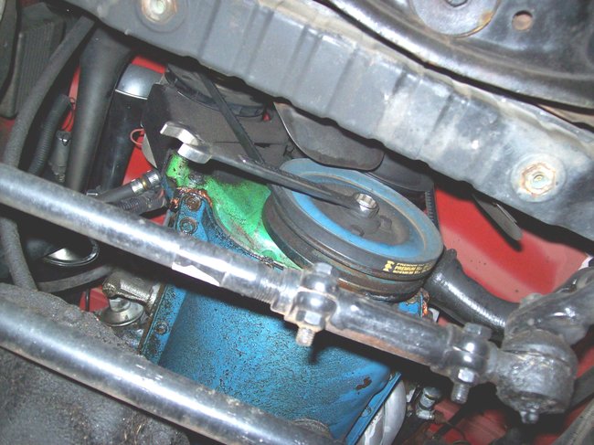

Stop!
You are at the beginning of the compression stroke.
Number one piston is still coming up on this stroke, our goal is to get it to the top. This is called "top dead center" or TDC.
Ever so slowly continue to rotate CW, until your timing mark is on "zero". This will be less than a half a turn from where you heard the hiss (white chalk in groove is lined up with "zero"(if more than half a turn, start over!) (See my picture number two)
If you miss the stroke or pass your marks, and then hit your marks (you are most likely on the exhaust stroke (it will not hiss). The other "up stroke", 180 degrees off. Start over, we want TDC!
Back to slow motion, our timing line is on zero, we should be dead on TDC.
Take off your distributor cap, look at the rotor button, is it pointing to where number one spark plug wire is located?
(This really does not matter as long as you put number one spark plug wire at that location and then follow the firing order sequence in a clockwise manner from that point on.)
I like to arrange mine as it is shown in diagrams (textbook)(later on in time, using the diagram would get you right if the wires were all removed).
While at TDC, (not moving the crank at all!) you can remove or pick up the distributor out of the cam gear, rotate the rotor button to the desired position and sit it back down. Remember when it engages the cam gear it will "twist" a little. Allow for the twist!
To go along with this, the oil pump drive is on the flat screwdriver end of the distributor shaft. It is a big slot (look into the distributor hole).
If you move the rotor button. You will also have to use a flat screwdriver to move the oil pump shaft a little so that the end of the distributor will go into that slot. Otherwise the distributor will not sit all of the way down! Sometimes this is tricky, Do not force it! Small "tweaks" will finally let it sit down, remember the "twisting action' as you drop it in might fool you as to which way to face the oil pump slot!
The 258 firing order (plug wires) is 1-5-3-6-2-4.
Below, third picture is textbook distributor set up. (Note the mark, where the rotor button should point when trying to stay "textbook")

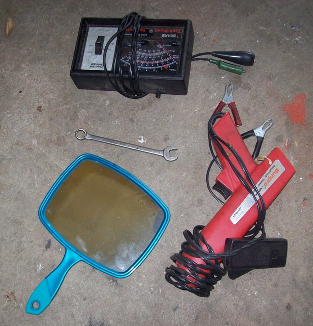

After the distributor has been installed or even loosened and moved, you will need to use a timing light and a dwell/tachometer to set you timing perfect, the TDC deal is to get the valve train timed with the distributor, it may get it to run or run enough to time it by ear, it does not do your "final" timing setting.
You will need a timing light and a dwell/tachometer (or similar ones to mine). Many times these are considered "dinosaurs" and can be found real cheap at a pawn shop/flea market/ etc. See last picture.
