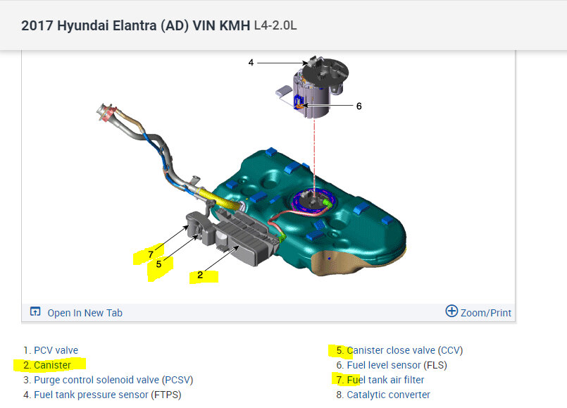

Hi Joe,

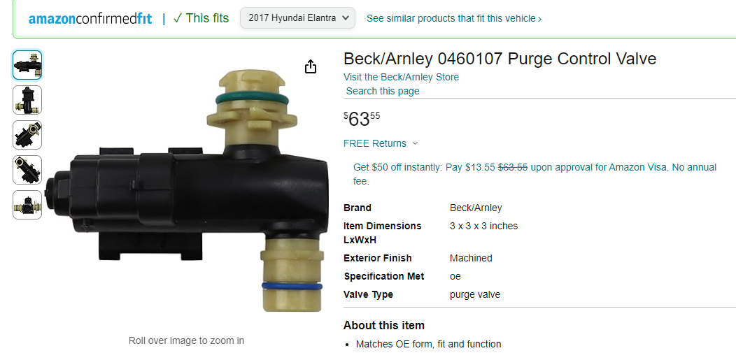

So, i did the smoke test. I later learned I did it wrong but it did lead me to discover that the vapor canister purge valve was stuck open. I took my old canister purge valve off. All the ones that were listed for the 2017 Elantra did not look like my purge valve. So, i did some homework and ordered the BeckArnley 0460107. Did I order the correct part?

Biggest fan? LOL Well, that feeling is mutual.
As far as the part number is concerned, it appears to be correct. I checked it on Amazon's cross-reference chart, and it indicates that it is correct.
If you are getting it from Rockauto, remember to use the discount coupon.
See pic below.

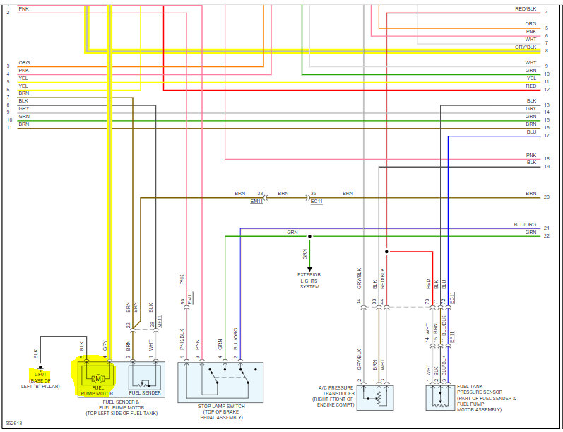

  • 110,244 POSTS

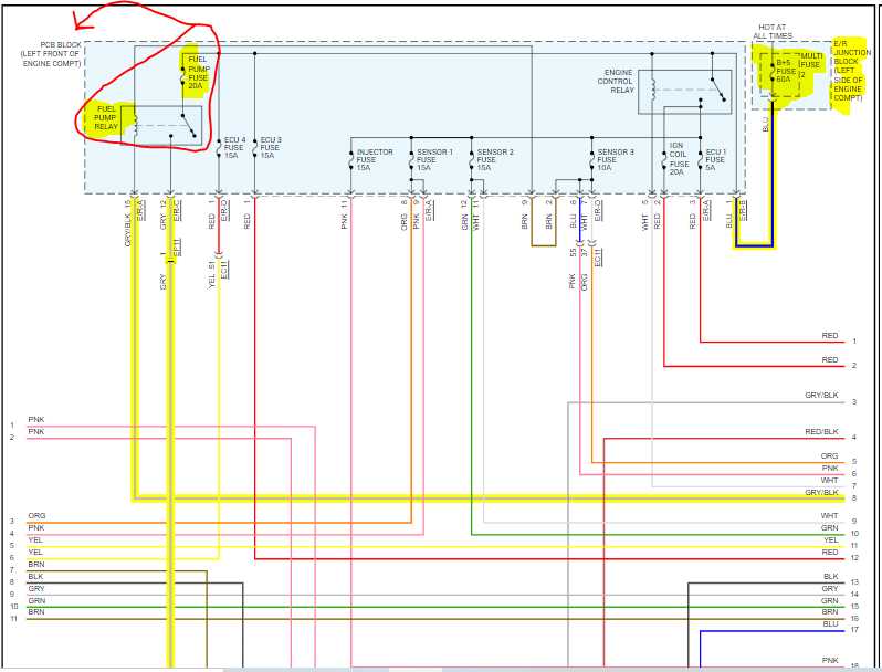

I just read through the schematics and the fuel pump relay and fuse are integral to the PCB. PCB stands for printed circuit board and is not serviceable.

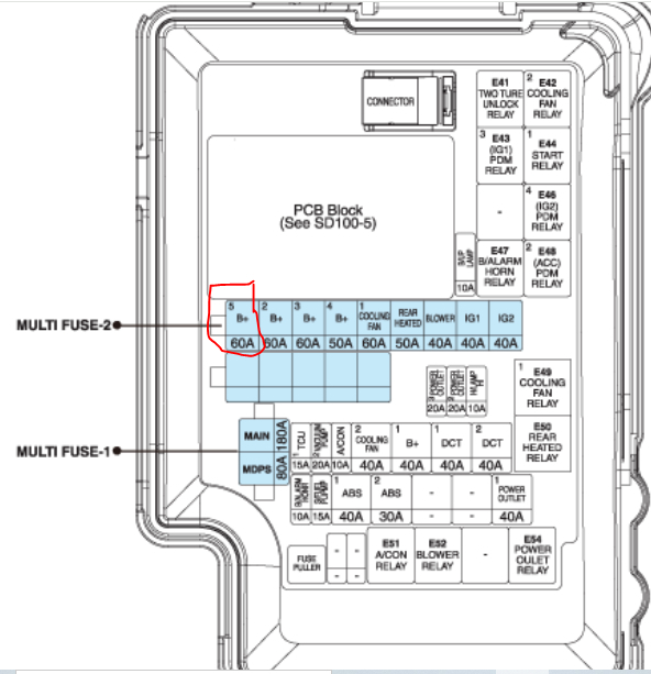

As a result, we need to test a different way. We need to determine if there is power making it to the pump, but before you do that, I want to check fuse B+5 fuse in the engine room junction box. This is a 60-amp fuse that supplies the PCB with power. If you look at pic 3 below, I attached a pic of the under-hood fuse box and circled the B+5 fuse.
Here is a link that explains how to check/test the fuse:

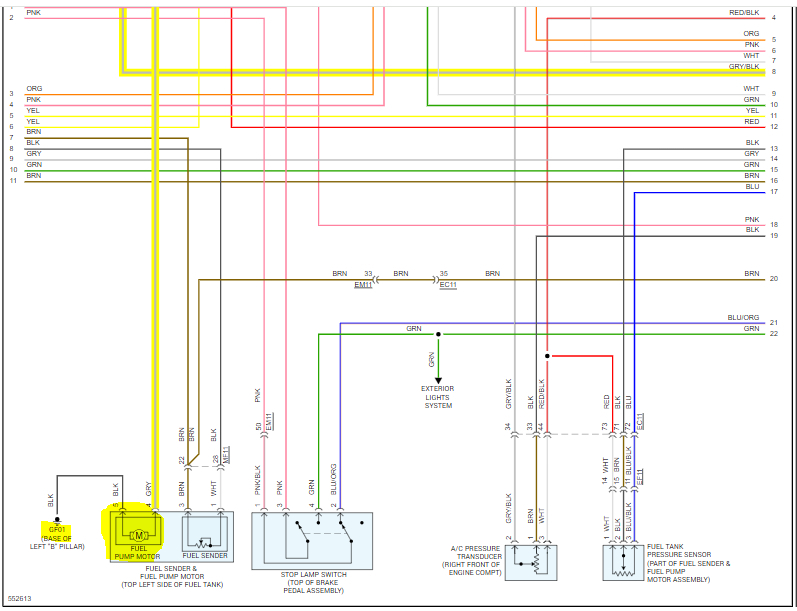

If that fuse is good and has power to and from it, the next thing to check is if the pump is getting power or not. I attached a schematic below that shows the relevant wiring. Note that the gray wire goes from the relay to the pump. That is the wire we need to check.
Let me know if you are comfortable performing these things. Also, if you plan to test for power at the pump, you will need a helper. With a test light probing the gray wire, a helper will need to turn the key because the power supply with the engine off is only to prime the system and lasts a second or two.

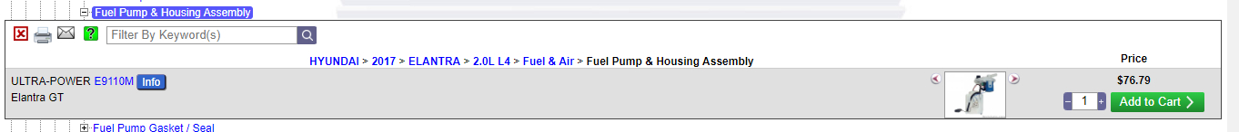

So, my last response did not update! I tested to make sure the pump was getting power, and it was. I ordered a new fuel pump and put it in. The car starts again but i am not driving it until i figure out what is ruining the fuel pumps. I have an appointment at a garage for April 24th. If i figure it out before then i get to keep my monies. :) My guess is i need to test the fuel pressure?
Apr 9, 2024 at 6:28 AM
  • 110,244 POSTS
Was the replacement the same brand? Also, was the fuel filter replaced?
