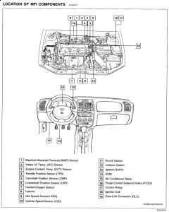

My 03 elantra was bought new. It has developed a problem with the electrical system. The car shuts off due to loss of spark, then most of the time restarts. I first lost the cruise control then the tach stopped working and then the stalling started. I replaced the crank sensor even though it wes testing good. I suspect the computer but I have no way of testing it. There are no codes showing. This is all I have for you, what do you think?

The coils are good and I replaced the ecm. The tach and the cruise still dont come online. Cant find a listing for a ingnition module. That would be the first place I would go. Double checked all the fuses and found all good. The car runs perfect 95% of the time. I am stumped.

Do you have power on the white wires on the coils? The engine control relay is in the engine compartment relay and fuse box ( in left front corner of engine compartment behind battery.

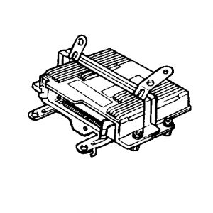

Sounds like you have a computer problem get it tested
Engine control module
https://www.2carpros.com/forum/automotive_pictures/12900_ecm_13.jpg
Engine control relay at no.17
https://www.2carpros.com/forum/automotive_pictures/12900_relay_28.jpg

As I said earlier I already replaced the computer and the crank sensor. I was wondering what you meant by the engine control module. I thought you were referring to another part as such. (Ecm, computer, brain, control module are general phrases for the engine control module) I am very well trained in automotive, retired 4 years ago after 30 years in the biz. But this one has me stumped and I was hoping for a fresh idea. I have swapped the main relay out thinking it was getting hot and opening up. Other than that I am out of ideas. Your turn!
