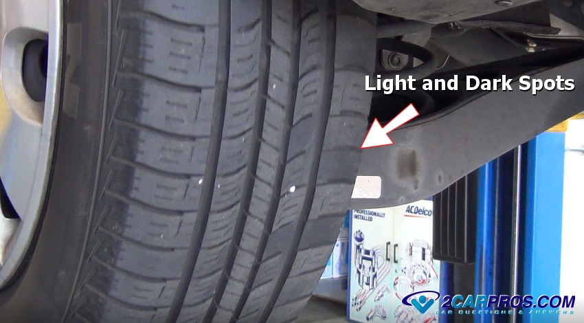

When a tire becomes scalloped or cupped the tread pattern is uneven which at speeds over 30 mph can cause a whirring sensation in either the front or the rear of the car. To check for this problem pass your hand over the tire's tread during the inspection, it should be relatively smooth. If extreme high and low points exist, the tire is cupped and needs to be rotated from front to back or replaced depending on the severity. Causes for this tire problem include bad alignment, tires out of balance, shock replacement or struts and spring replacement.

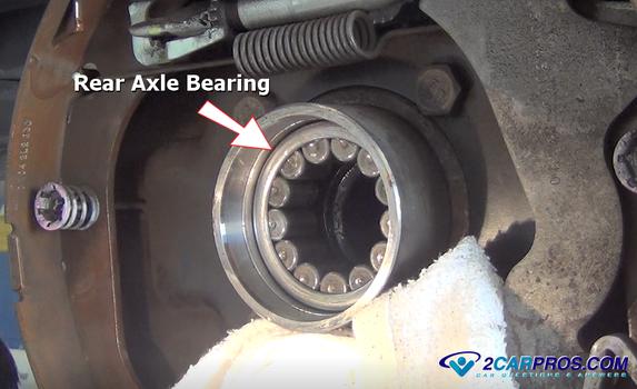

A whirring noise from the rear of the vehicle can also be caused by a rear axle bearing that has gone out. This can be accompanied by a gear oil leak from the differential on a rear wheel drive car, or by lateral wheel play on an rear independent suspension car. In each case the rear axle bearing will need to be replaced or the replacement of the rear CV axle bearing.

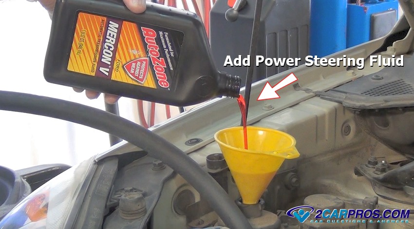

Power steering fluid is used inside the steering system to help assist the driver to steer the front wheels. When this fluid becomes low or when it needs to be flushed it will create a whirring noise while the engine is running. For this problem it doesn't matter how fast the car is being driven because the pump pressure is maintained by using a pressure regulator inside the pump housing. This whirring noise will change as the steering wheel is moved in either direction. To check this problem remove the steering pump fluid reservoir lid and inspect the fluid level and color. If the level is low, add fluid to the full line and check the system for leaks. If the fluid is full but it looks and smells burnt, a power steering fluid flush is needed.

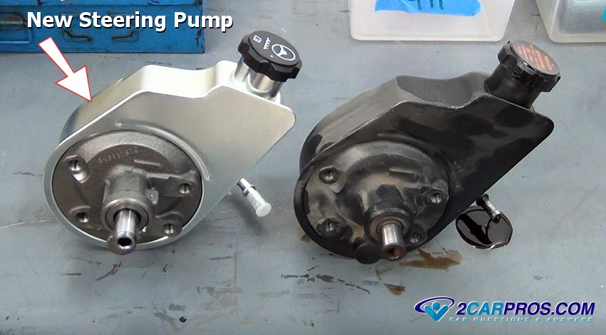

When a power steering pump fails it can do so by allowing air to enter the steering fluid when the engine is running. This air causes a whirring sound which is present when the fluid is full and when the fluid is in good shape. To check for this condition, start the engine and allow it to run for 2 minutes. Then remove the reservoir cap, using a flashlight, check to see if the fluid has small air bubbles signaling the steering pump has gone bad and needs replacement.

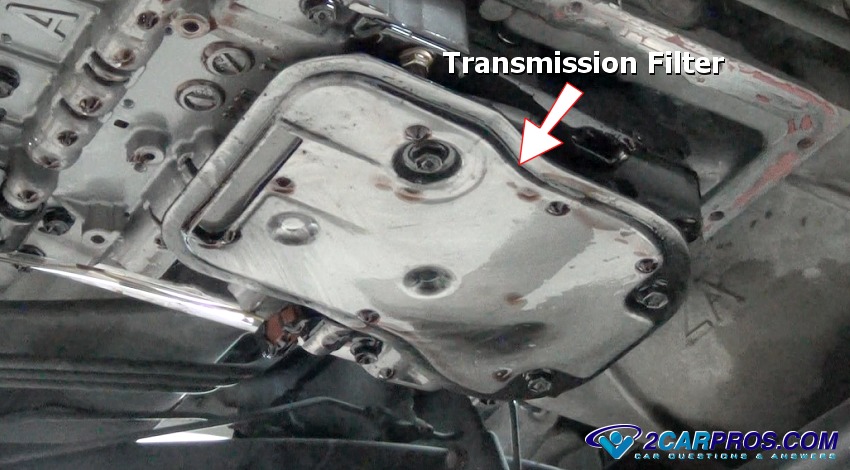

If a whirring noise is coming from the center of the vehicle (rear wheel drive) or in the front near the transmission (front wheel drive) with an automatic transmission it could have a clogged transmission filter. The noise may change with engine speed and will be generated with the car moving or not. When this filter clogs up the transmission pump scavenges for fluid causing the whirring noise, this problem can be fixed by servicing the transmission and filter.
