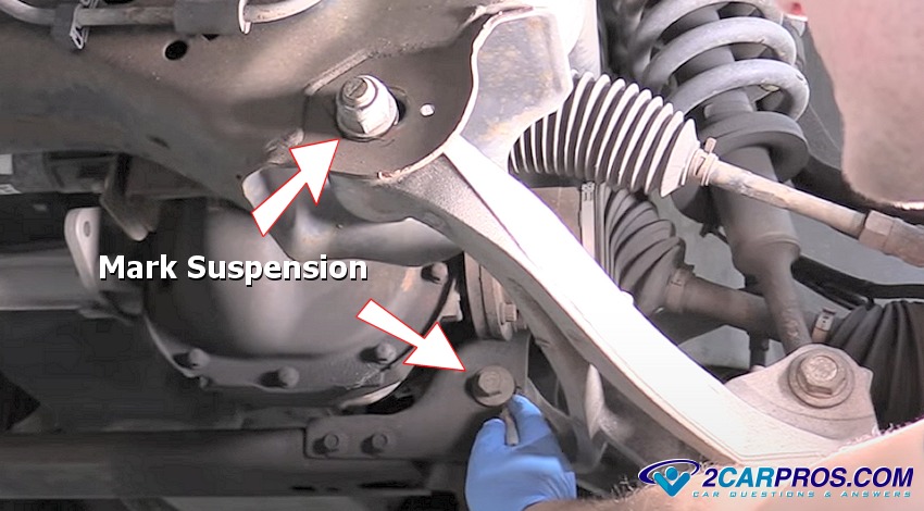

To start, the vehicle will need to be jacked up and supported on jack stands and the wheels removed either front or rear. Anytime you are working with suspension components take note of where the adjustments are made for the alignment. Assuming the alignment is correct proper markings will help you to reassemble parts in the exact place they were when you removed or loosened them. This job is on a 4x4 truck so some steps may be omitted on two wheel drive vehicles.
mark suspension

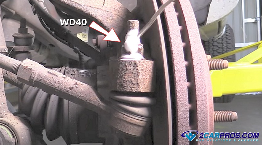

When dealing with suspension parts it’s best to use a lubricant such as WD40 or equivalent to help facilitate the removal of various nuts and bolts allowing it to sit for a few minutes to penetrate into the threads before you begin.
wd40 tie rod

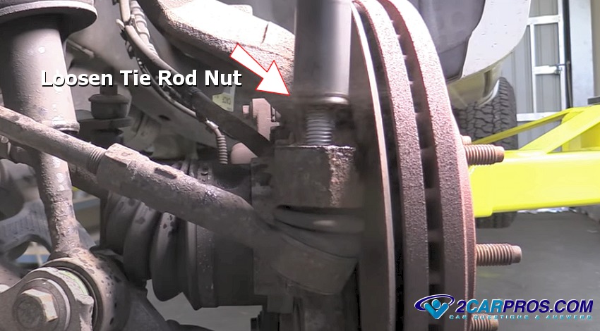

In most cases you will need to remove the tie rod end from the spindle to add room allowing the removal of the strut assembly. This is a taper fit part and will need to be released before it will come undone which we will show you in the next step.
loosen tie rod nut

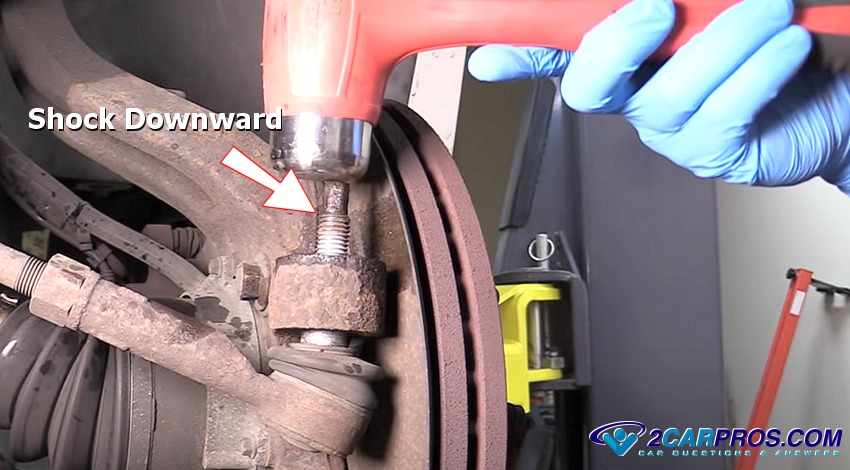

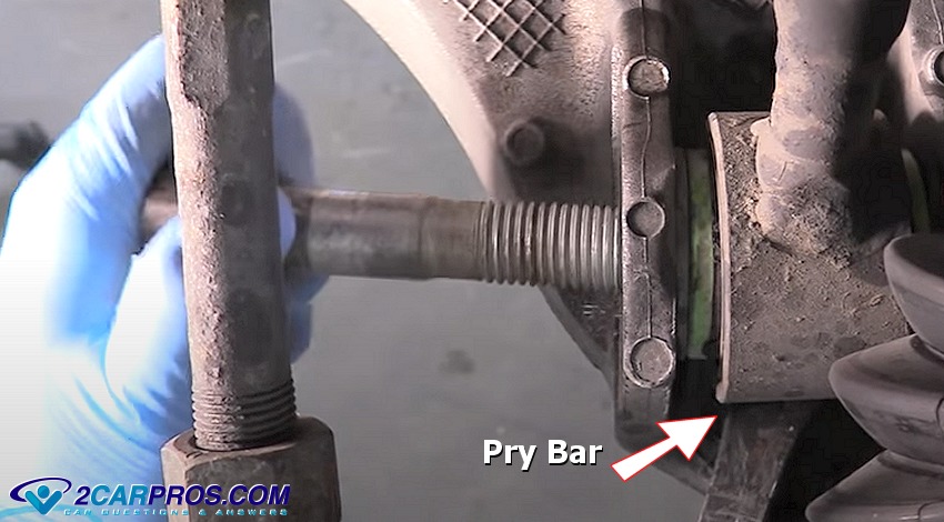

Here, the tie rod taper fit is being "shocked" to force the removal. Hold pressure downward with a breaker bar while protecting the thread by leaving the nut (loose) over the threads (not shown). In this case the taper fit was loose enough to where it was easily removed, but this is not always the case. If you have trouble removing the taper fit check out this taper fit removal guide.
remove tie rod

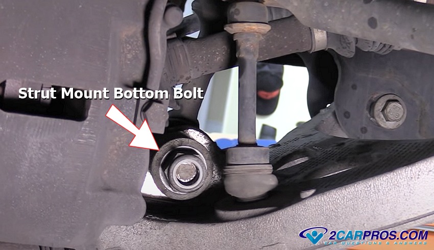

There are two sides of the strut that must be removed, the top and bottom mounting bolts, this shows the bottom nut location which needs to be removed, in this case it is a 21mm (nut size).
strut mount bottom bolt
To remove the bottom bolt you will need to relieve a slight amount of tension from the lower control arm by using a breaker bar.
bottom strut pry bar

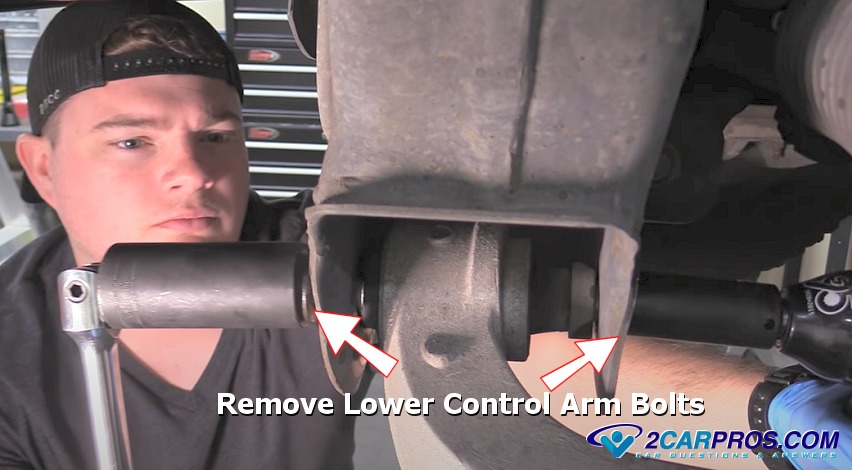

Before the top strut assembly mounting bolts are removed the lower control arm nuts and bolts must be removed. Sometimes it might be easier to remove the lower spindle ball joint which has a taper fit, but not in this case. There will be two nut bolts assemblies, be sure to see the alignment markings before you remove them, this will help you keep the alignment specs upon reassembly.
remove lower control arm bolts

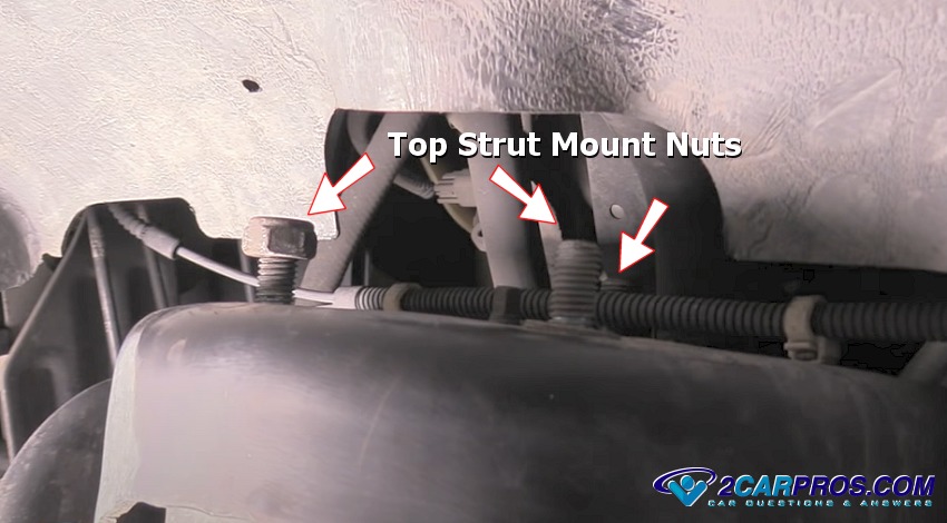

There are three upper mounting nuts that hold the strut to the frame or body of the vehicle, these are the last attachments before the strut can be removed, in this case they are 15mm. It is a little difficult to see the third nut because it is the most inward of the three.
top strut mount nuts

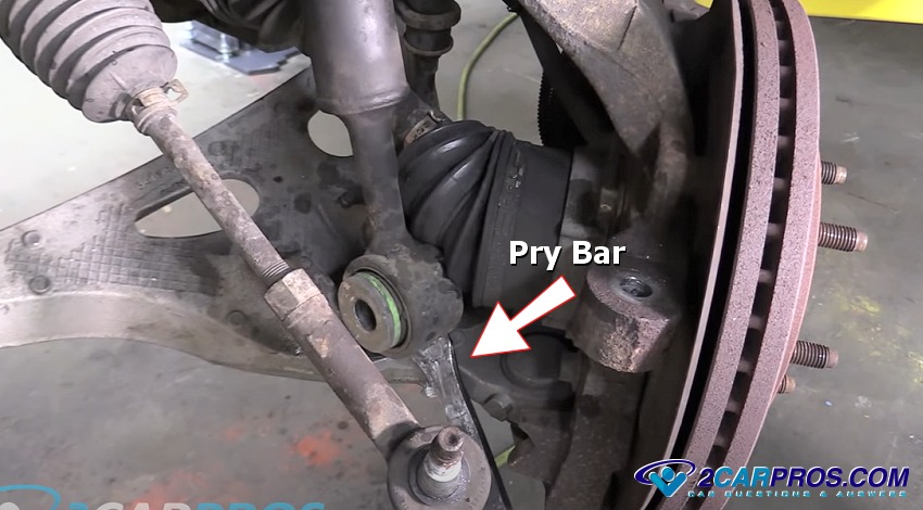

Use a large pry bar to dislodge the lower control arm, then move to the lower strut mount again using the pry bar. As in any suspension replacements a large pry bar is a great help and is highly suggested.
removing strut pry bar

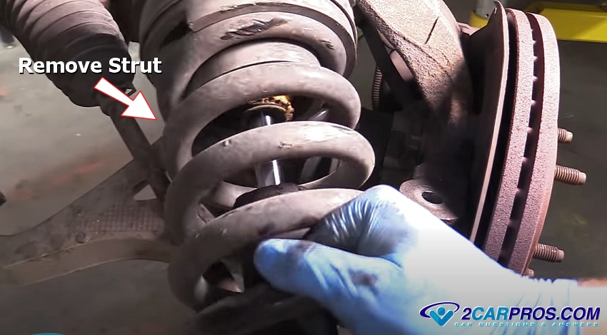

Obtain clearance using the pry bar on the lower control arm to help dislodge the strut, be sure to grasp the strut firmly as to not drop it, remove the strut and spring from the vehicle.
remove strut
