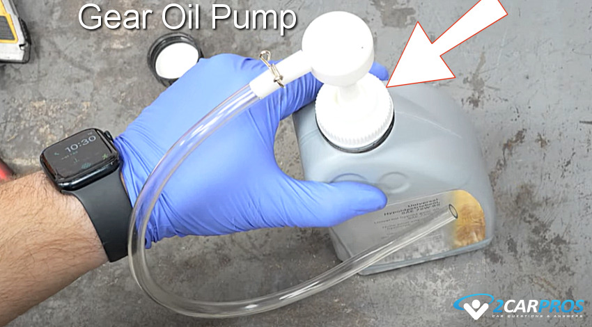

3. Prepare Gear Oil
Gear oil usually is purchased in quarts, its a good idea to purchase an inexpensive pump to make the job easier like in the image below. Use the correct type of gear oil specified in your vehicle’s manual.
gear oil pump

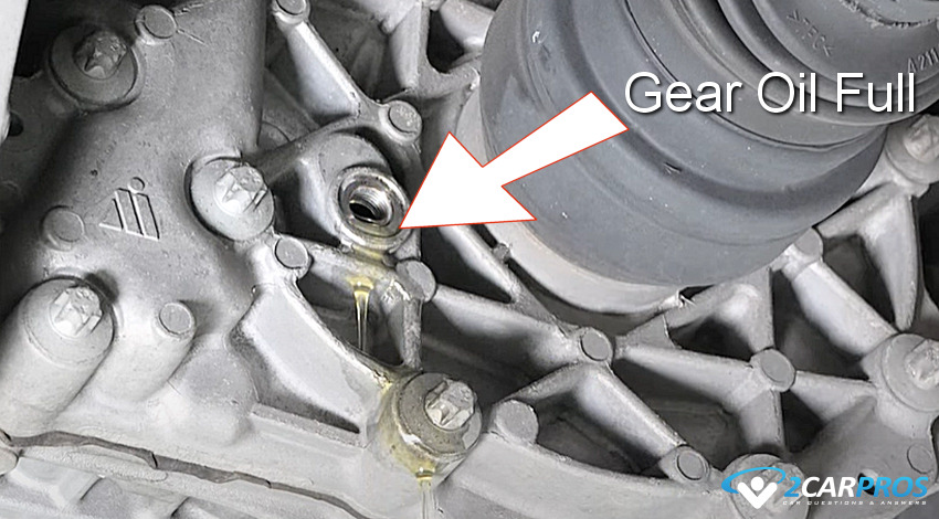

4. Add Gear Oil
Insert the tube into the fill port and continue adding fluid until it spills out from the service port. This is what it will look like once you have enough gear oil inside the differential, reinsert the fill plug by hand to avoid cross threading, finish by tightening the plug. Clean the excess gear oil from differential using a shop towel.
gear oil full
