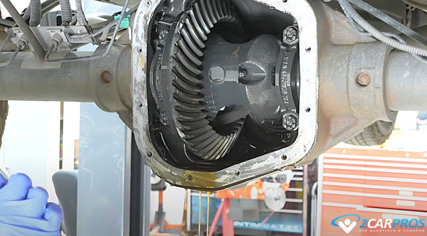

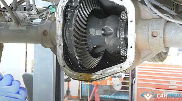

1. Drain the Fluid
Start by locating the rear service cover or drain port of the differential. Some units utilize a drain plug located at the bottom of the housing which can be simply removed to allow the gear oil to drain out. Others are designed with a rear cover that must be removed to start the service. Position a liquid drain basin directly under the differential housing and start removing the cover bolts or drain plug.
While removing the bolts, leave a couple loose without removing them, this will help support the cover once the remainder of the bolts has been removed. You can use a screwdriver to help separate the cover from the differential housing and start the gear oil flowing. While keeping a grip on the cover remove the remaining three bolts and allow the cover to fall away from the housing exposing the inner workings of the differential.
Use a shop towel to wipe down the bottom of the housing, and then locate the magnet located inside the cover or housing which is designed to trap any loose metal particles that may be suspended in the gear oil and clean that as well, (Brake cleaner and a shop towel works well for this).
remove cover drain differential gear oil

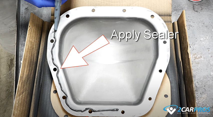

2. Prepare Differential Cover
Clean the cover by scraping the metal surface free from old gasket material. If a new gasket is not available, use gasket sealer and apply it to the cover inside of the bolts holes to help prevent leaks.
apply cover gasket sealer

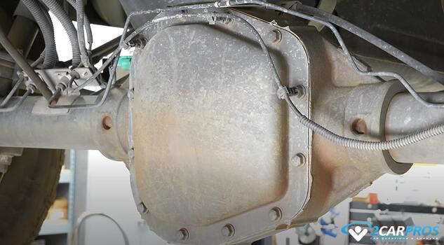

3. Reinstall the Cover
Clean the gasket mating surface of the differential free from old gasket and oil. Hold the rear cover in place start each of the cover bolts and tighten them by hand in a cross pattern. Once complete finish tightening the bolts, you don't want to over tighten these bolts because it will distort the cover and cause the gasket to split and leak.
reinstall differential fluid cover
