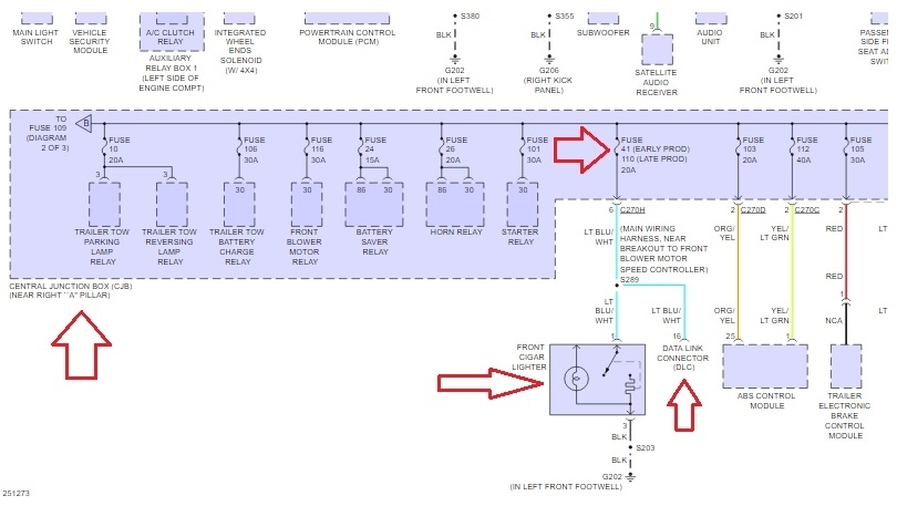

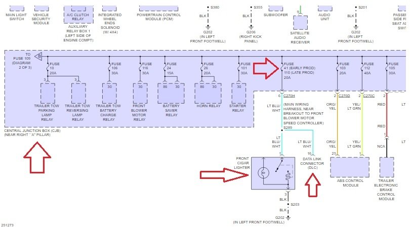

I grabbed you part of a Prodemand diagram.
Click on it below.

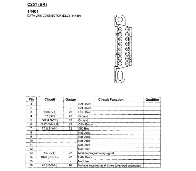

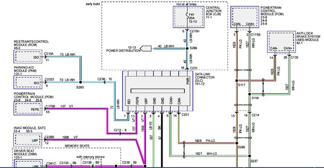

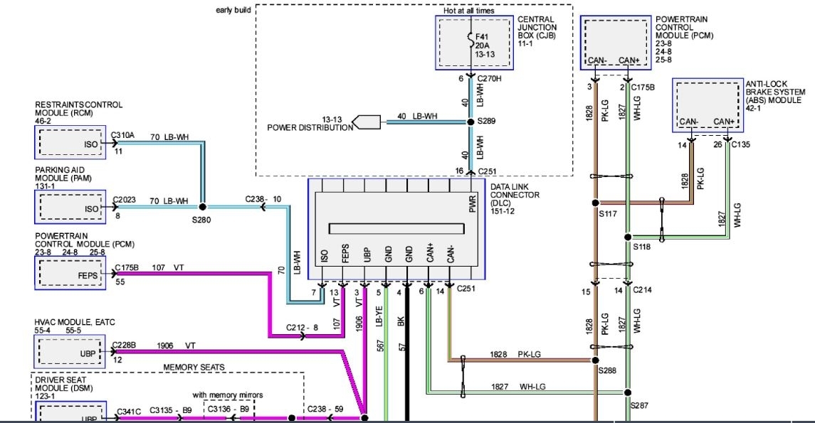

I could not read CJ diagram but I attached my own along with the schematic for the connector as well.
Go to the fuse listed and make sure you have power on both sides of the fuse all the time. If you do not, that would account for the issues you have.
Lets start there.
