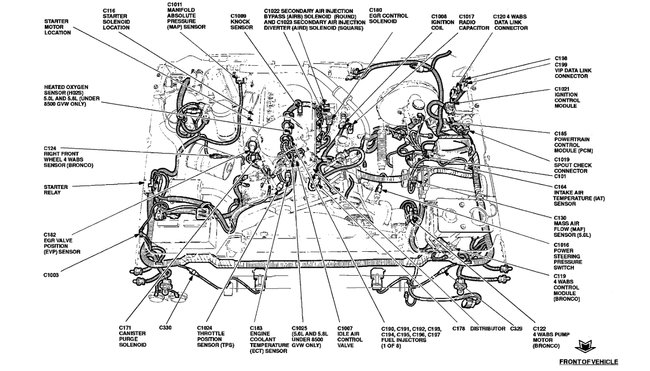

Can you please give me the PCM location?
May 4, 2008 at 10:24 AM
  • 75,992 POSTS
The PCM is located under the power brake booster half in and half out of the firewall Here is the location diagrams below. Check out the diagrams (Below). Please let us know if you need anything else to get the problem fixed. Cheers,

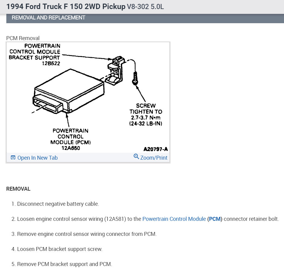

VIRGINIAJONES
thankyou so much! I found it, but now I need to know how to remove it please.
Nov 23, 2018 at 1:55 PM (Merged)
HMAC300
  • 48,601 POSTS
there is an electrical connection to unplug as well as few bolts probably. why do you want to removei tin the first place. you'll have to scan for codes first to see if it is bad or a sensor. we don't show a pic of this so it's hard to describe not seeing something that old.

no its on the left side firewall by the brake booster and wiring harness

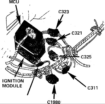

1983 ford f-150 302-2bbl does this vehicle have an engine control module(computer)? and where is it located? ty
  • 75,992 POSTS
LH Inner Fender Well.
Above Ignition Module
Applicable to: 1981-83 w/MCU

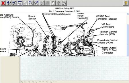

TOMMIZON
Computer problem
1993 Ford F150 V8 Two Wheel Drive Automatic
where is the ECM
  • 75,992 POSTS
PCM see below

I am trying to find out the location of the ECM/PCM on a 1996 Ford F150, can you help?
  • 75,992 POSTS
The Powertrain Control Module is located at the LH side of the safety wall.

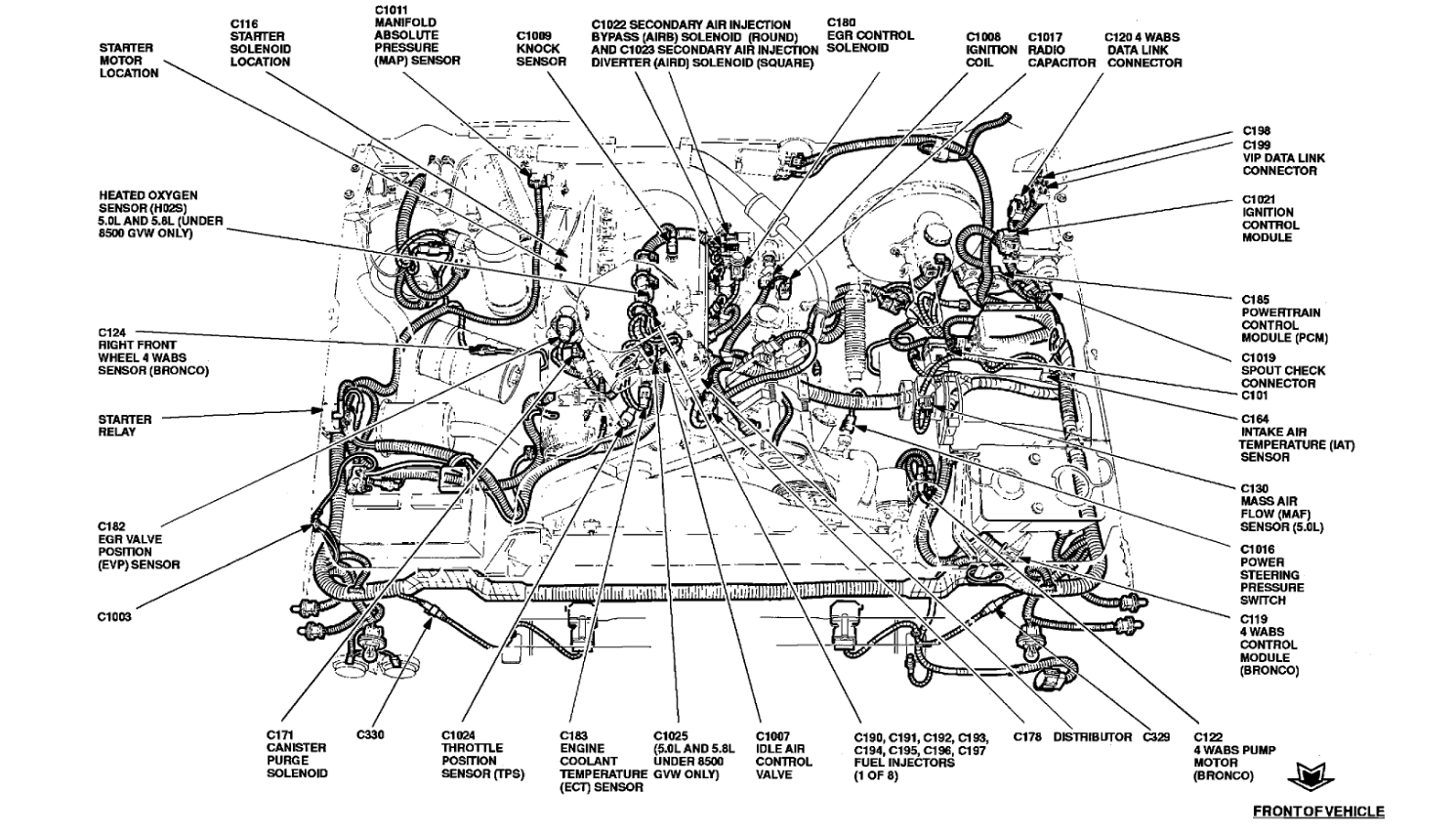

INDYUKE
  • 416 POSTS
The PCM is located behind the drivers side kick panel just ahead of the door. Remove the door panel and the PCM will be a silver box approx 1.5" x 8" x 5" just below the level of the underside of the dash. The PCM fits into a slot in the firewall. If you open the hood and look down behind the driver's side wheel well, you will see the wiring harness that is bolted into the PCM through the slot in the firewall. Hope this helps.
