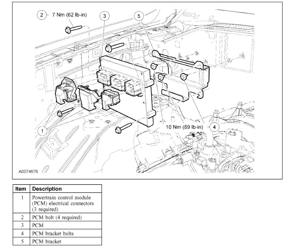

Where is the PCM computer module location?
May 5, 2009 at 8:26 AM
MERLIN2021
  • 17,250 POSTS

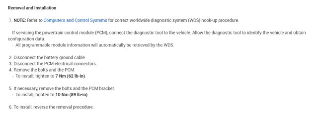

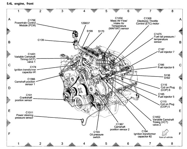

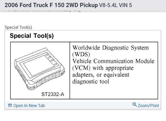

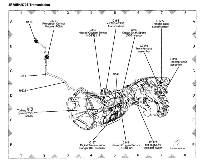

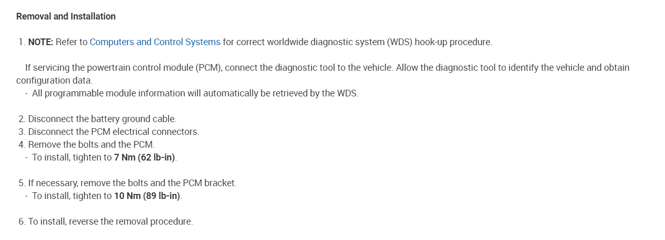

The PCM is at the right rear of the engine compartment here are diagrams that show the location and how to replace the engine control module. I would try a used or rebuilt unit so you don't have to get it programmed. A shop will charge about $130.00 for programming.

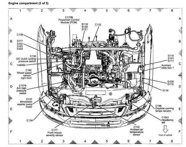

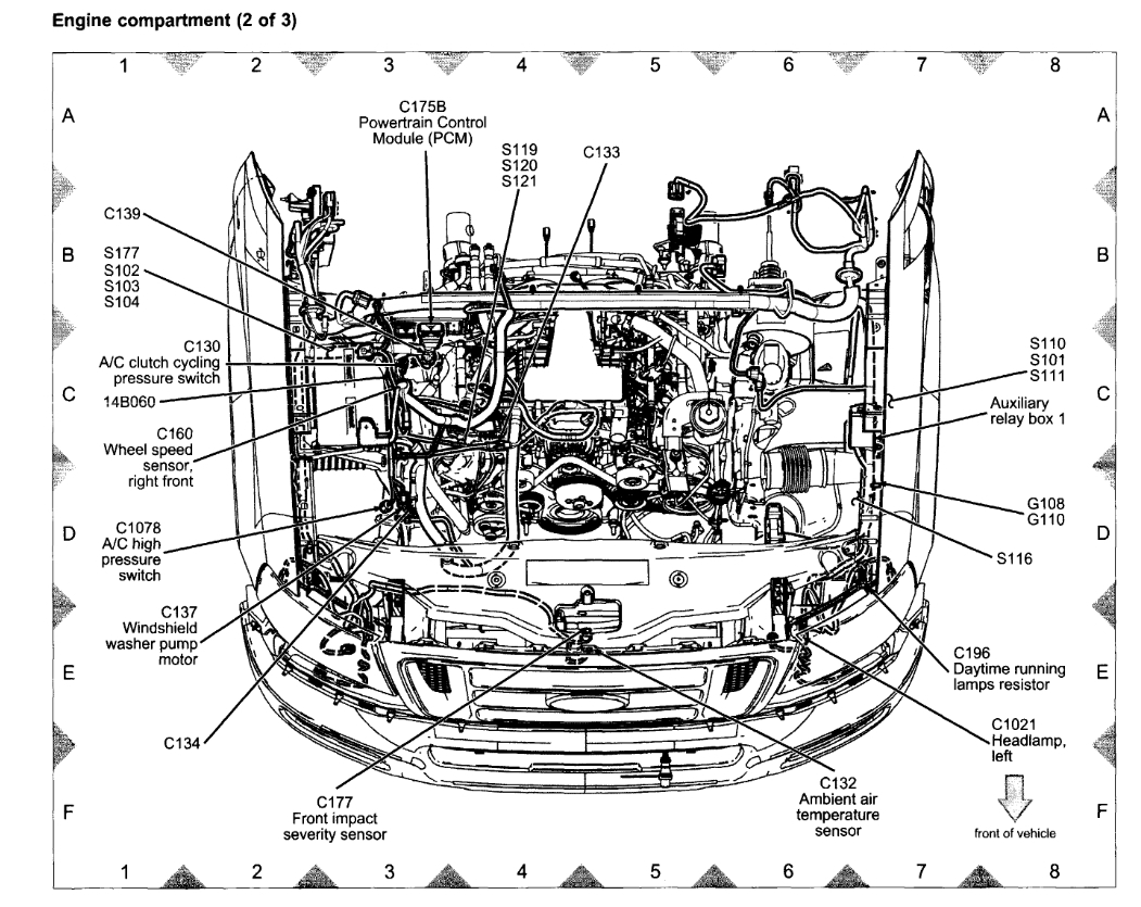

i have a 2005 and i cant find the computer to find the part number?
Dec 27, 2018 at 11:09 AM (Merged)
BMRFIXIT
  • 19,053 POSTS
Right rear of engine compartment under the hood
almost beside the battery in the fire wall
good luck
