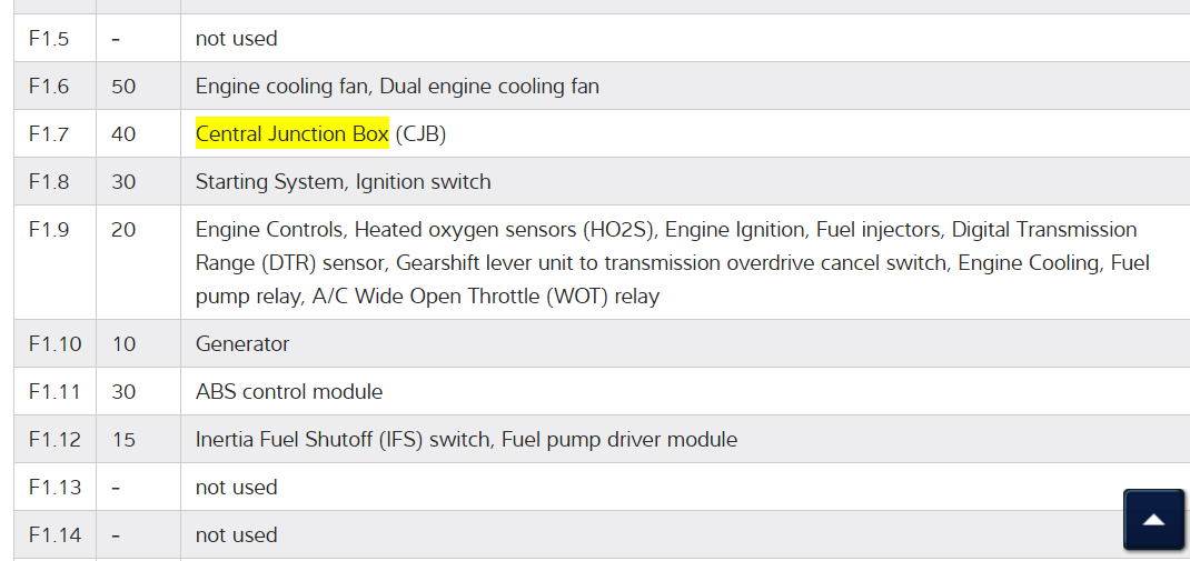

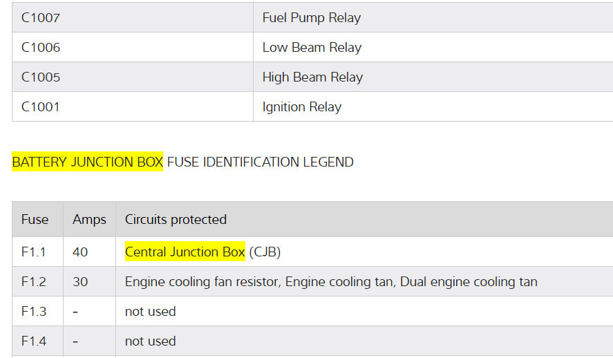

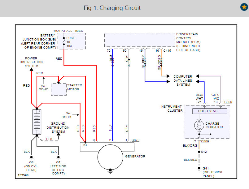

So my wires from my alternator and starter to my battery fell onto my EGR valve pipe 3 times with the last causing a small hole to be burnt into the pipe. The car made it home i turned it off and since then its ether cranked but no start or nothing. i have replaced all the wiring from starter and alternator the crankshaft camshaft ignition coil fuel rail harnesses the MAF sensor crankshaft position sensor every single fuse and relay under the dash and hood the plugs and wires the battery the starter the alternator and still nothing. when using a test light nothing under the dash in the fuse box lights up and under the hood in the relay spots only one area in some none in others lights up on the other side the big fuses all but the 1st 2 light up then below that the 1st 6 light up on both sides but the last 5 nothing and the single fuse by the relays f64 nothing. what more can i do to get my car going again? i just barely taped my horn and it went off uncontrollably to where i had to unplug it. i am at a loss what do to do.
Sep 30, 2019 at 9:43 AM
SCGRANTURISMO
  • 4,897 POSTS

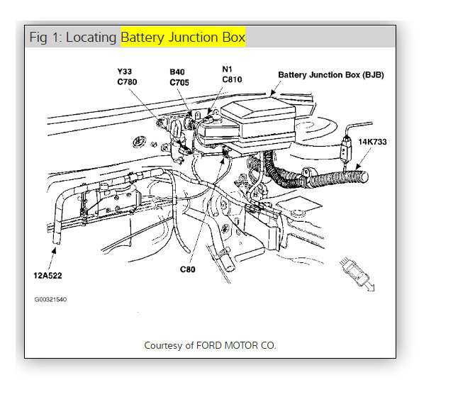

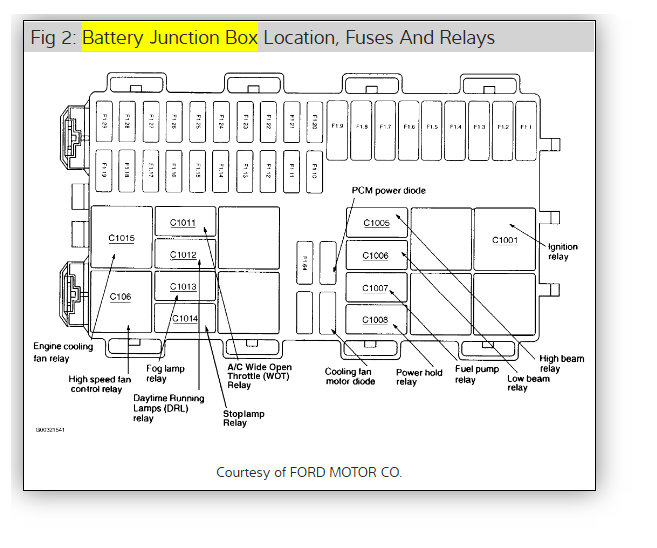

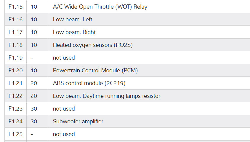

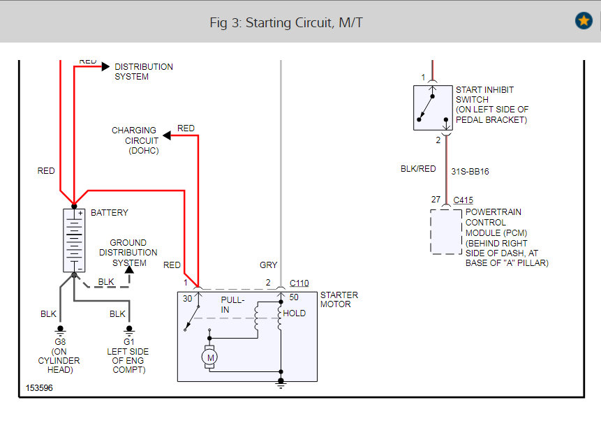

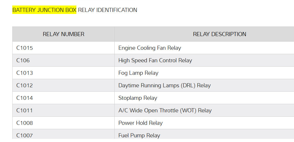

Okay, in the diagrams down below I have included the wiring diagrams of the starting and charging system of the diagrams down below. I have also included a diagram and callout of the Battery Junction Box. If you could please check fuse #8(30A) of the Battery Junction Box. Here is a link below for how to check a fuse, if needed:
Please get back to us with what you find out and we will go from there.

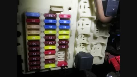

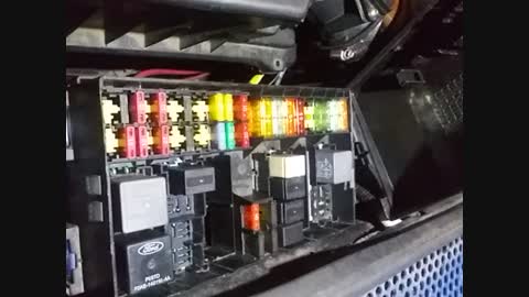

As i said every fuse and relay both under my hood and dash has been replaced with brand new ones. when using a test light on the fuses to see which ones light up the first to the 40 in the 30 do not light up at all. the next 50 40 30 and 20 big ones light up just fine. then the next 210 the two twenties the 30 and the 15 light up just fine. the bottom tens the five tens does not light up. the 40 does not light up and as far as the relays go in certain spots when I test down inside underneath them once I would light up the rest will not that's all for under the hood for right now.now I'm going to go under the driver side dash and show you the other one.

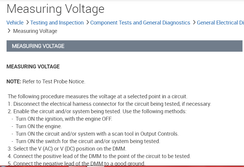

Okay, let's start with the basics. Can you please take a voltage reading across the two battery terminals with a Digital Multi-meter (DMM). If you are unsure how to use a DMM here is a link below:
I have also included a guide below explaining how to read voltage on a DMM in the diagrams down below. Report back with what you find out and we will go from there.

Okay, so i went out there and my volt meter has a few settings on DC i tried them all and soon as i put the leads on it on any setting for DC it made them very hot and gave no reading. so i brought in my battery put it on my charger and it say 13 .6.
Oct 11, 2019 at 12:23 AM
VERONICA WIMMS
  • 144 POSTS
So what are your thoughts now and my dmm has several dv settings? its a innova dmm. i tried it on all settings and it got the meter ends very hot fast and gave no reading. i was supposed to touch the terminals on the battery not the actual terminals right?
Oct 12, 2019 at 6:24 AM
SCGRANTURISMO
  • 4,897 POSTS
Hello again,
Sorry for the delay. Your DMM should be set on the 20 volt DC setting. This is because an automotive battery, fully charged should have 12.6 Volts. Six cells, each cell containing 2.1 Volts. You can touch the battery posts preferably, but you can touch the terminals as well if the battery is hooked up. There should be absolutely no reason for the DMM probes to get hot.

Okay, i was just curious on that, but i went out and i did the dmm on dc on all the dc points and my battery is reading 12.45 on all dc points. now what do i do?
Oct 14, 2019 at 6:11 AM
SCGRANTURISMO
  • 4,897 POSTS
Hello again,

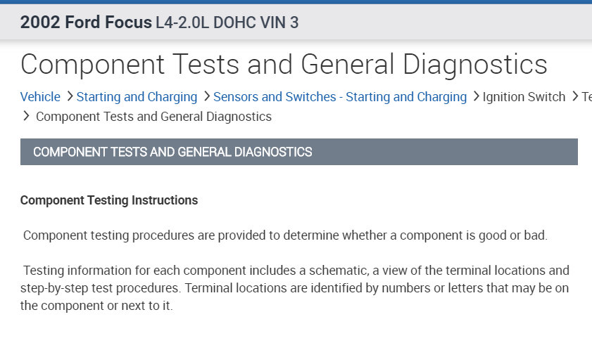

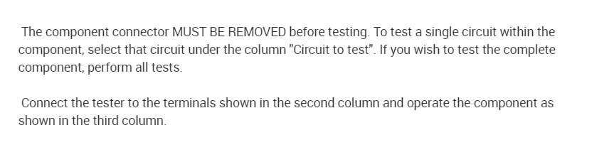

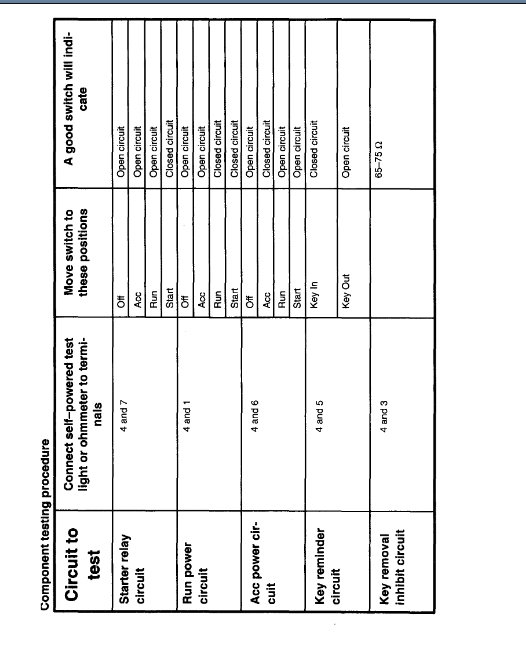

Okay, that's good. Your battery is about 75% charged, so it's not the problem and Fuse 8 is okay. So let's work our way back to the starter from the battery. Next on the list is going to be the ignition switch. In the diagrams down below I have included the factory troubleshooting guide for your vehicle's ignition switch. Please go through this guide and get back to us with what you are able to find out.

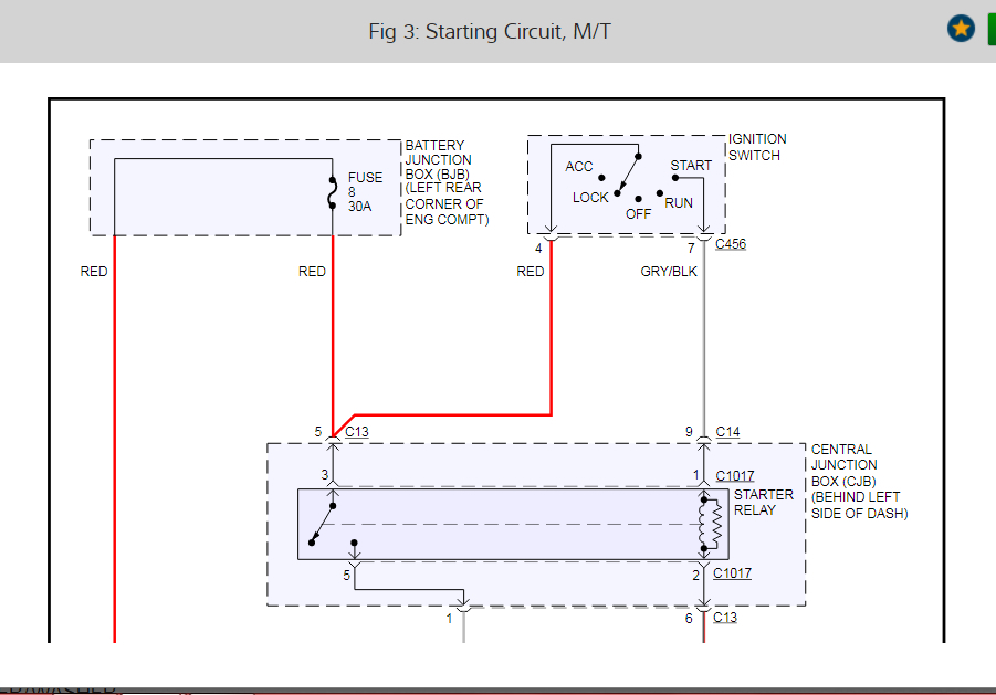

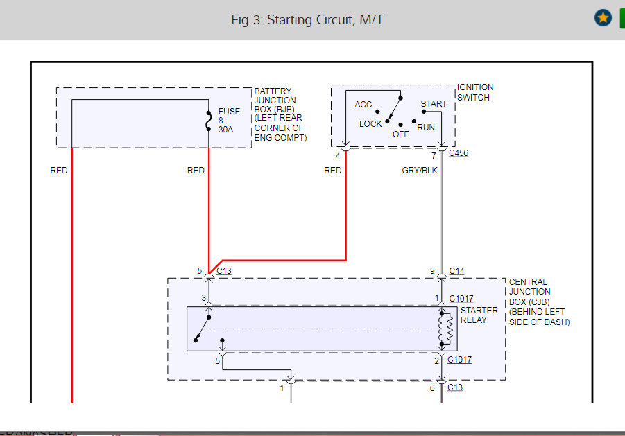

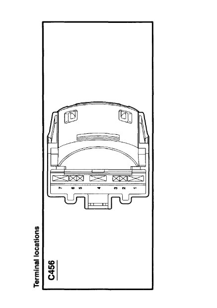

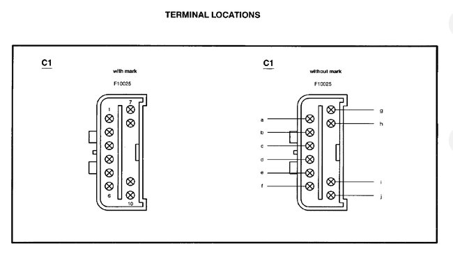

So do i do these tests to the actual ignition itself or to the fuse box? I did however just take off the alternator and had it tested and it was good. my starter is brand new in fact it hasn't started since it was replaced. I was looking back at our previous messages and the one with the fuse box under the hood that you displayed is similar to mine but not exact. so i am lost on where my number 8 fuse would be or is. I do not know if this is even relevant at this time also my ignition has a rubber ring around it that has got a bend in it and it wont flatten out. is this a possible issue? also the other day i accidentally hit my horn and now it wont go off. so had to unplug it. what are your thoughts on this as well?
Oct 14, 2019 at 4:53 PM
SCGRANTURISMO
  • 4,897 POSTS
Hello again,

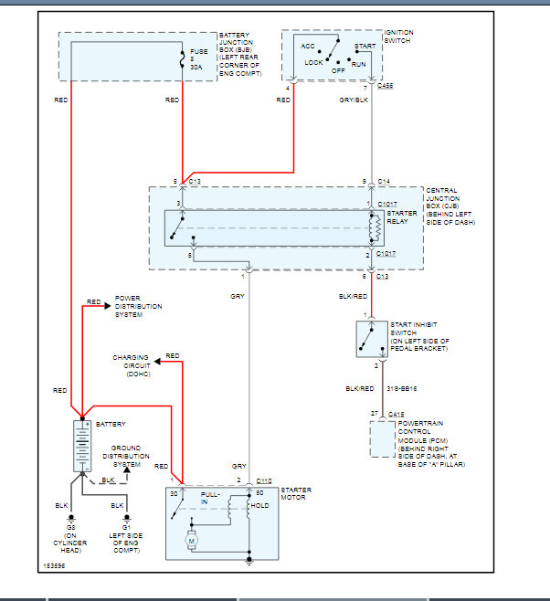

Okay, so where are we. Okay, so we are not sure on fuse 8. Okay, let's start over. In the diagrams down below I have included a wiring diagram of your vehicle's starting circuit. This is going to be what we are going to be working off of, so we are on the same sheet of music, so to speak, and we both have a common point of reference. Don't worry about reading it, that's what I am here for. I will explain what needs to be tested and why we are testing it. This is going to be a systematic process of elimination that will lead to the problem, so please, one thing at a time. Okay, look at the wiring diagram and locate the battery in the lower left hand side of the diagram and get back to us when you have got it, please.

Okay, i found the battery in it. now what do i do?

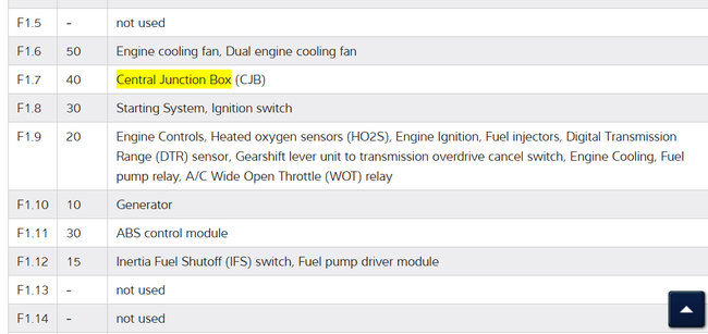

I hate to annoy you, but i am at a loss as to how to understand the wiring schematic. however i can say that in the fuse box under the hood the number 7 and 8 being the first 2 at the top on the left being the larger sized fuses 1.a 40 2.(8) a 30 do not light up at all when using a test light. do i take out these fuses and put the dmm in it to test for a reading?
Oct 20, 2019 at 2:17 AM
SCGRANTURISMO
  • 4,897 POSTS
Sorry for taking so long to get to you. I've been preoccupied dealing with a personal matter, and I apologize. Okay, so you've identified the battery on the wiring diagram. Next follow the red wire all the way to the left coming from the battery going towards the top of the page to a perforated box. On the right hand side of the perforated box it says Battery Junction Box [BJB] and then gives it's description in your vehicle. This represents a red wire coming from the positive battery terminal go to the Battery Junction Box [Fuse Box] in your vehicles engine compartment. In the perforated box is a representation of the wire continuing and then it goes to Fuse 8 in the BJB. Please check fuse 8 in your BJB. This is the next component the battery voltage must pass through to make it to your vehicle's starter. Here is a link below to a guide explaining how to test a fuse:
You should have a diagram and callout of the BJB in a previous reply. Go through the guide, locate and check fuse 8, and report back with what you find, and we will go from there, if needed.
