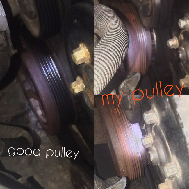

Okay, so I've been 664 miles. Was doing great.
Thursday I went to start it, it started right up but it made an awful squeaking noise - I popped the hood and noticed my serpentine belt was rotating super slow. And has also been spraying pieces of it all over.
I came to the conclusion it's the crank shaft pulley. Ive been told that those don't normally need replaced and if they do need replaced I have more problems than just the pulley and belt itself.
My question is, could the crank shaft pulley be a problem of its own?
Saturday, March 10th, 2018 AT 6:01 PM
  • 52,797 POSTS
Check the belt tensioner. It is a common failure and the belt would loose up and make noise
Saturday, March 10th, 2018 AT 6:07 PM
BREANNASMITHH
  • 27 POSTS
Did you see the picture I uploaded? The belt isn't touching the pulley itself.
Saturday, March 10th, 2018 AT 6:24 PM
BREANNASMITHH
  • 27 POSTS
Could it be the tensioner and the crankshaft? Both pulleys?
Saturday, March 10th, 2018 AT 6:25 PM
  • 52,797 POSTS
Yes it could. Remove the belt and see if the pulley is damaged
