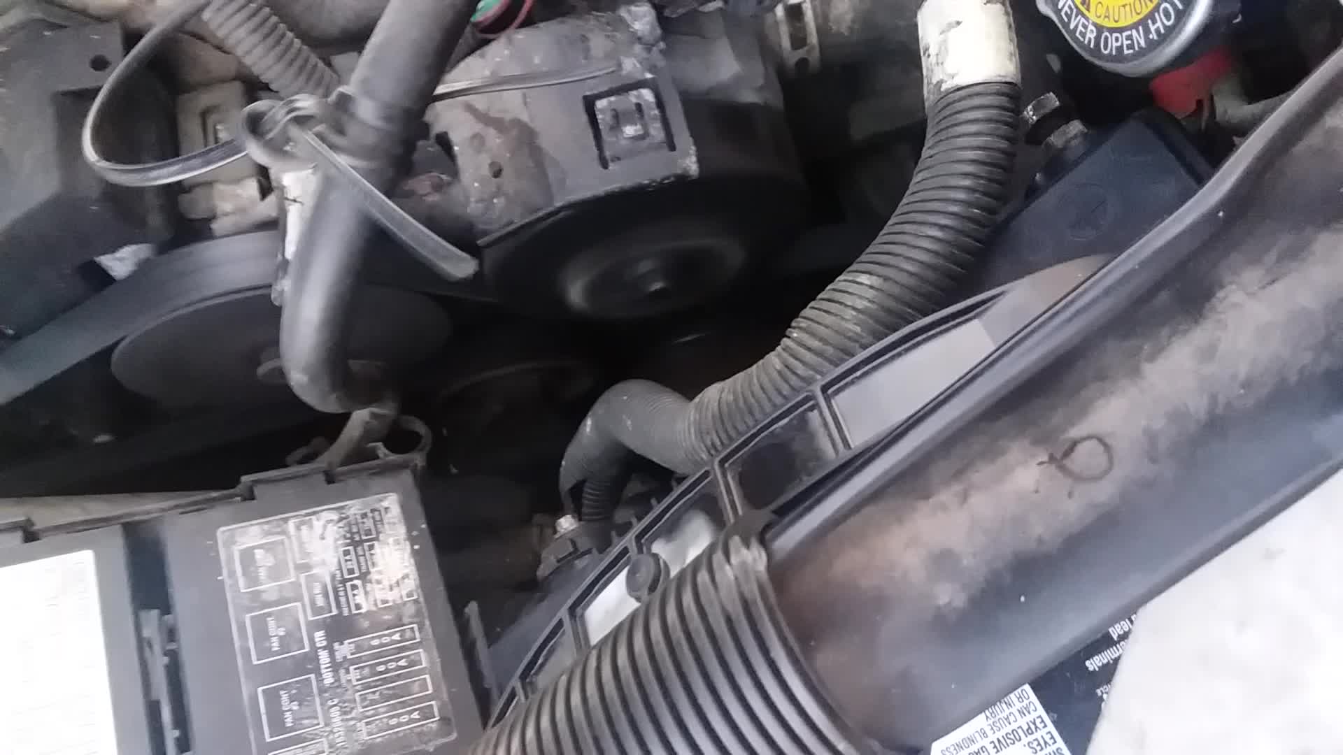

I have changed spark plugs and noticed a belt shredding and the shredding were wrapping around a threaded pulley type thing and seems to be coming off its bearing, I believe. i did some research and found out it is the idler pulley.
Would this cause such problems I am having? If not what kind of problems/symptoms would it cause?

okay, no the bad idler is not your issue. When it fails it will toss the belt off and the belt will get wrapped around everything.
never,ever use an impact on plugs, you will tear up the threads in the head.
