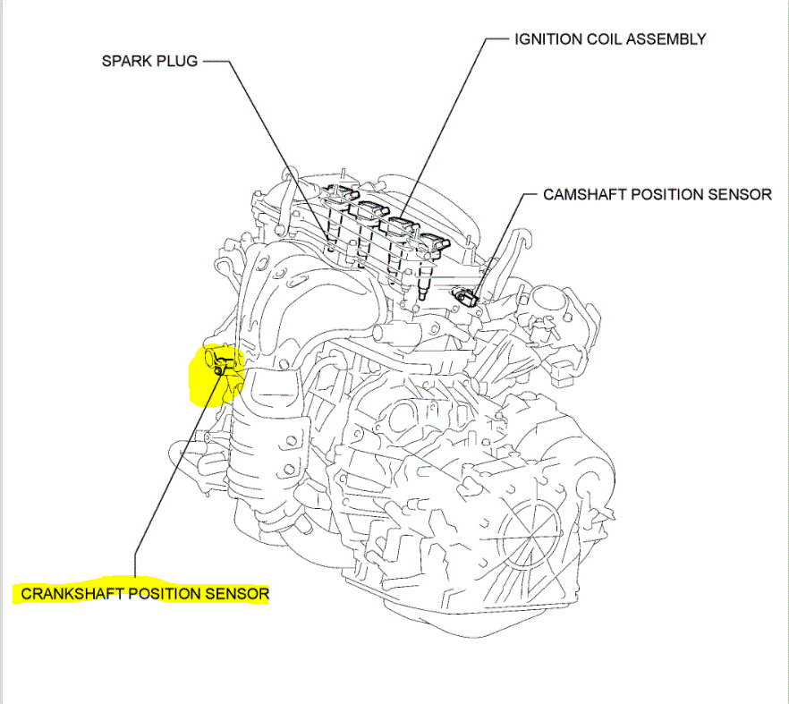

If my car has been sitting all night it will start right up if I drive it 5 miles shut off go inside gas station come out it will start . But if I drive 10 miles and I run into the store and come out my car will not start I try again right away you can hear it trying something is not connecting for the start . If I wait about 10 or 15 minutes and keep the cranking going it finally starts . I don't know what the issue is, but it is annoying and embarrassing to keep trying. someone please help
My dad suggested that it's the temperature service switch , my car is not overheating once it gets started it drives fine as long as I don't shut it off once I do then I have to wait and keep trying until it starts .

This could be a couple of things. The first thing that comes to mind is a faulty crankshaft position sensor. When they are going bad, heat can cause them to fail. Since it happens after driving and the engine is warm, it makes sense. Do me a favor. Take a look through this link and let me know if it mirrors what you experience.
Let me know. I attached a pic below showing the sensor's location on the engine. What I would suggest is to see if spark is lost to the ignition when it won't start. That is a good way of confirming the sensor is the likely cause. Here is a link showing how that is done:
