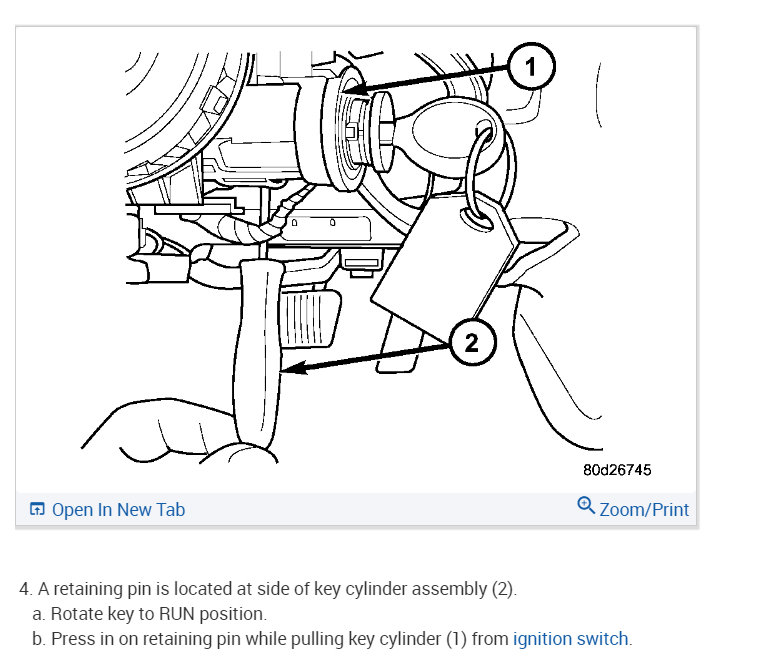

Lost keys to our vehicle listed above. Replaced it with Dorman Ignition Lock Cylinder 924-709 without relearning. The truck starts then shuts down after 30 seconds and now the engine light flashes after a chime is heard. Not sure what to do. Do not have fob or original keys. Please help. Thank you!

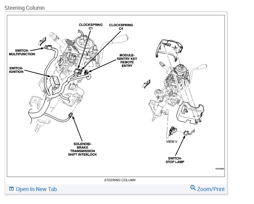

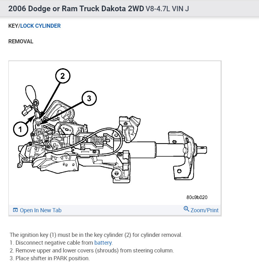

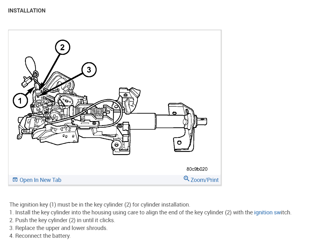

It sounds like you have a bad connection or the ignitions which is bad. Here is the correct way to install the switch but this can help as well:
SWITCH-KEY-IN IGNITION
DESCRIPTION
The key-in ignition switch is integral to the ignition switch, which is mounted on the left side of the steering column. It closes a path to ground for the Central Timer Module (CTM) when the ignition key is inserted in the ignition key cylinder and the driver door ajar switch is closed (driver door is open). The key-in ignition switch opens the ground path when the key is removed from the ignition key cylinder. The ground path is also opened when the driver door ajar switch is open (driver door is closed).
The key-in ignition switch cannot be repaired and, if faulty or damaged, the entire ignition switch must be replaced.
