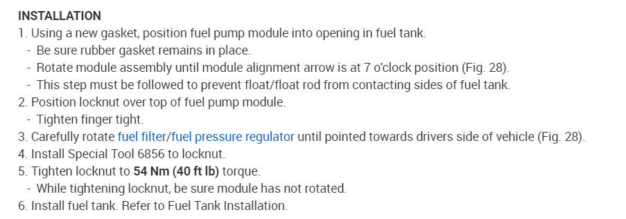

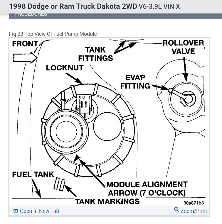

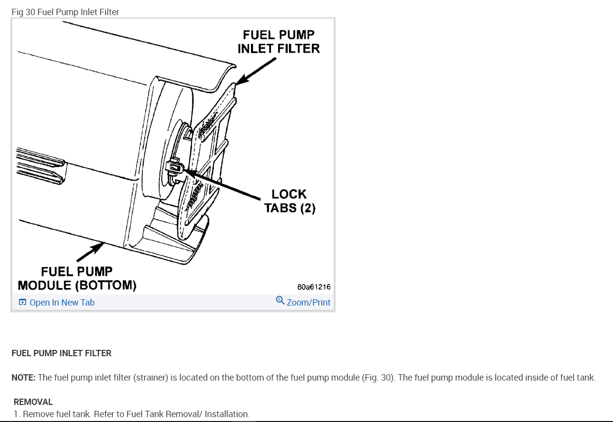

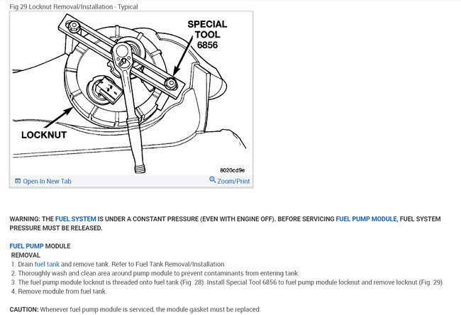

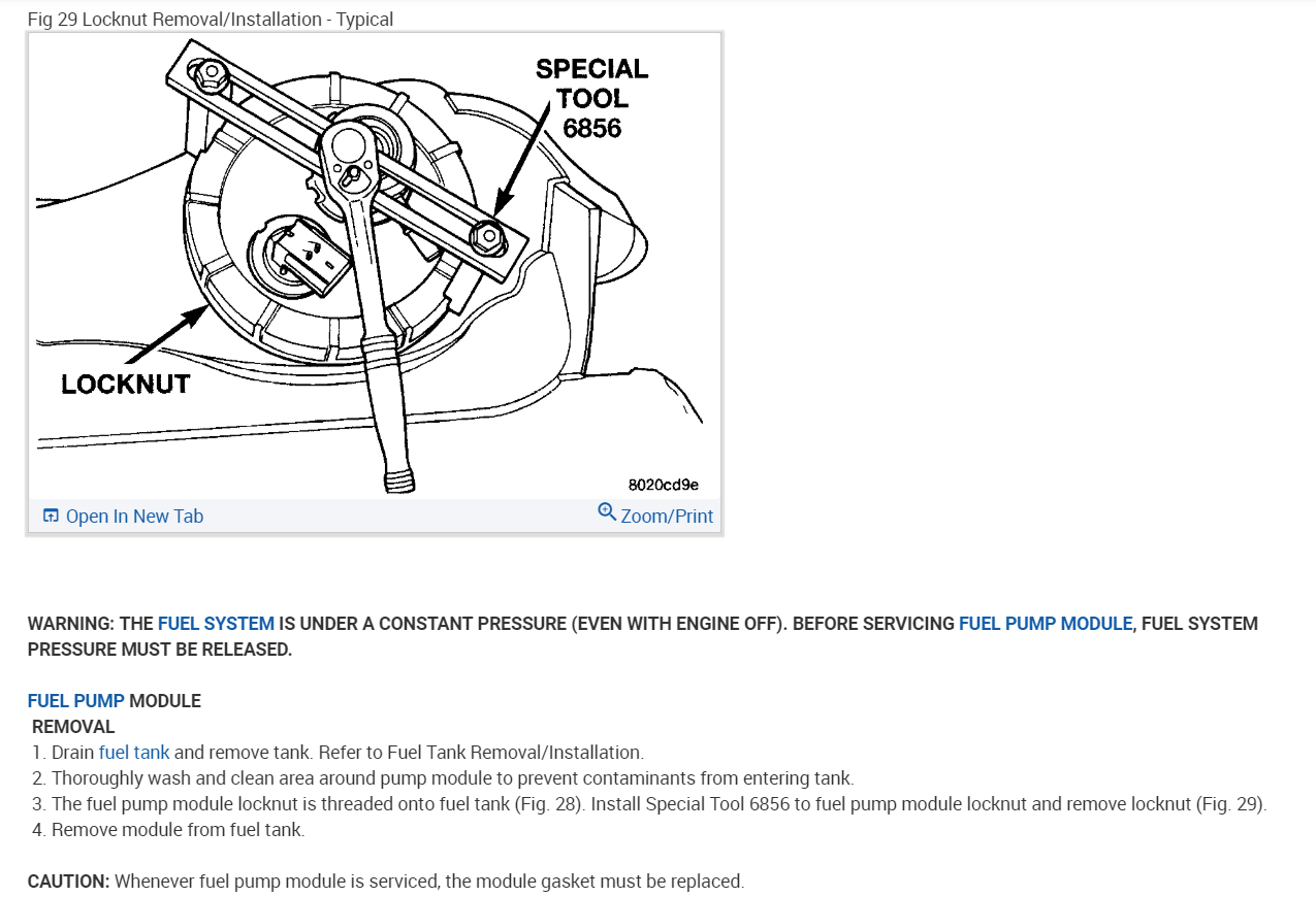

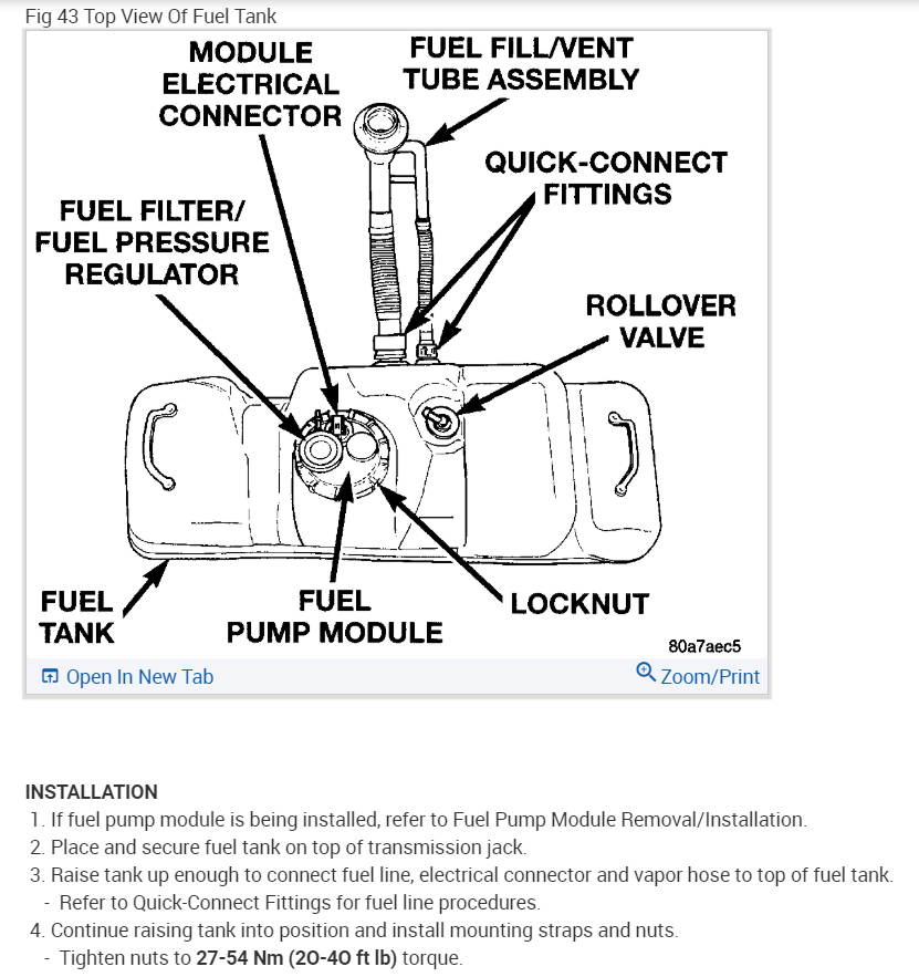

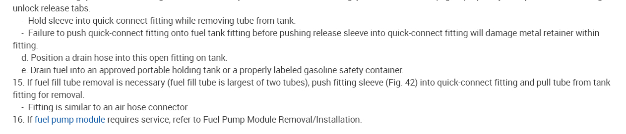

It sounds like you have a bad fuel pump, when the engine will not run can you spray starting fluid into the intake will it run? If so, I would test the fuel pump here is a guide to help and the steps on how to change the pump out with diagrams below to show you how on your car.
and
https://www.2carpros.com/articles/how-to-replace-an-electric-fuel-pump
Apr 11, 2022 at 5:01 AM

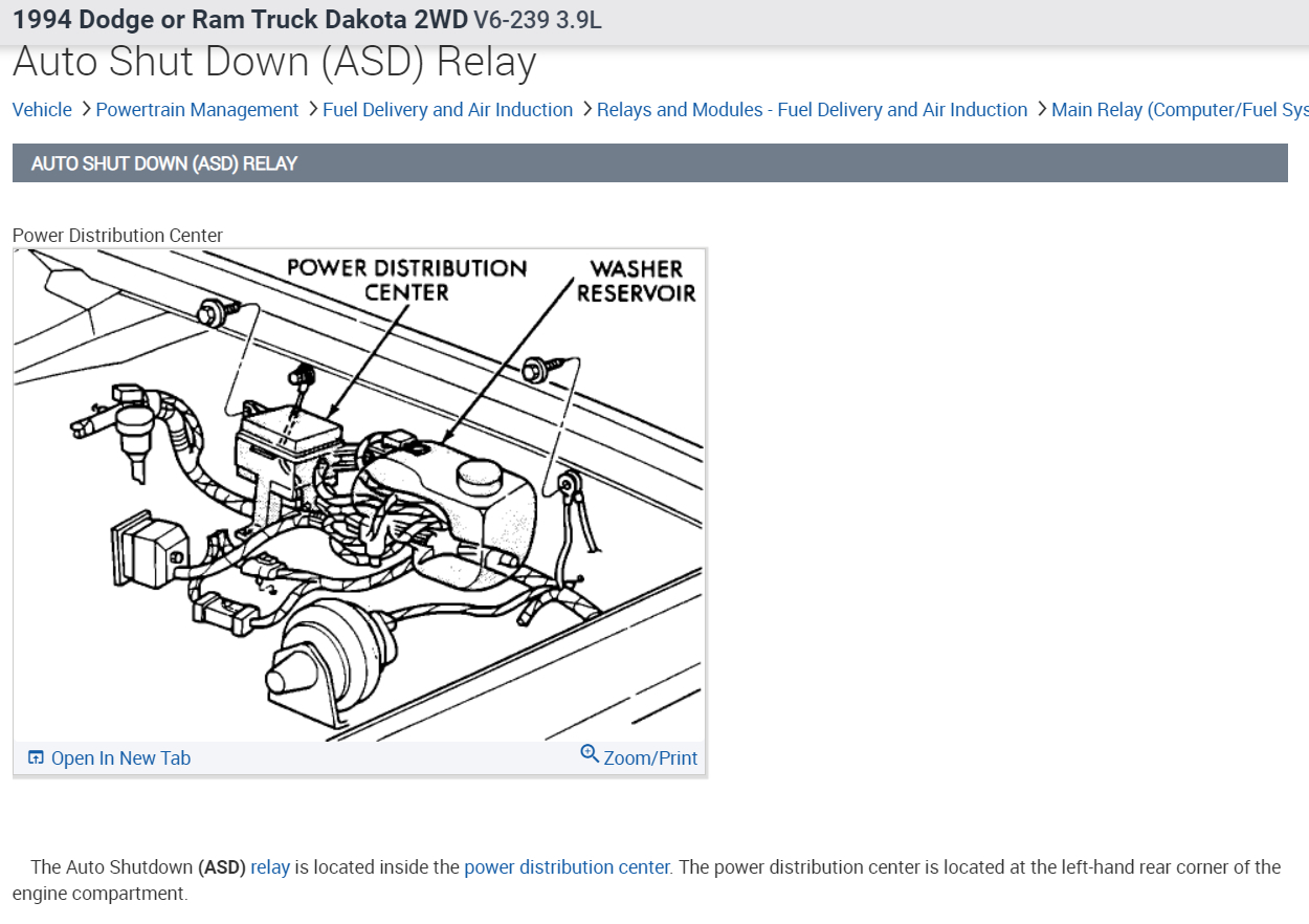

  • 55,721 POSTS
Okay, it sounds like you need a new ASD relay, here is the location so you can swap it out and a guide to help test it if you like:
Apr 12, 2022 at 5:04 AM

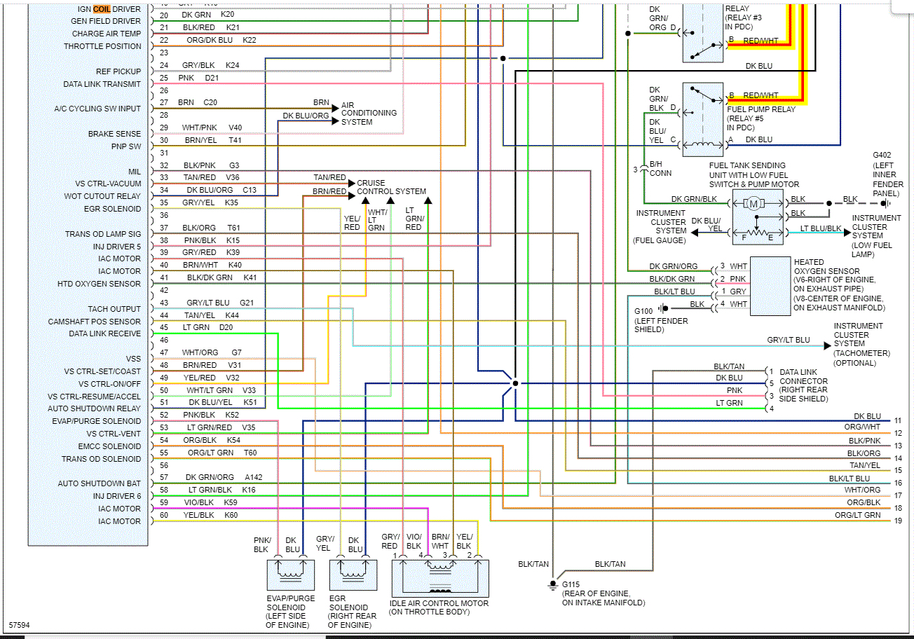

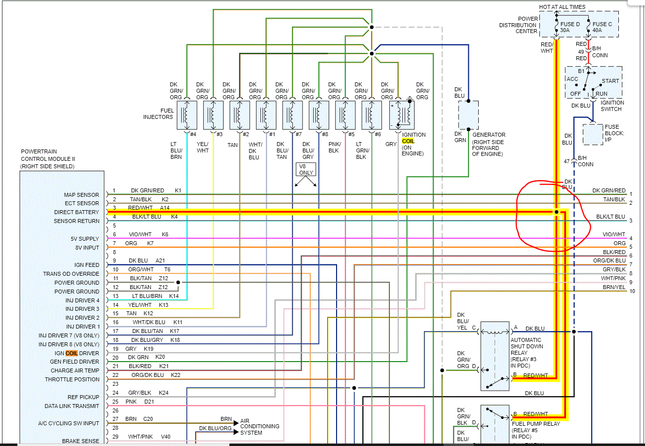

  • 110,248 POSTS
I noticed you haven't been contacted for a few days. Have you been able to make any progress?

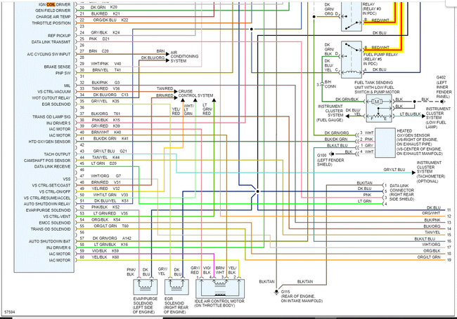

If not, I need you to check something for me. From the power distribution box under the hood (Fuse D / 30 Amp) is a red wire with a white tracer. This powers the ASD, coil. and fuel pump relay.
That particular wire has a splice in it that is known to fail. Usually, corrosion causes the issues. From memory, the splice is approximately two feet from the box. You will need to open up the main harness to locate it. However, based on everything that has been done, this is a good suspect.
I attached the wiring schematic below and circled the splice I'm referring to. Try to locate and inspect that splice.
Apr 15, 2022 at 1:45 PM
LEROY399
  • 15 POSTS
I have replaced all the factory connectors with heat shrink soldered connectors.
Apr 15, 2022 at 10:39 PM

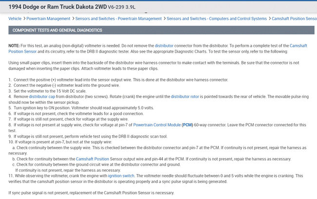

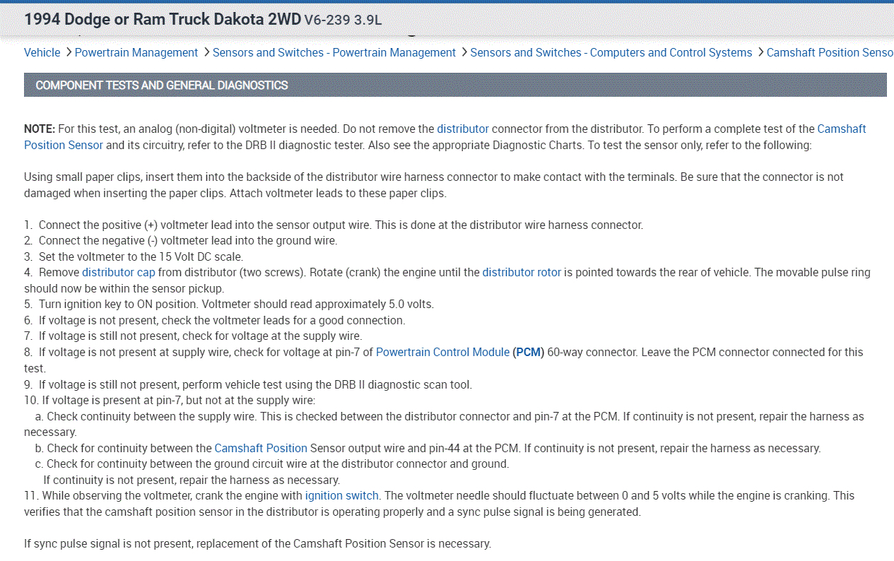

Okay. We need to go with the camshaft position sensor. I realize the part has been replaced, but I suspect the circuit is where the problem exists. If PCM does not sense input from the cam position sensor (which is what code 54 indicates), the PCM will deactivate the ASD and fuel pump relays, interrupting voltage to the fuel pump, fuel injectors, and the ignition coil.
I attached diagnostics below related to the code. Take a look through them and let me know what you find or what you have already found.
See pic below.
Apr 16, 2022 at 10:05 AM
LEROY399
  • 15 POSTS
Okay, I just got tired of working on it and let someone else work on it and it ended up been the ECM which makes the third time now.so far everything is good.

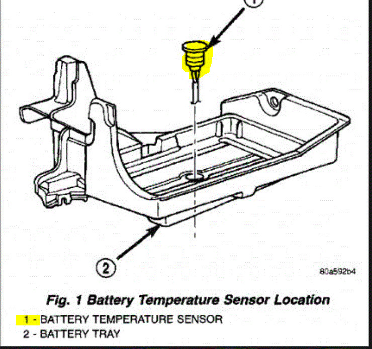

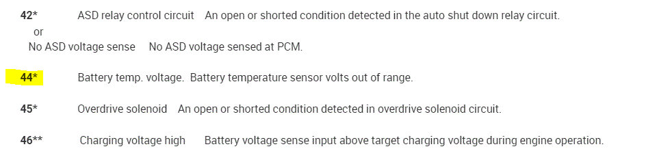

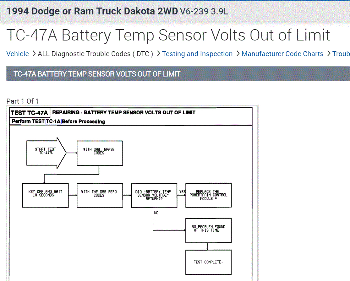

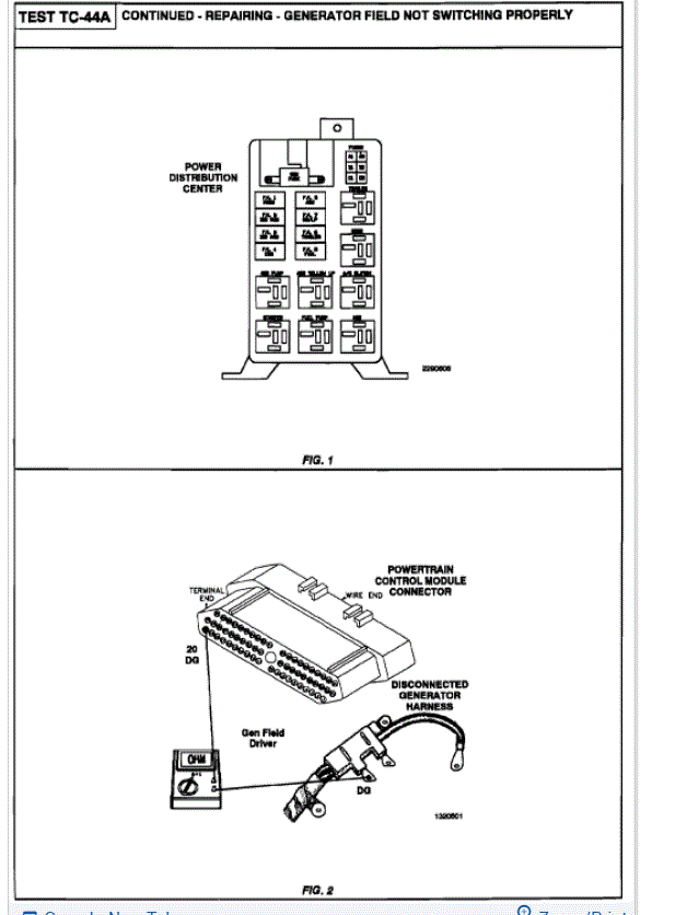

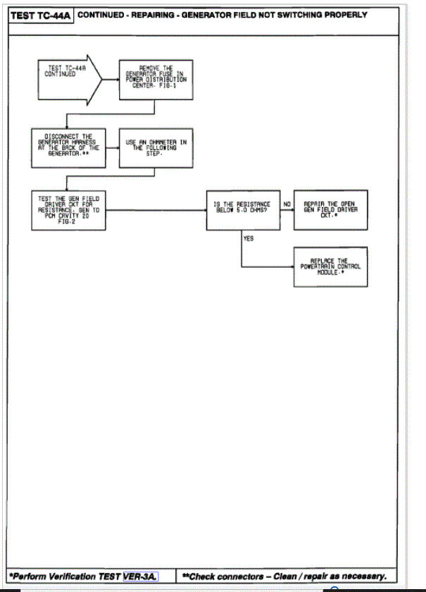

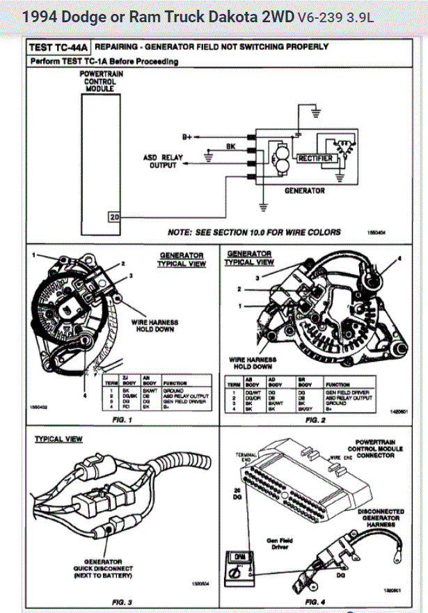

Can you help? I have fault code 44 on now. It has a new pin and new alternator. Can't fine any trouble shooting steps.
May 21, 2022 at 4:50 AM

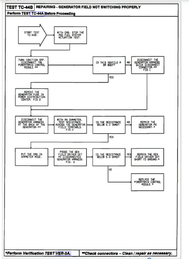

  • 110,248 POSTS
The code indicates an issue with the battery temperature/voltage signal (out of range) l. This sensor communicates with the PCM to indicate how much voltage is needed to regulate the battery, since the voltage regulator is integral with the PCM, the temperature of the battery is used to determine how much charging the battery receives.
I tried to find a pic of the sensor itself but can't find one for a 1994. The last pic below shows one on a 2001 Dakota which should be similar.
Now, with this code, the manual indicates one of three possible causes, the sensor, wiring, or the PCM.
If you look at pic 1, I provided the definition of the code. Pic 2 is the diagnostic chart for it. Let me know if this helps.
May 21, 2022 at 2:39 PM
LEROY399
  • 15 POSTS
The PCM has been changed out with a remanufactured PCM and I don't see a sensor under the battery or battery tray or any harness under there.
May 21, 2022 at 10:19 PM

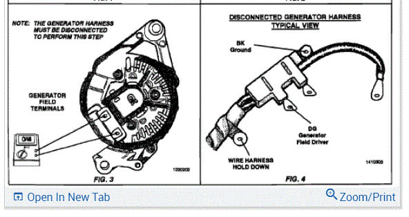

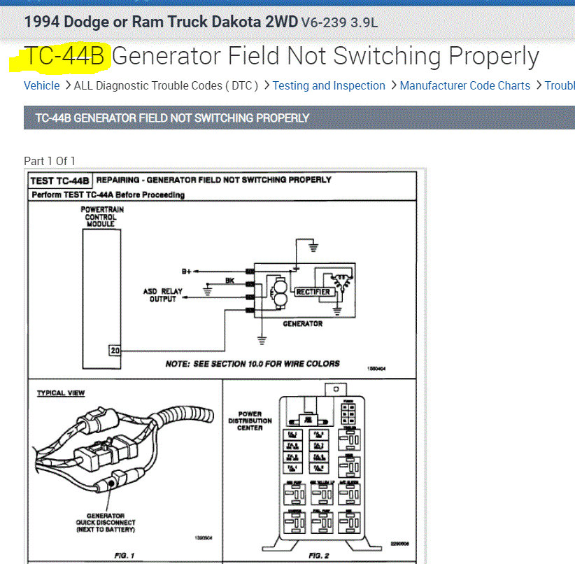

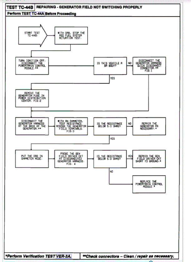

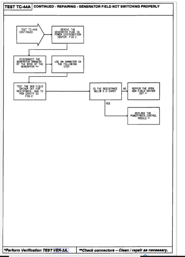

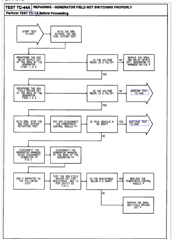

  • 110,248 POSTS

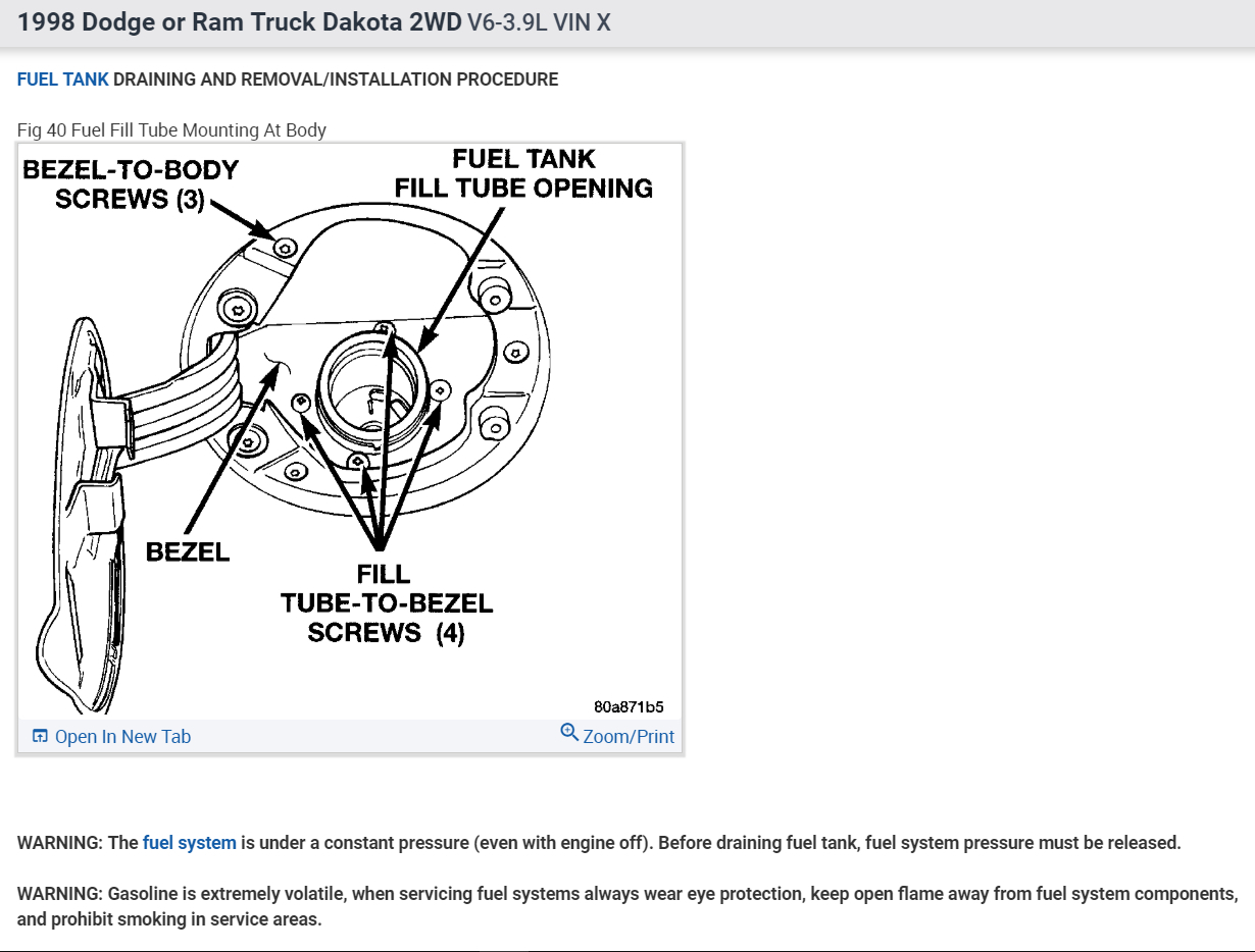

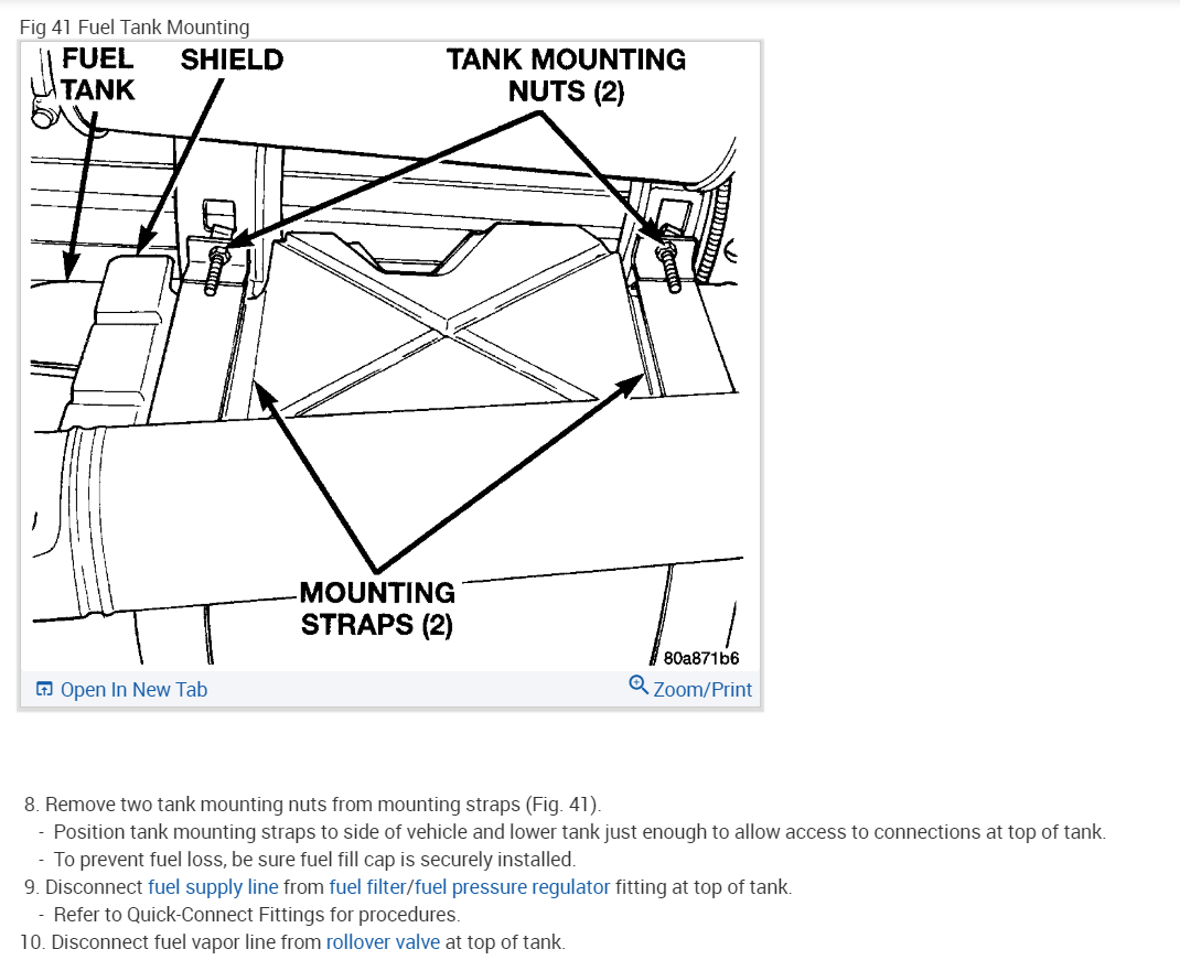

I dug deeper into the code and found there are three different codes 44, 44A and 44B. Two of them seem relevant because there is one specific to natural gas vehicles.
If you look at the first four pics below, they are the diagnostics for 44A. The remaining pics are specific to 44B.
Take a look through them and let me know if you are comfortable performing them. Also, start with 44A first then proceed to 44B if needed.
May 22, 2022 at 1:10 PM

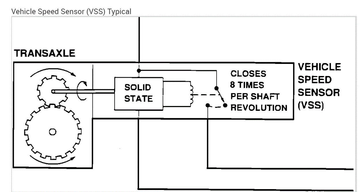

  • 15 POSTS
Okay, I went out the next day to drive it and there were no codes and it's been a week and still no codes. I bought a new tail shaft speed sensor it's a 35 tooth but I can't fine anything on how to set speed correct.
May 25, 2022 at 8:55 AM
  • 110,248 POSTS
Is that the same number of teeth that the original one?
As far as adjusting it, you can't. It works by producing a signal to the PCM. The PCM provides an 8v signal to the sensor which is a hall effect sensor that produces a magnetic field when turned. As the sensor turns, the magnet rotates and creates a magnetic field that opens and closes the contacts 8 times per revolution. That info is received by the PCM and determines the speed.
If you have a sensor with a different number of teeth, it will spin slower or faster than the OEM and the PCM identifies it as the speed of travel. See pic below
