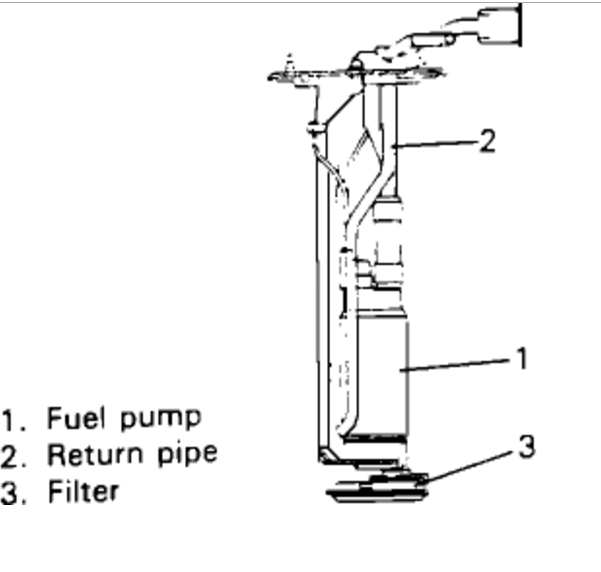

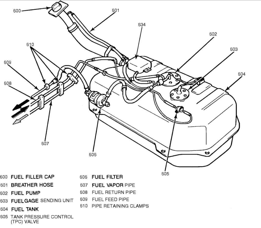

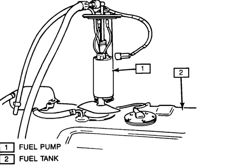

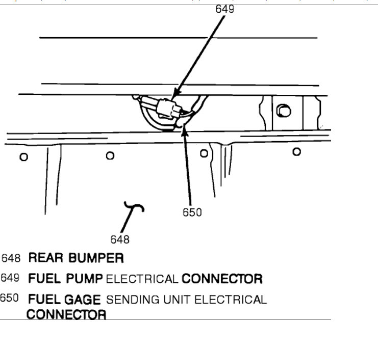

well i'm back guys, lol we are now down to the fuel pump, and some friends want me to check the fuel line, i don't know where that is, or my pump as my book shows way to many places it could be, do you know??? Hello guys are you there lol
Aug 31, 2017 at 10:01 AM
  • 55,433 POSTS
Yep sorry, the fuel pump is in the tank, Here is a guide and some diagrams (below) to help you get the job done.
You will need to jack the car up safely first.
Here is what you are in for when doing the fuel pump
https://www.2carpros.com/articles/how-to-replace-an-electric-fuel-pump
Sep 1, 2017 at 4:23 AM
HARRY P
  • 2,292 POSTS
I'm not sure what book you're looking in, but your car has the fuel pump in the tank, just like 99% of cars out there. Personally, before dropping the tank, I'd have someone turn the key on and while I listen to the pump so I can tell if it's at least trying to run. If it comes on then you should check the fuel pressure, as I outlined earlier. If you've already checked the pressure and it's low, then drop the tank and replace the pump.
Being that you drove the car home and it was fine then, I highly doubt that you have a fuel line problem. But it's never a bad idea to take a brief look for obvious problems (namely a kink in the line). It's also a good idea to put a new fuel filter on, since you're going to be under the car anyway.
Using the diagrams and such that Ken laid out above, you should have all of the info that you need. Of course feel free to come back on here if you need anything else. Let us know how it goes.
